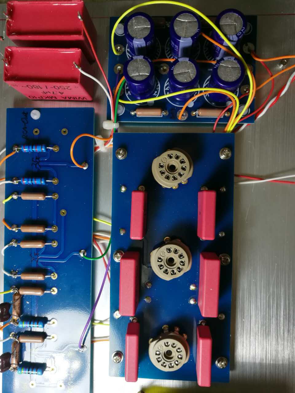

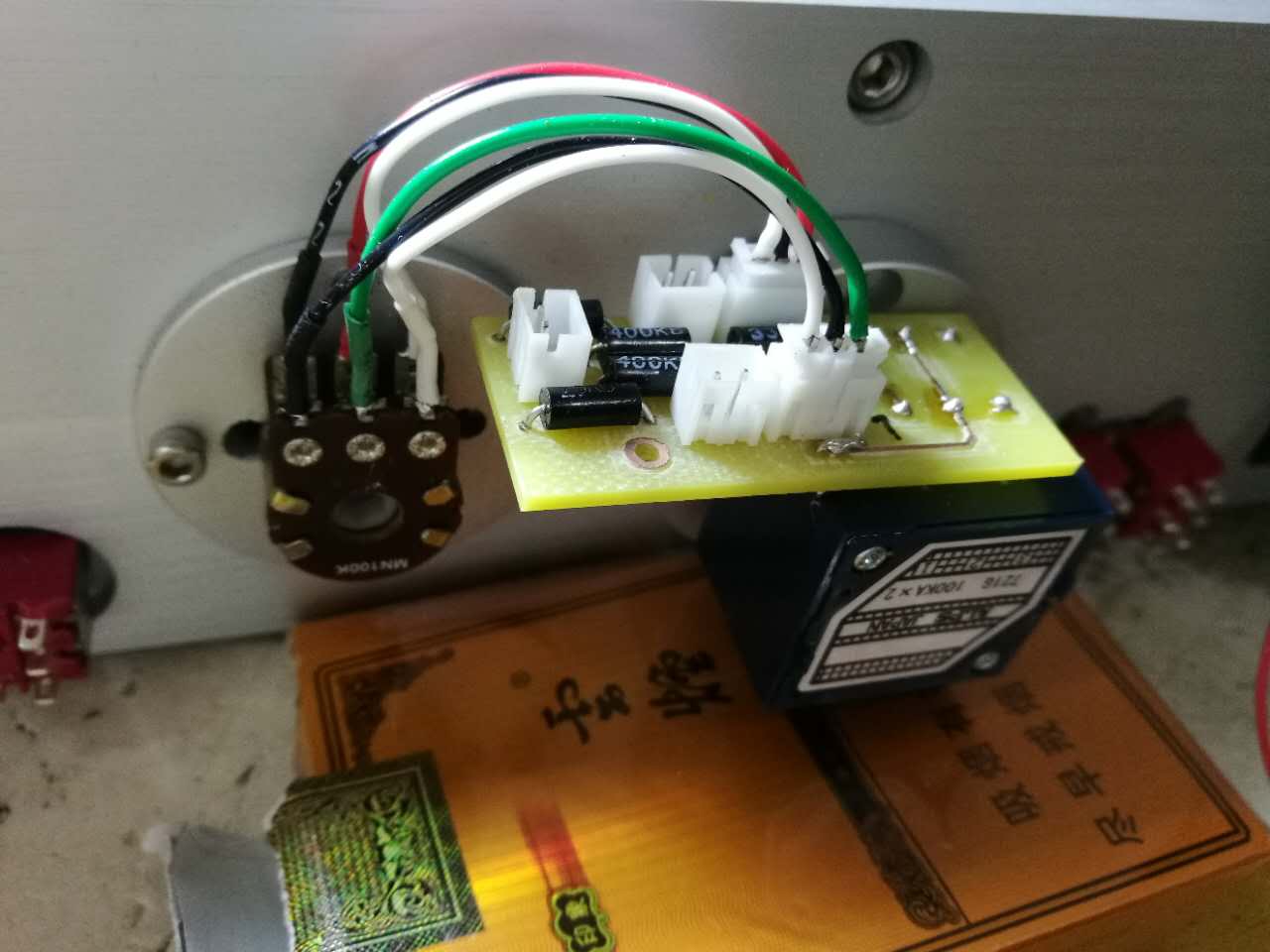

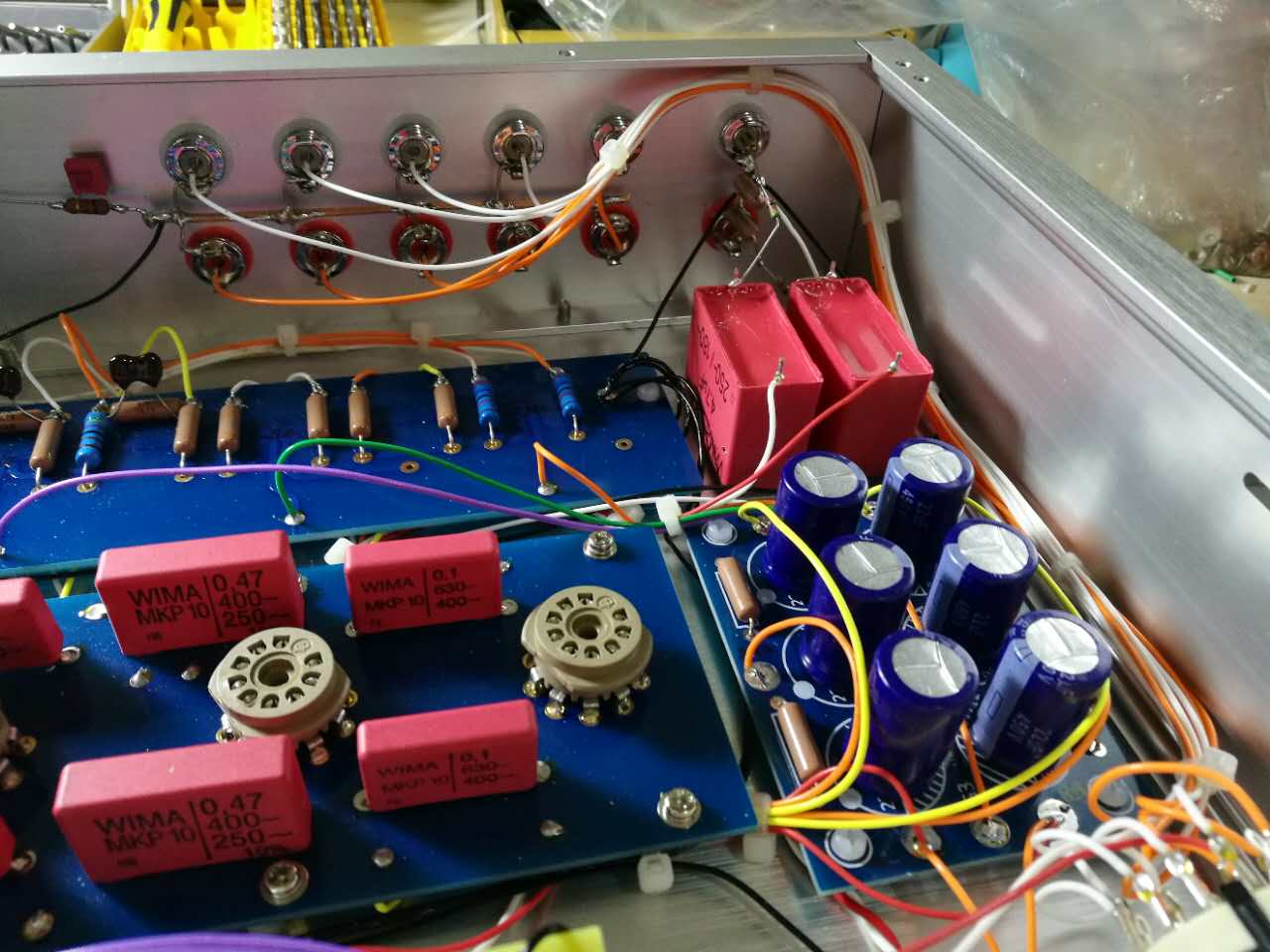

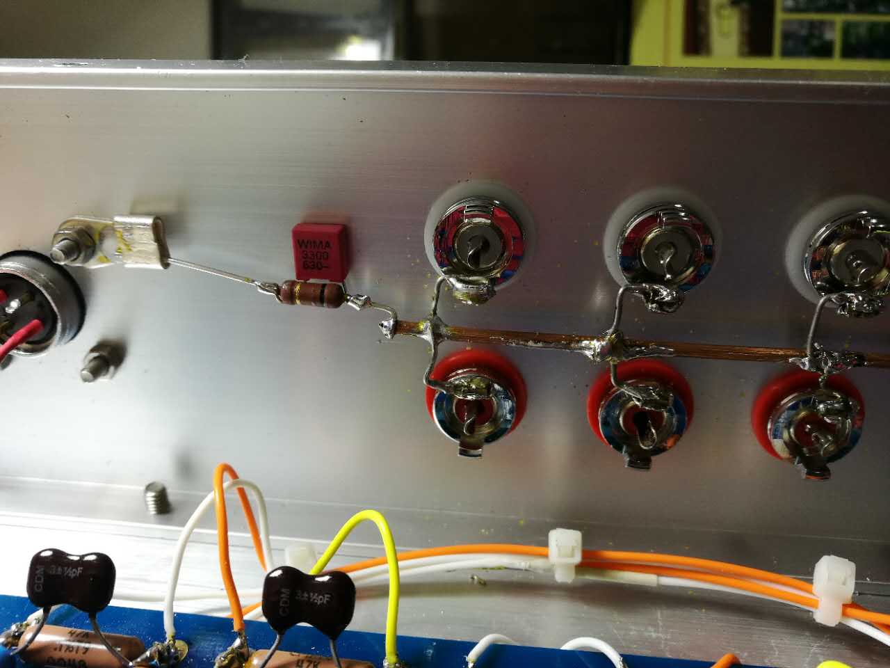

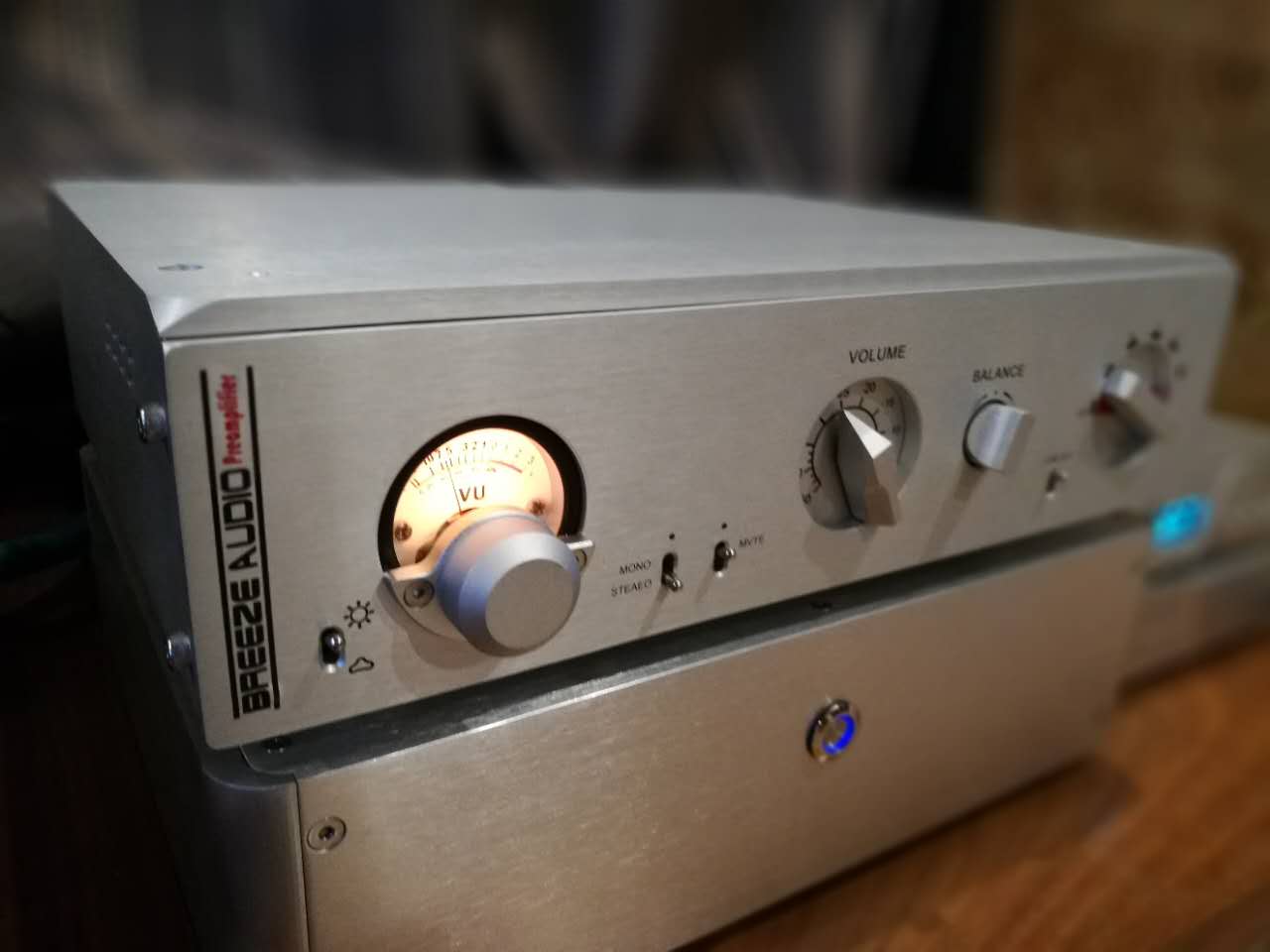

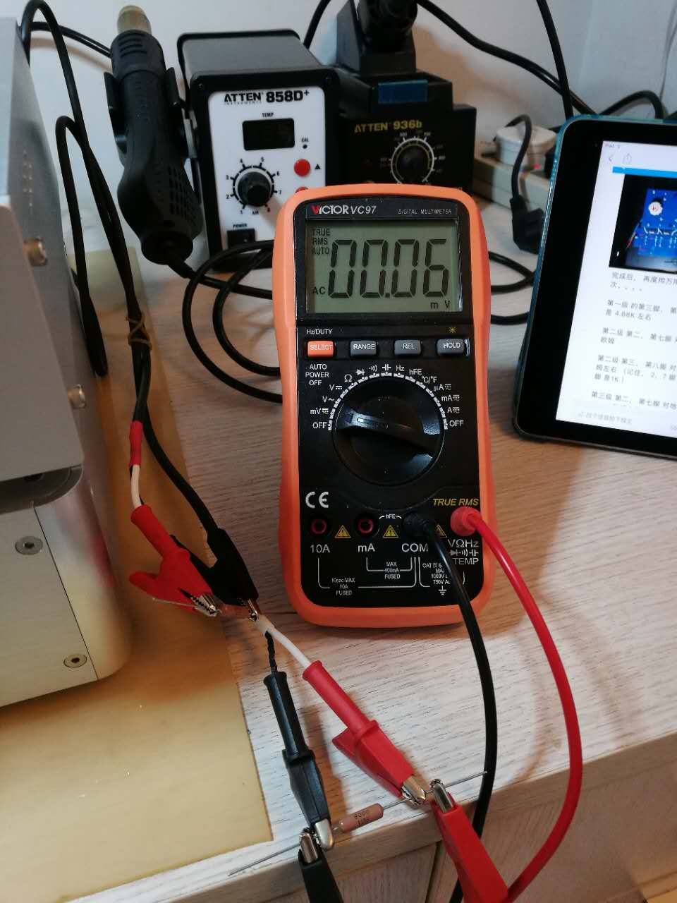

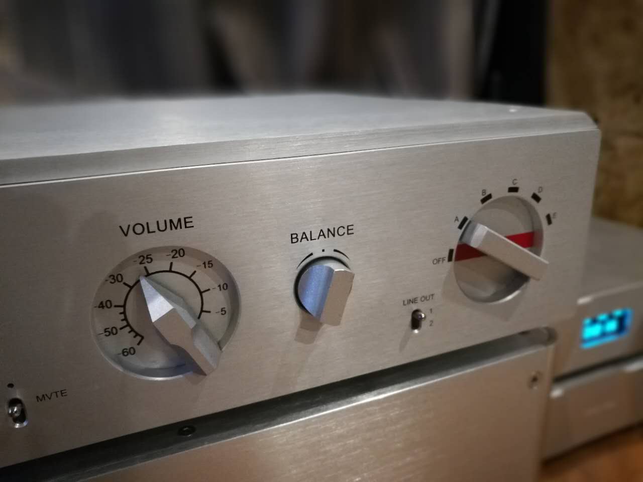

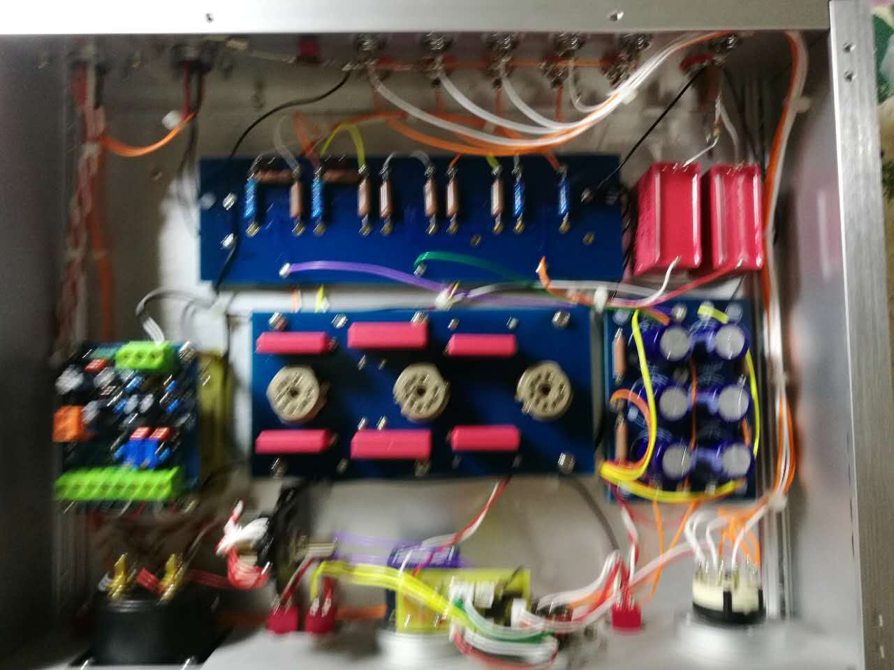

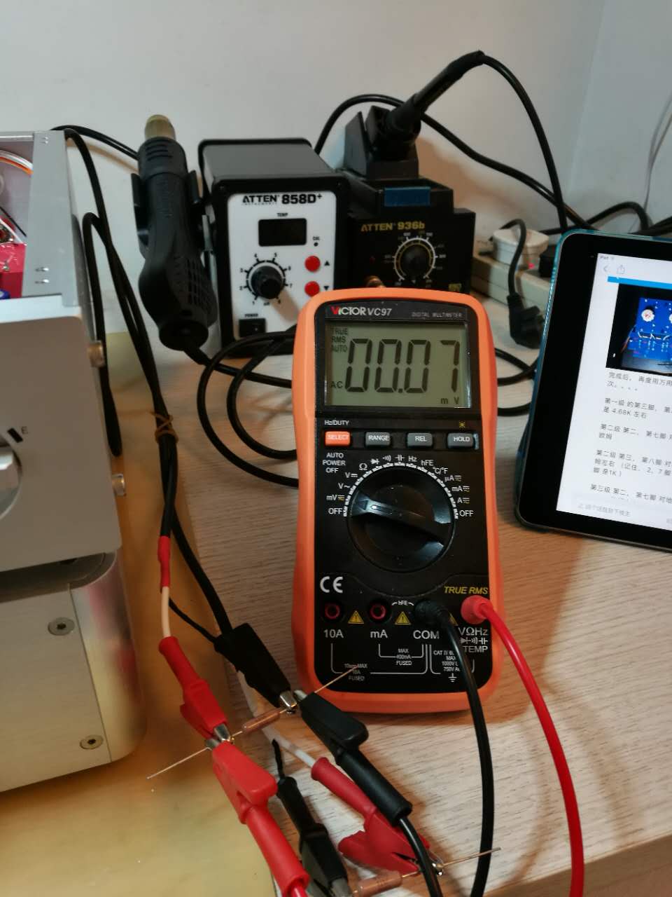

J jerrylong Member Joined 2008 2017-07-19 7:28 pm #41 2017-07-19 7:28 pm #41 The balance and volume control circuit 从我的 iPhone 发送,使用 Tapatalk ••• More options Share J jerrylong Member Joined 2008 2017-07-21 2:52 am #42 2017-07-21 2:52 am #42 Connected each GNDs of refunding coupling PCB to the cathode PCB, I used diffefrent colors for each stage. and connected the GND from input RCA to the case with 100R and 3n3 cap Attachments 50.jpg 110.6 KB · Views: 89 51.jpg 78.6 KB · Views: 94 ••• More options Share J jerrylong Member Joined 2008 2017-07-23 10:31 am #43 2017-07-23 10:31 am #43 The balance pot and volume pot have been connected to this PCB Attachments IMG_0362.JPG 74.4 KB · Views: 99 ••• More options Share J jerrylong Member Joined 2008 2017-07-23 10:34 am #44 2017-07-23 10:34 am #44 The amp case has finished connecting wire, in order to avoid noise the power supply wires going through left and the signal wire going through right Attachments IMG_0363.JPG 120.8 KB · Views: 99 IMG_0365.JPG 98.4 KB · Views: 91 IMG_0364.JPG 98 KB · Views: 106 ••• More options Share J jerrylong Member Joined 2008 2017-07-23 10:37 am #45 2017-07-23 10:37 am #45 Adding a VR for the balance of filament power supply Attachments IMG_0366.JPG 104.7 KB · Views: 99 ••• More options Share J jerrylong Member Joined 2008 2017-07-23 10:39 am #46 2017-07-23 10:39 am #46 This peramp is finished Attachments IMG_0358.JPG 51.9 KB · Views: 145 IMG_0359.JPG 56.9 KB · Views: 139 ••• More options Share J jerrylong Member Joined 2008 2017-07-23 10:43 am #47 2017-07-23 10:43 am #47 The background noise is 0.06mv(left) and 0.07mv(right), quite a good circuit design Attachments IMG_0354.JPG 102.5 KB · Views: 131 IMG_0355.JPG 97.8 KB · Views: 97 ••• More options Share tonescout Member Joined 2020 2021-10-31 5:38 am #48 2021-10-31 5:38 am #48 jerrylong said: This is the case I used for this preamp 从我的 iPad 发送,使用 Tapatalk Click to expand... what a fantastic case, where did you get this from? Thanks, ••• More options Share E euro21 Member Joined 2004 Paid Member 2021-10-31 8:38 am #49 2021-10-31 8:38 am #49 Google: Swiss style luxury with table head precision all aluminum chassis BZ3208A pumpkin DAC front ear chassis ••• More options Share tonescout Member Joined 2020 2021-10-31 7:12 pm #50 2021-10-31 7:12 pm #50 thanks - that's great ••• More options Share Prev 1 2 3 First Prev 3 of 3 Go to page Go Show hidden low quality content You must log in or register to reply here. Share: Facebook Twitter Reddit Pinterest Tumblr WhatsApp Email Share Link Home Amplifiers Tubes / Valves Making M7 Preamp Top Bottom
