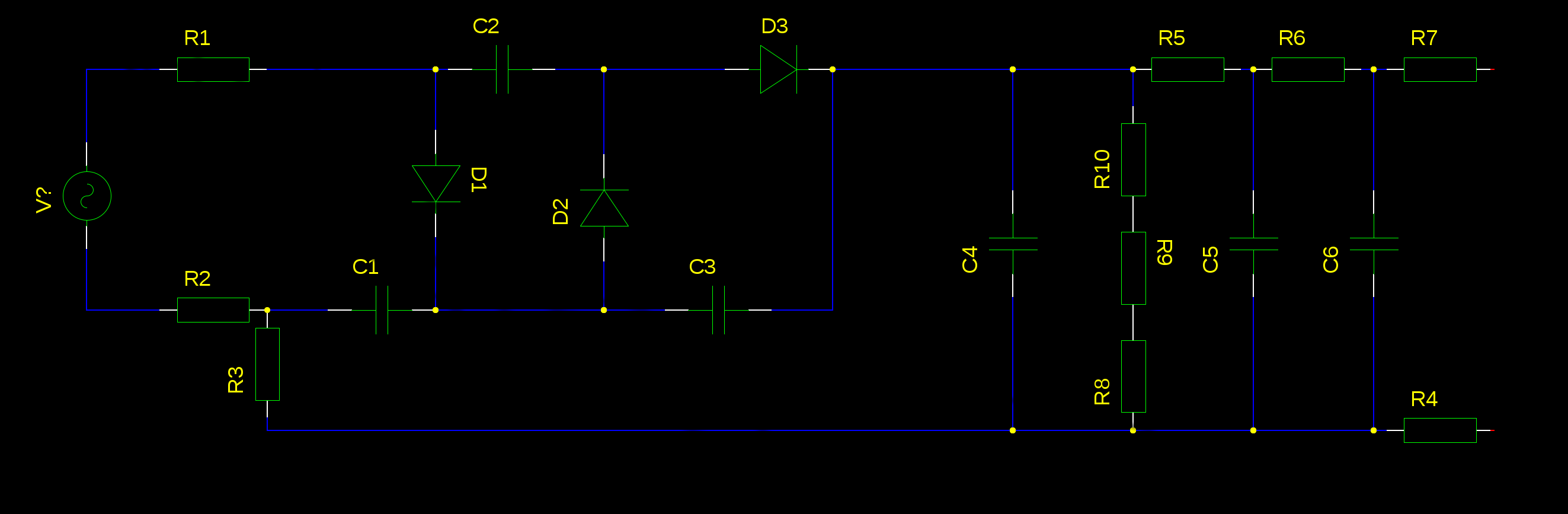

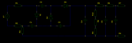

Dear all,
I have not yet gone the perfectionist route and started on direct drive but I am seriously thinking about it now, but since all suitable NPN transistors seem to be going end of life I think the output might have to be a tube/step up transformer or both 🙁
But lets not get distracted from my current mission which is to make my 2 SRD-4 drivers have a charge Bias. In the end these are relatively easy to connect the center tap to a resistor. and that to a terminal block.
At first I was shocked by the SRD-5 from the mid 60's taking the AC direct from the mains. Then I thought about it and wondered if their really is any risk?
Is this circuit safe?
The values are
R1,2,8 = 200K ,
All other resistors 10 M,
All capacitors 0.1uF.
R8 makes a potential divider, which indicates the output is 580V across R8-R10 so I assume on the output also.
The advantage is almost no stray magnetic fields for the power supply, and I don't need to order any transformers.
If the circuit is not safe, and I need to order transformers, I had thought:
Transformer 2,0VA, 230V/6V/220mA, ta40/B, 36,0x28,5x30,0mm, 100g
Transformer 2,0VA, 230V/12V/170mA, ta40/B, 36,0x28,5x30,0mm, 100g
To step the voltage down to 110V, before the voltage multiplier.so allowing more fine control of the voltage.
