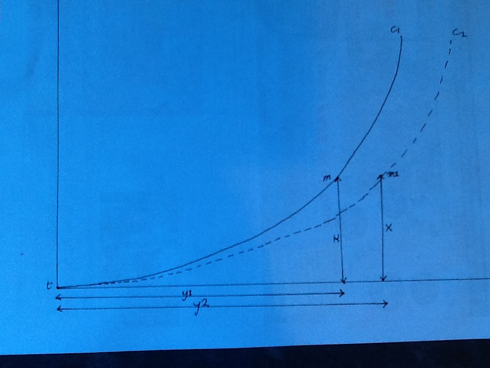

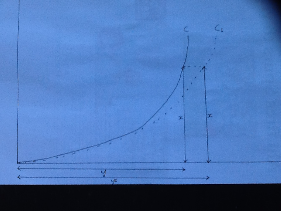

I have found a way to create the curve for the 4 petals: with apologies for the appalling drawing.
The curve "c" is the tractrix required. The curve c1 is the curve for the petal. The measurement x is the same for both. The measurement y2 is the length of the curve from t to m. One could do this by say marking out the curve "c" with panel pins, and following the curve with thread tethered at t.

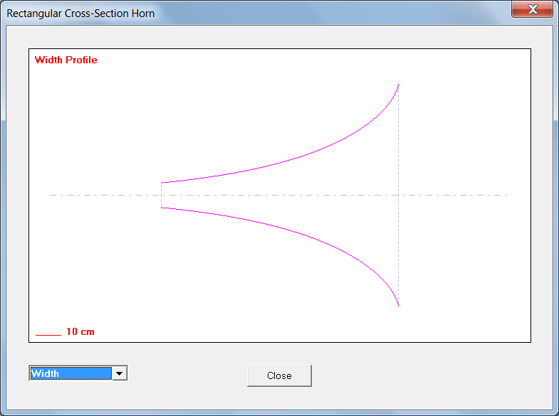

HornResp will allow you to print a horn profile or export the profile data so you can apply the measurements to a large sheet of material. I've made a few, this is the Tractrix profile, expansion on both axis Dayton PC83-8 (3") test results
The only trick is being in "schematic" view then file export, then pick the construction type, then save the file. The profile X-Y data points can be used directly or read by excel and printed if your printer is large enough.

You are making heavy work out of what can be reduced to a very simple exercise using Hornresp 🙂.
Given that the intended mouth size is 3' x 3', what are the proposed throat size (W x H), and tractrix horn length (or horn cutoff frequency)? If you care to post this information I will provide you with the details you are seeking - and you won't even have to learn how to use Hornresp!
Assuming the 3' x 3' mouth is that of a fully-formed (90 degree) tractrix horn, then the cutoff frequency will be 106.12 Hz. If the throat is 2 cm x 2 cm, then the length will be 181.39 cm.
In the attached file, the 'Side Len' values give the x distances along centre-line axis of the side walls, and the 'Width / 2' values give the y distances from the centre-line to the wall edge.

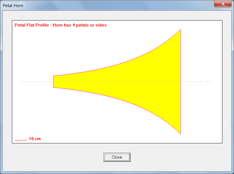

Hi midrange,
The tractrix horn meeting the above specification has a throat area of 103.23 cm^2, a mouth area of 8361.27 cm^2, an axial length of 97.69 cm and a flare cutoff frequency of 106.12 Hz.
Plot 'Side Len' against 'Width /2' to obtain the cutting pattern for one half of a flat uncurved petal. The full flat uncurved petal should look like the one shown in Attachment 1.
Plot 'Length' against 'Inradius' to obtain the profile for the petal supports. The petal support profile (for both the width and height supports) should look like the one shown in Attachment 2.

The throat size is 4" x 4".The mouth size is 3ft x 3ft. A full tractrix is what my friend is seeking (as I interpreted the example spreadsheet you provided).
Do any of the numbers supply the tractrix curve that the four petals construct into. (Just wondering for ease of making supports for the petals).

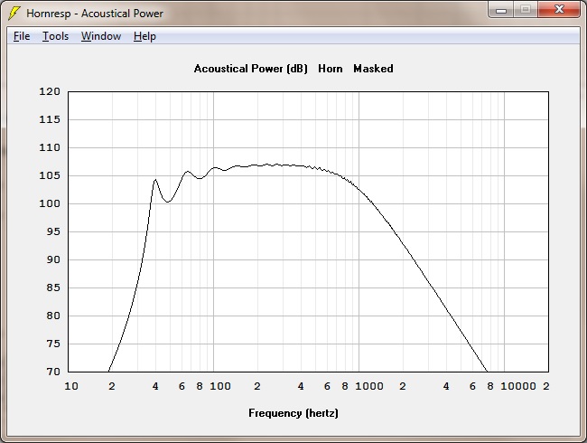

I note that in #27 I was asked for three variables: throat size, mouth size, and horn length, and that horn length would affect the cutoff frequency. So if the horn was longer, the cutoff frequency would be lower, at the expense of ripples in the bass due to the mouth no longer being optimal? Would the ripples begin below where the mouth is too small?
If this is the case it seems that it could be a viable compromise (within limits) in that in a normal living room bass response is fairly non linear anyway.
I've made a few smaller petal horns using hornresp.
If you make the horn longer, with the same mouth and throat area, it will not be fully formed (exit <90deg) but will go lower with ripples (see pic). I don't think the exit angle matters at these low freq but the size (3m long) will surely roll some eyes. I attached a sample graph from hornresp.
There is also the possibility of using more petals (than 4) to get the side width smaller to make to wood easier to bend and easier to dampen.
