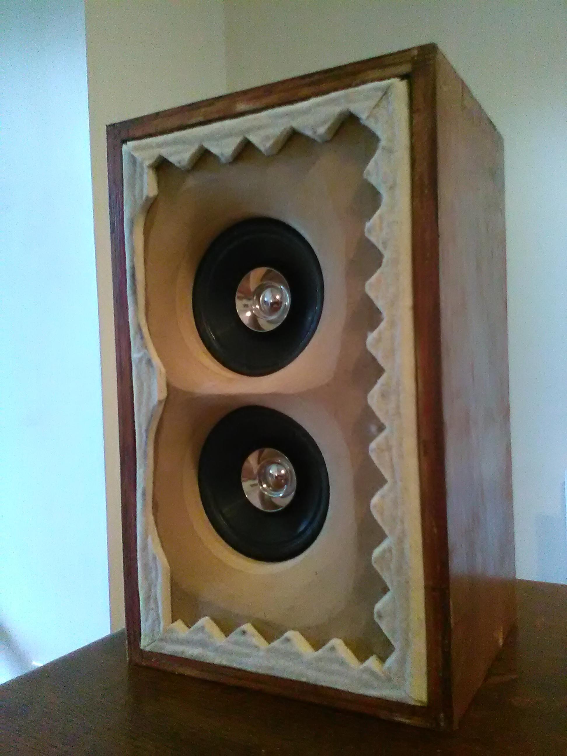

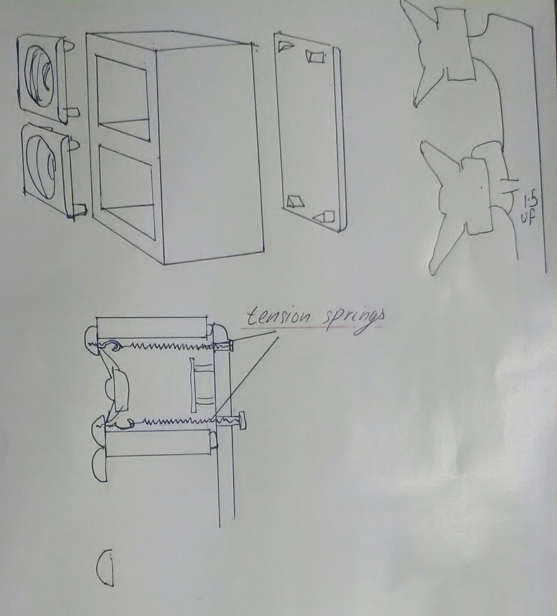

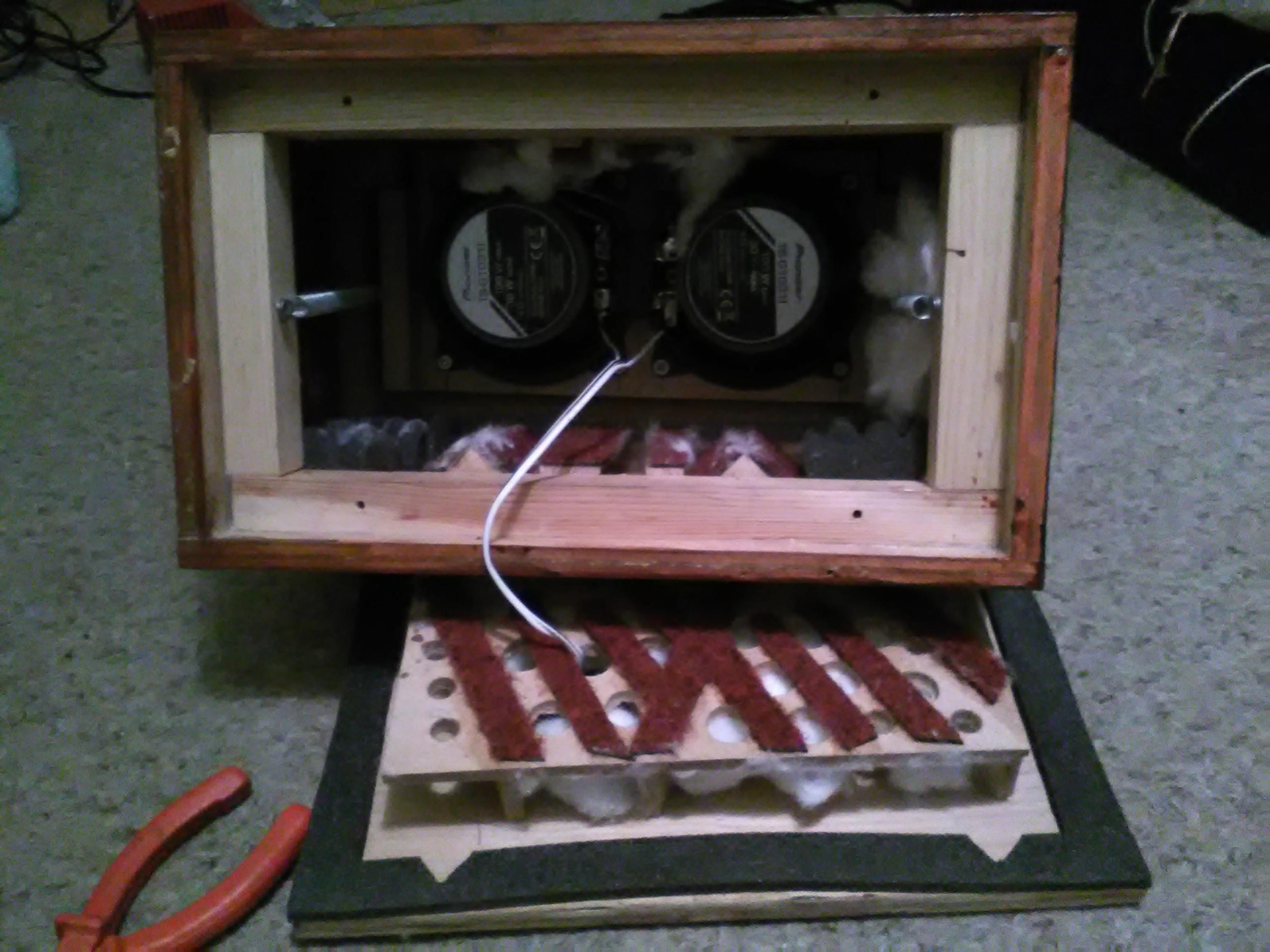

I've made a few speakers where I've used two full range drivers together, wired in series with a 1.5 uf cap in parallel with the lower driver to bias treble in the top driver. I also used a separate front baffle held on with tension springs against a foam gasket. You could use a similar idea with a breeze block, sorry cinder block, using tension springs going all the way through, holding both the front and back panels on. Note that I also use a baffle with holes in it, mounted about an inch from the rear panel to absorb the rear wave from the driver.

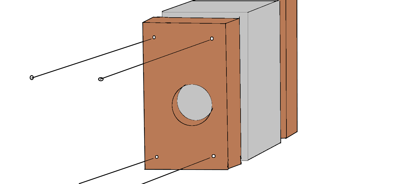

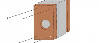

This is a ruff idea of what you'd end up with. This would mean that you would be using the whole of the internal volume for bass, without the need to remove the centre section from the block.

The design uses plates of ply or foamcore or whatever for the front and back. All the cutting / drilling is done in these plates, not in the cement.

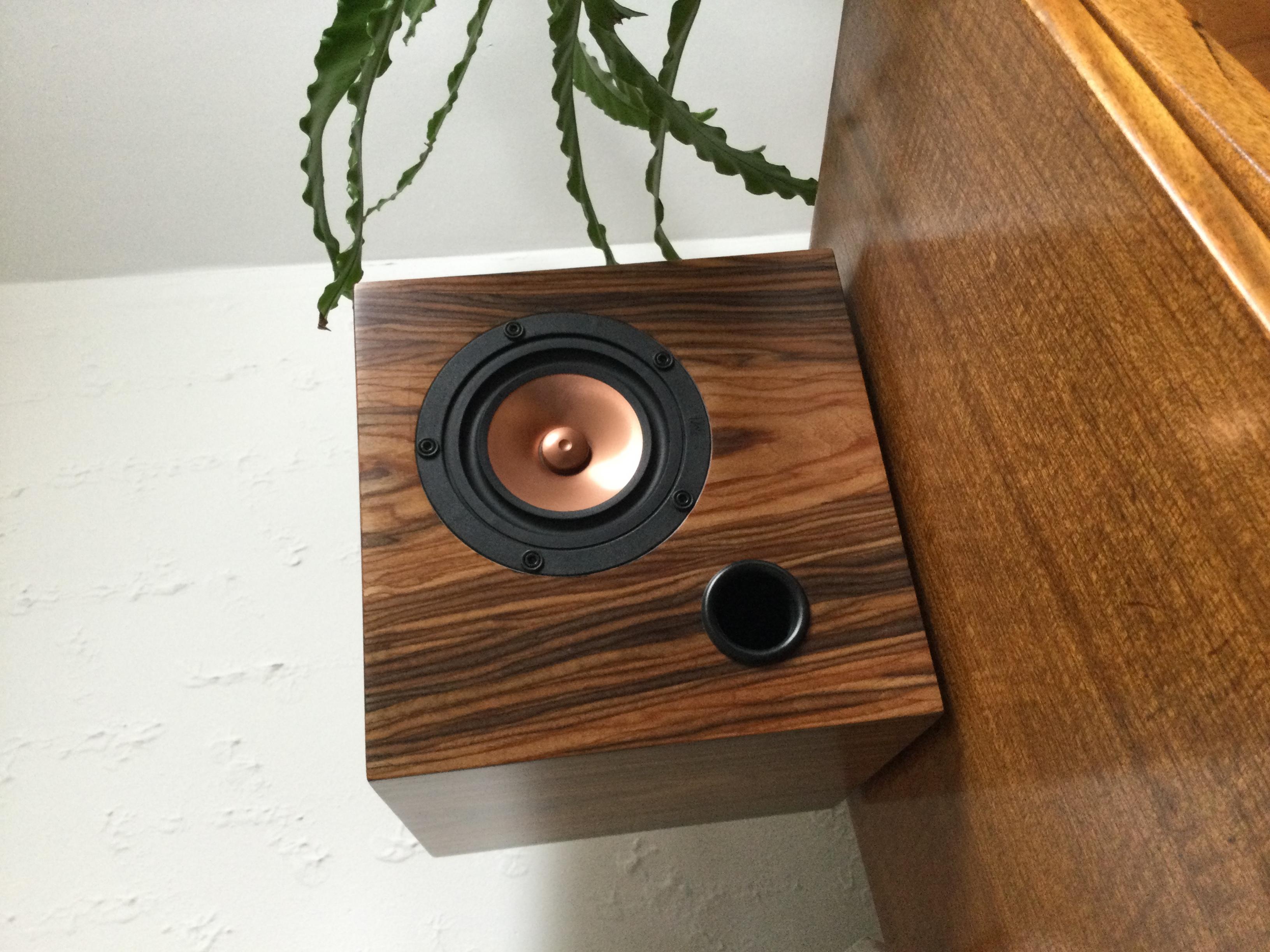

Ikea have several containers which are essentially prebuilt speaker boxes.
I've pictured a build using one of these.
Speaker made with Ikea cutting board + box - Imgur
