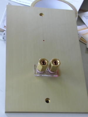

And that's what it's all about. I was finishing front plate for my amp yesterday and quite accidentaly decided to try something new. I polished my plate and then bathed in alodine solution. For everybody who doesn't know what it is I can only say that it's used in aircraft parts making. Before painting each aluminum part is alodined and that is an extra protection against corosion.
As you see on a picture the plate has nice, gold finish. In some applicationes it looks really nice and that color is quite popular now with stereo makers. You can make it darker or lighter, depending on how long you keep the part in alodine solution. It may be cheap alternative to anodizing but there is no choice as to color.
I had some alodine from my previous work but I know that it's a powder mixed with water. Can somebody provide me with the info where can it be obtained from?

It's better to use all those precleaners but it's not really necessary. I have alodined a lot of aircraft parts prior to painting and all it really takes is to put the part in solution for couple of minutes and rinse it after. Of course the part has to be clean, but when you sand it or polish before alodining it's all you need.
I have also seen how the alodine solution was prepared at Bomardier Aerospace. It came as a powder in bags and was mixed with water. And that's what I'm looking for: the alodine powder.

It depends on the finish on aluminum, but fingerprints are less of an issue than with untreated aluminum. They are also easier to clean, because alodine forms sort of a film on the surface and this protects aluminum from corrosion.
Do you know how much they charge for shipping? Usually it's much more as this is a dangerous material and special carrier has to be used. It is much easier and probably cheaper to buy it in powder form and mixe it at home. I found a local place, but its $200 minimum order.
As mentioned above, this is also known as chromate conversion, often referred to as Alochrom here in the UK.
It's not very robust, but will prevent corrosion.
One very important thing to remember is it's electrically conductive, unlike anodizing, so is a better solution where good electrical performance at high frequencies are involved, like RF, for example.
