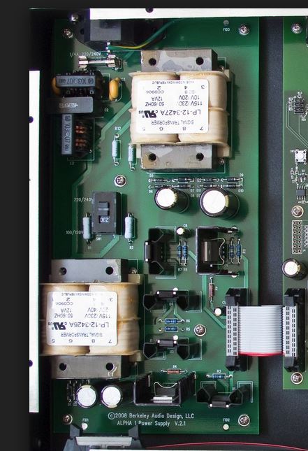

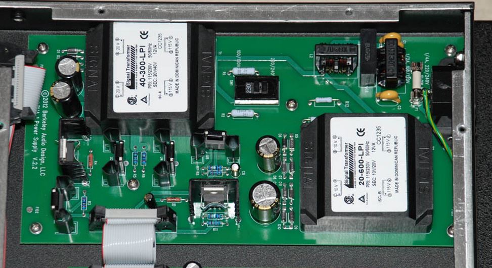

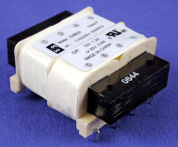

I have bought a transformer from Mouser like the one depicted below and plan to use it in place of the toroidal ...
i would bet that the mains noise will be suppressed much more than with the toroidal.
This is just a part replacement ... and still worthwhile

The more i look at this toroidal the more i hate it.
These are the mains transformers i would like to see instead in the ps.
Regards, gino
Yes i found more efficient, less dispersion of magnetic flux but also less mains noise suppression that is what i am interested in more
Ok .. the magnetic flux from a EI could be a problem if it is too close to the circuit

fit a mains filter.
They are best when INSIDE an all METAL enclosure and that enclose is effectively OUTSIDE the circuit chassis.
The IEC socket with integrated filter meets that brief.
The METAL enclosure of the filter is fitted through a hole in the side of the Chassis. and electrically connected to the chassis all around the perimeter of the hole and the two bolt fixings. The plug fits into the plastic end cap.
The contents of the IEC filter are effectively OUTSIDE the mains Chassis. The interference that is attenuated remains OUTSIDE the main chassis.
Only the unattenuated remains fo the interference get inside the main chassis.
The IEC mains filter is the simplest solution.

Hi and thanks a lot and actually it is what i see more often in a digital units when a toroidal is used.
I will try one i have at hand in the weekend and listen.
I see also some discrete filter upstream the mains transformers using chokes and caps. Very interesting.
I will look at some chokes data sheets ... maybe i will find some application suggestions.
They are very common in serious dacd power supplies.
Thanks again, gino
