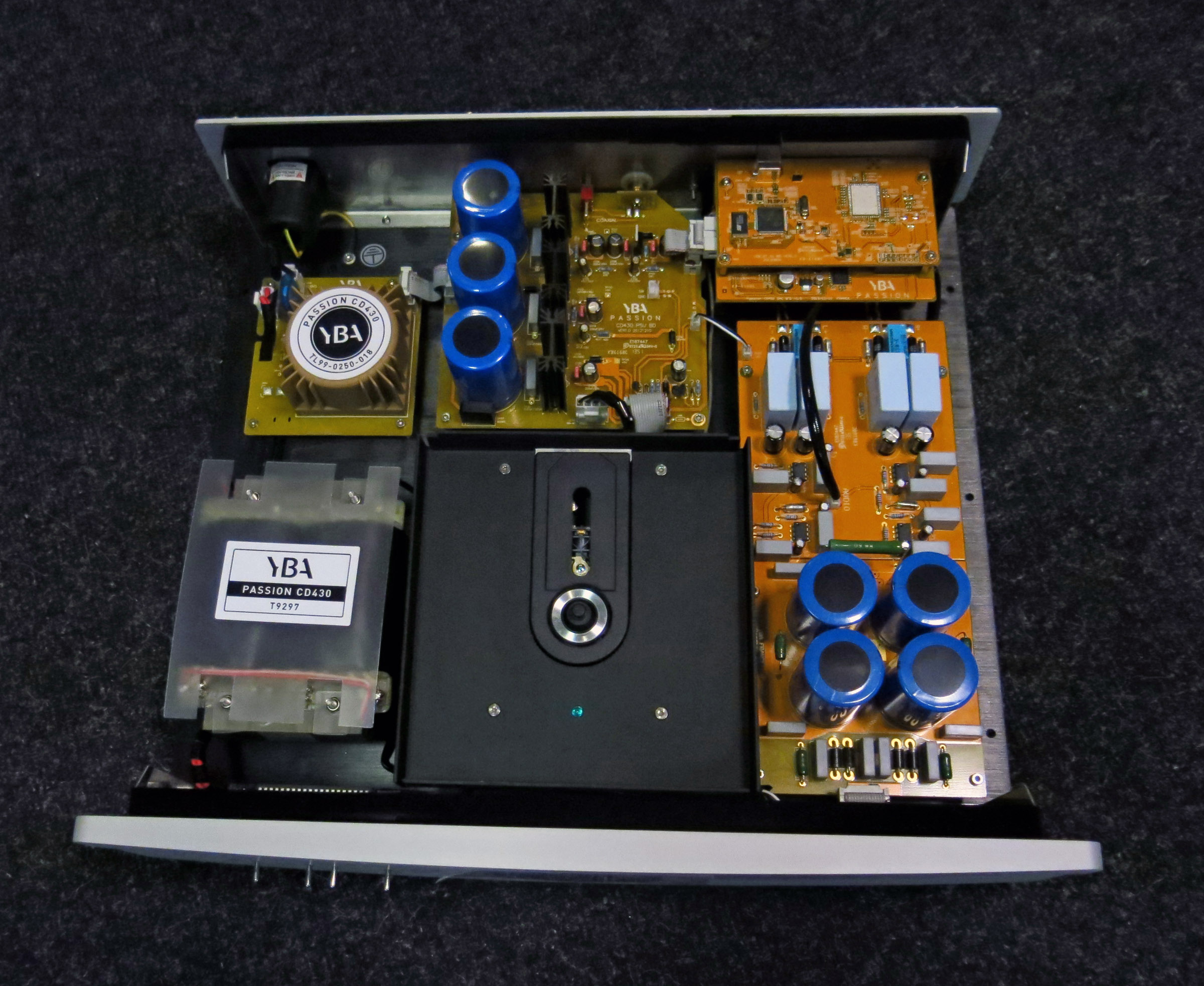

As an example ... look at the power supply of this cd player ... and it sounds pretty good ...
Thanks again, gino

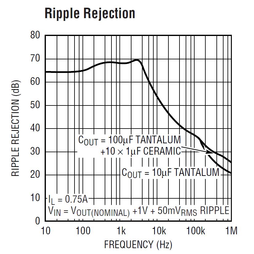

let's say that i hope. In the meantime i have found in the lt1963 datasheet an impressive, in the bad way, graph that i am attaching.
Practically any noise > 100kHz will pass the regulator "almost" not attenuated ?
Is this the evidence of the poor performances of some (or all) regulators at higher Hz ?
i am shocked ...

Noise reduction needs a system-wide perspective, not just looking at individual numbers.
Hi and thanks again for the helpful advice.
But now i know that i cannot expect a great rejection from that regulator of HF noise, assuming that HF noise is detrimental. Is it detrimental ?
However, if i block this HF noise before the regulator ... bam ! the regulator will have not to deal with it.
I am sure that in my device a lot of this HF noise passes through the regulator to the circuit.
Maybe (but i cannot understand this) there are other filters/regulators after the lt1963 that is the 1st and main one.
This i do not know ... but i will try to spot.
For example - what use is a sub-uV power supply module that connects over unshielded wires a distance half a metre away from its load?
That would suggest to me that the whole system hasn't been considered in the quest for noise reduction as all wires are antennas.

Another thing to ponder is the purpose of having a very low noise reg module when the self-noise of the digital electronics its intending to power is potentially two or three orders of magnitude higher than the output noise of said module
I see your point and i agree. But is there any way to attenuate this self-noise ? in a negative case we can only provide them the cleanest power possible .. put them in the best conditions to work, without exaggeration.
Maybe this self-noise is related also to the supply noise ?
I have bought a kit based on this lt1963 ... to put upstream the existing one.
The stated performance at 100kHz are quite good ... so i guess they have used some kind of additional filtering around the regulator.
As soon as i receive it i could post some picture to understand the circuit.
And maybe to modify it for better performance ?
Thanks a lot again, gino

Hi and thanks again.
I see this a much higher level type of intervention.
If i understand well this unit has a gross main supply feeding a 1st main regulator.
After that (but i have to see if parts are marked) other local regulators on the pcb.
It could be that this is not the best approach. Maybe providing separate supply to each section would provide better results.
But this is much more complicated.
I would need of course a scope to see the noise at least after the lt1963, and see if any mods upstream/downstream can change this noise.
Sometimes even a small film cap strategically placed can be beneficial ?
Nothing that can be said without looking in the scope. I guess.
One question ... with a scope it is possible to see the noise at the lt1963 output ?
that would be a very good basis to see the improvement of mods before it i think ...
