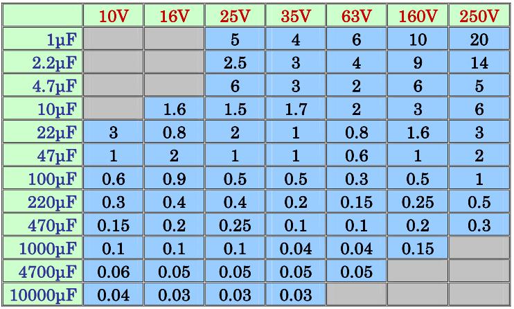

There are charts with Vloss what is accepted and what is not I posted bellow
I think we really need to know what "Vloss" is before accepting or rejecting any value. I want to know why those charts say that at 16V, substantially more is acceptable for 47µF than either 22 or 100µF....There are charts with Vloss what is accepted and what is not I posted bellow
I don't. It'll just be more food for the troll, I guarantee itI think we really need to know
What are you talking about? "VLoss" or ESR? Those charts are talking about ESR.
First one is from a Russian site: ESR метр своими руками — измеритель емкости конденсаторов. Схема и описание | joyta.ru and talks about "The table below shows the average ESR values (in milliammas) for new capacitors of different capacities, depending on the voltage to which they are calculated.".
The second appears to be from a random post on EEVBLOG (ESR Values for Electrolytic Caps - Page 1) that is again talking about ESR. (The table itself is very similar to those on sales pitches for ESR meters on Aliexpress and the like, all depicting the ESR value (not "VLoss"). Besides, with no legend on that table as to what the unit of measurement is being depicted, the table is pretty meaningless anyway.
