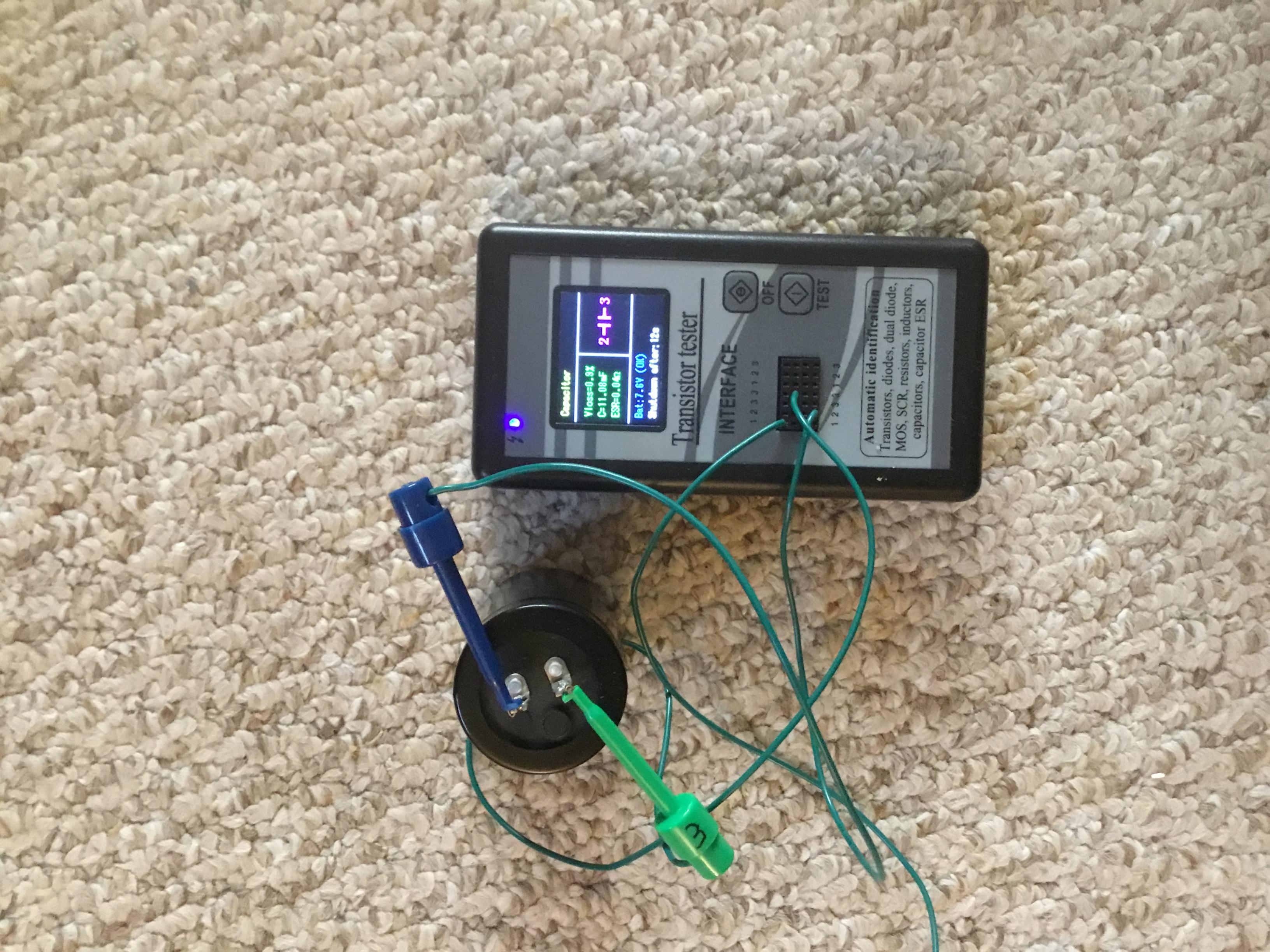

how did you measure the voltage loss? I have one of those $10 mega328 LCR testers that gives a V-loss measurement but I never really paid any attention to it. I just tested a 25 year old 10000uf/63v psi capacitor I pulled from an old Exposure integrated amp and I got the results shown in the pic. I’m assuming the OP has a similar tester and that is what he is talking about when he says Voltage loss.
I was curious so I tested a brand new 470uf/35V Panasonic FC and a 47uf/25V Elna Silmic2. The cheap tester showed a VLoss of 1.1% and .9%. I would take the Vloss reading from these Mega328 testers with a grain of salt.
