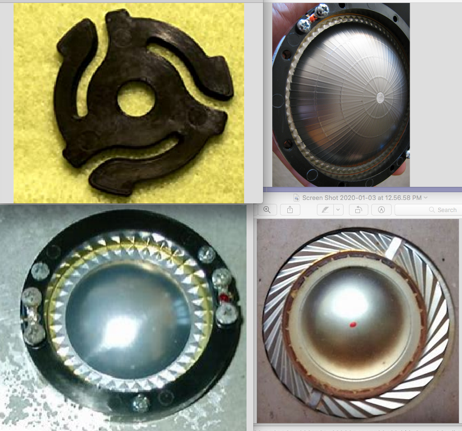

Compression drivers have used a variety of "precision metal spring" surrounds for as long as metal diaphragms have been used, though excursion for those drivers is generally less than +/-.5mm, a tiny fraction of the excursion expected of a low frequency driver.On drivers, "spring" is a horrible joke since "the spring" is a hunk of rubber, accordion paper, and/or starched or treated fabric. Stupid springs, eh. Phenolic spiders were used originally.
Why don't we have precision metal springs in speakers?
I have seen examples of woofers using a metal spring spider that looked something like a 45 record adapter (example below) though can't remember the manufacturer.
Metal spiders and surrounds likely have not caught on in high excursion use for a variety of reasons- weight, tooling cost, metal fatigue, and comparatively less vibration damping than the usual materials are the first that come to mind.

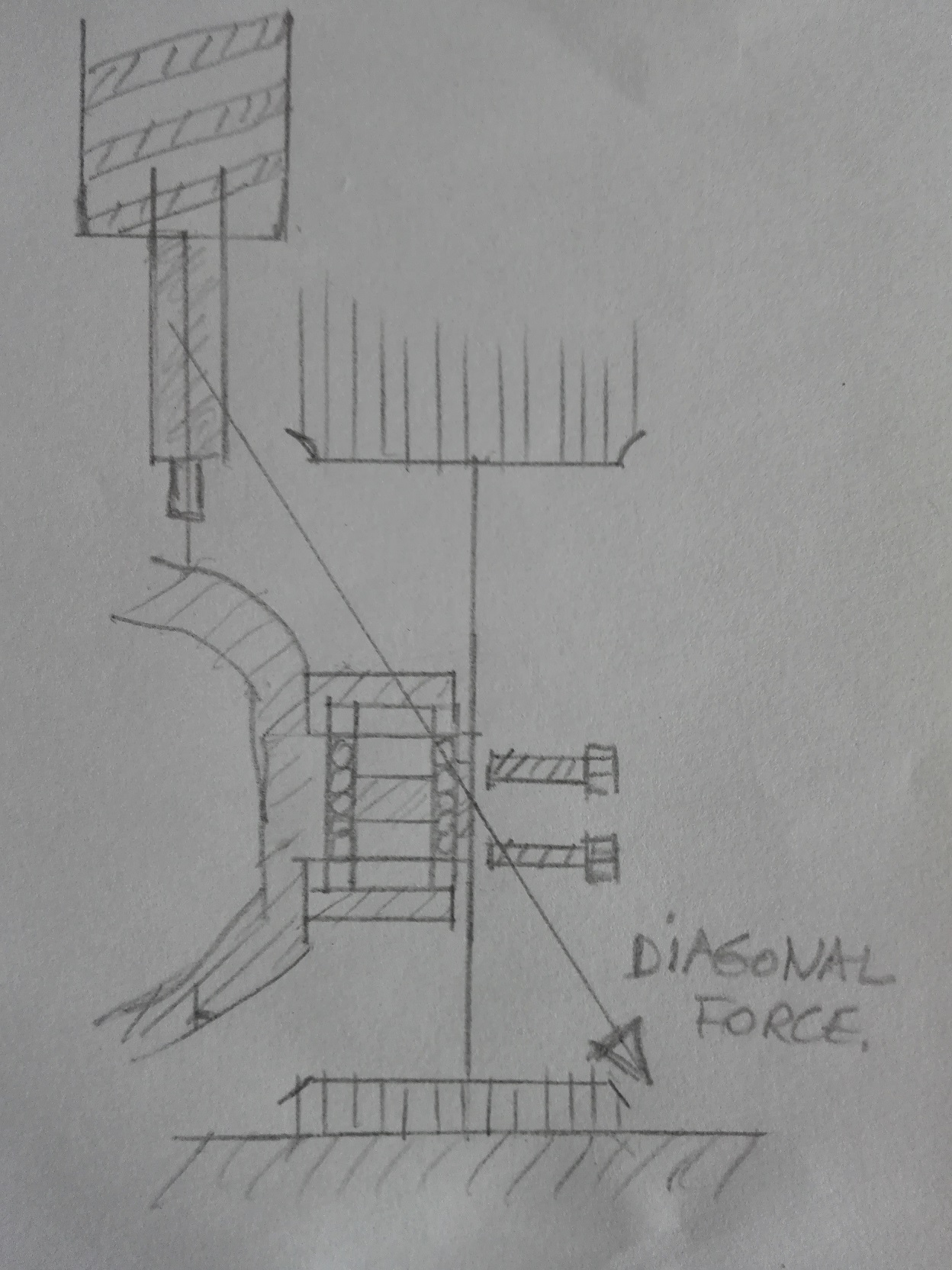

How when wider wheels are placed, so that they have a greater surface of support against the ground and in turn greater distance between wheels in a transverse direction.
Consequence of this? the angle of support of the wheel is modified, and then the load forces act diagonally on the rule instead of horizontally.
The result is obvious, the bearings are broken and you have to change them repeatedly (not easy task) or reuse the original tires.
Sketch in next post.

.............................Consequence of this? the angle of support of the wheel is modified, and then the load forces act diagonally on the ruleman instead of horizontally.
They should read "vertival force" instead of "horizontal force"
I hope you understand the idea .....😉
The rules of the ruleman are damaged because the balls work forced sideways!
Well, the drawing is not very neat, I know ... but what matters is the intention, I guess ! 😀

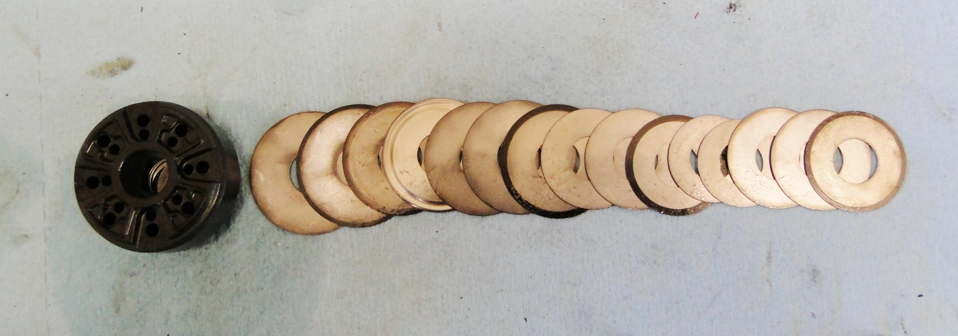

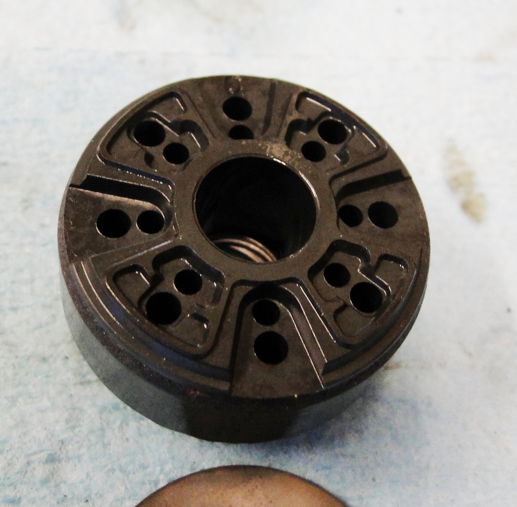

See attached photos. These are of the piston assembly in a standard road car damper. The piston has a series of holes drilled in it. The metal discs are shims which are stacked up and cover half the holes on each side of the piston. The piston is on the end of a shaft which is fixed to the chassis of the car. The piston rides in a cylinder which is attached to the suspension. The cylinder is filled with oil on both sides of the piston.
When the suspension in the car or chassis moves up and down the oil has to flow through the holes in the piston to get to the other side. To do this, in each direction it must bend the stack of discs to uncover half of the holes. The higher viscosity the oil, the smaller the holes or the thicker the shim stack, the greater the damping forces. In a damper with ferrofluid instead of standard oil, there is a coil of wire used to put the ferrofluid in a magnetic field. By varying the strength of the magnetic field, the viscosity of the fluid is changed and therefore the damping forces.
With respect to wheel widths on road cars. When the suspension is designed, the wheel is optimized for a particular offset. This is the distance from the geometric center of the wheel to the mounting plane machined into it. This offset is designed to minimize the torque or overturning moment on the wheel bearing pair. This is close to the diagonal force line in your sketch.
When installing wider wheels on the car, if you keep the offset of the wheel the same, the overturning moment on the bearing pair isn't increased. However, if you use the increased available grip from the wider wheel and/or tire, the magnitude of the vertical force is increased, so the bearing can wear out faster. From the outside of the car, it is impossible to determine if the wheel has the stock offset or it has been changed.
