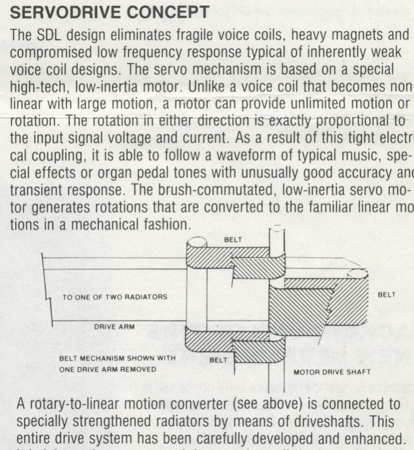

Linear induction motors should result in a long stroke woofer, without having most of the energized coil outside of the magnet gap. I guess nobody makes them, because wasting power in a coil outside of the magnet gap is not expensive.
The closest thing is the servo sub by Danley.
Interesting. Is there an application for a long, long stroke driver with a very small surface? Does that make nice waves like a Rice-Kellogg driver?Linear induction motors should result in a long stroke woofer..
Wasn't the Danley thing was meant to create super-low audio (or sub-audio)?
B.
Danley's "servo drive" subs were made in a variety of formats for PA and home use, the "Contra Bass" had a -3dB response of 15 to 125 Hz, 114 dB at 16Hz at 1 meter, quite impressive for it's size (around 8.5 cubic feet) back around 1987.Wasn't the Danley thing was meant to create super-low audio (or sub-audio)?
That technology was the basically the inverse of a linear induction motor, the "servo drive" used a brush-commutated, low-inertia servo motor coupled with belts and drive arms to convert it's rotary shaft output to the linear "in and out" motion of typical loudspeakers.
The servo-motor concept is cumbersome even it is one route to tremendous and very low emanations. Even if you can buy servo-motors with excellent linearity, still all the moving parts might make it worse than the Rice-Kellogg yo-yo system in current use.

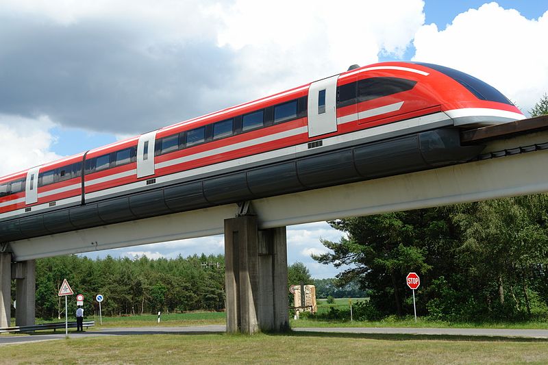

For a moment I thought I discovered the philosopher's stone, but no, the magnetic levitation trains do not use ferro fluid ....
I am intrigued because of this, perhaps it would escape from the magnetic space because the high travel speeds of the train are much higher than those of a VC within its magnetic space?
How I miss some controversies, hey , "just a boy" really knew !
...because the high travel speeds of the train are much higher than those of a VC within its magnetic space?
I think your math is misleading. Try 100 Hz and 1 cm for a loud sub.
I worked on mag lev trains in the 70s. Nice to see them appearing now.
