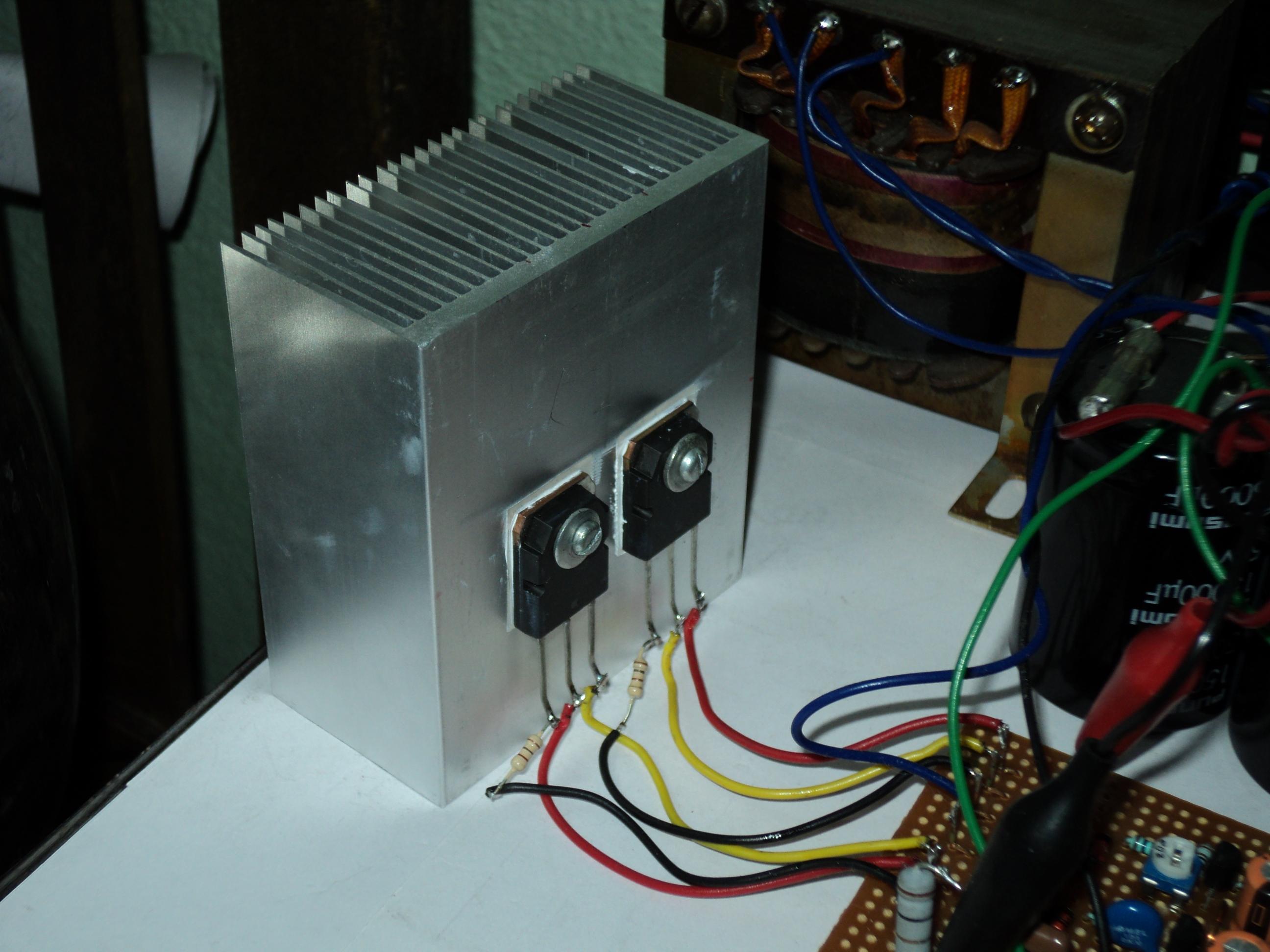

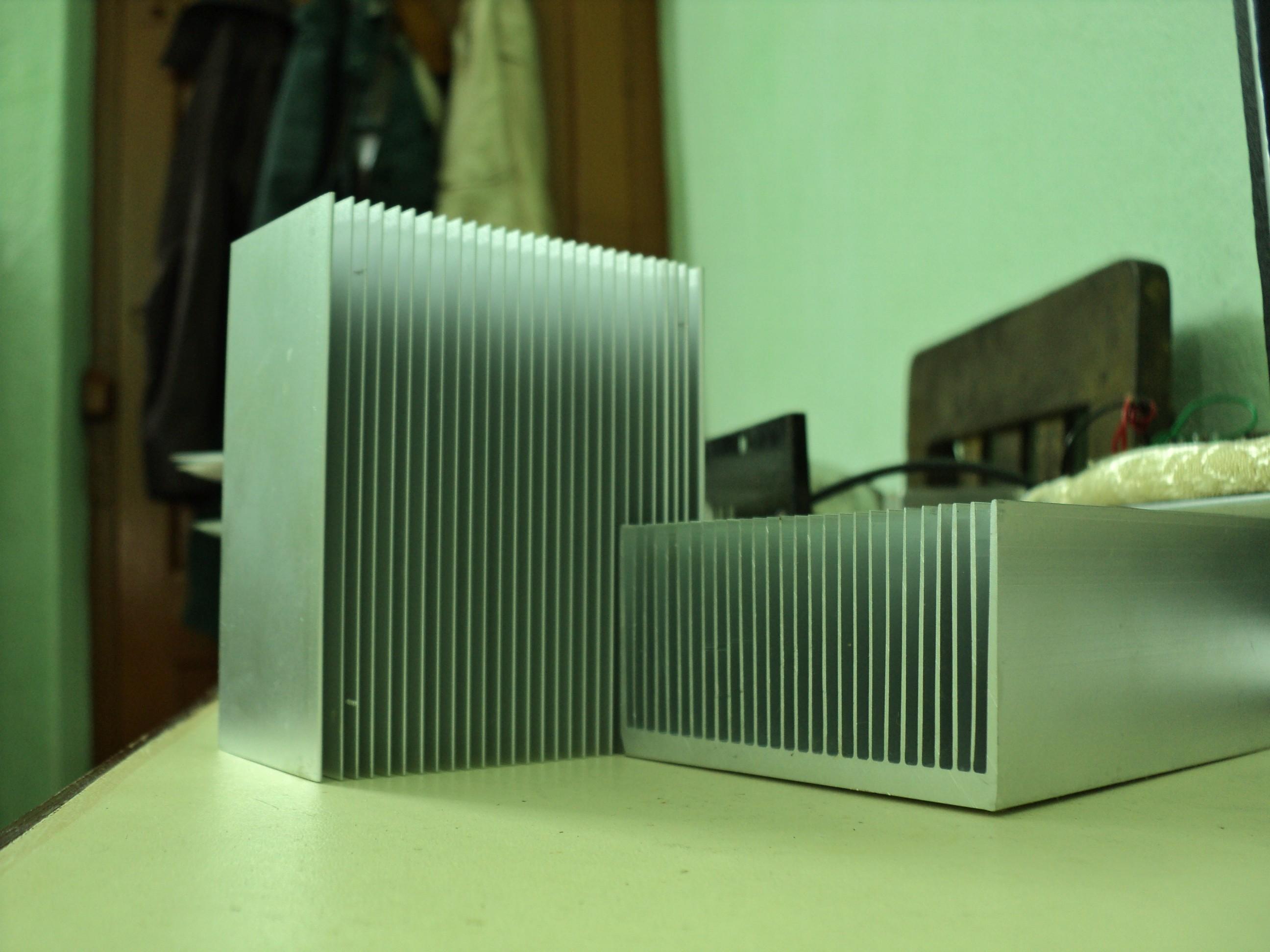

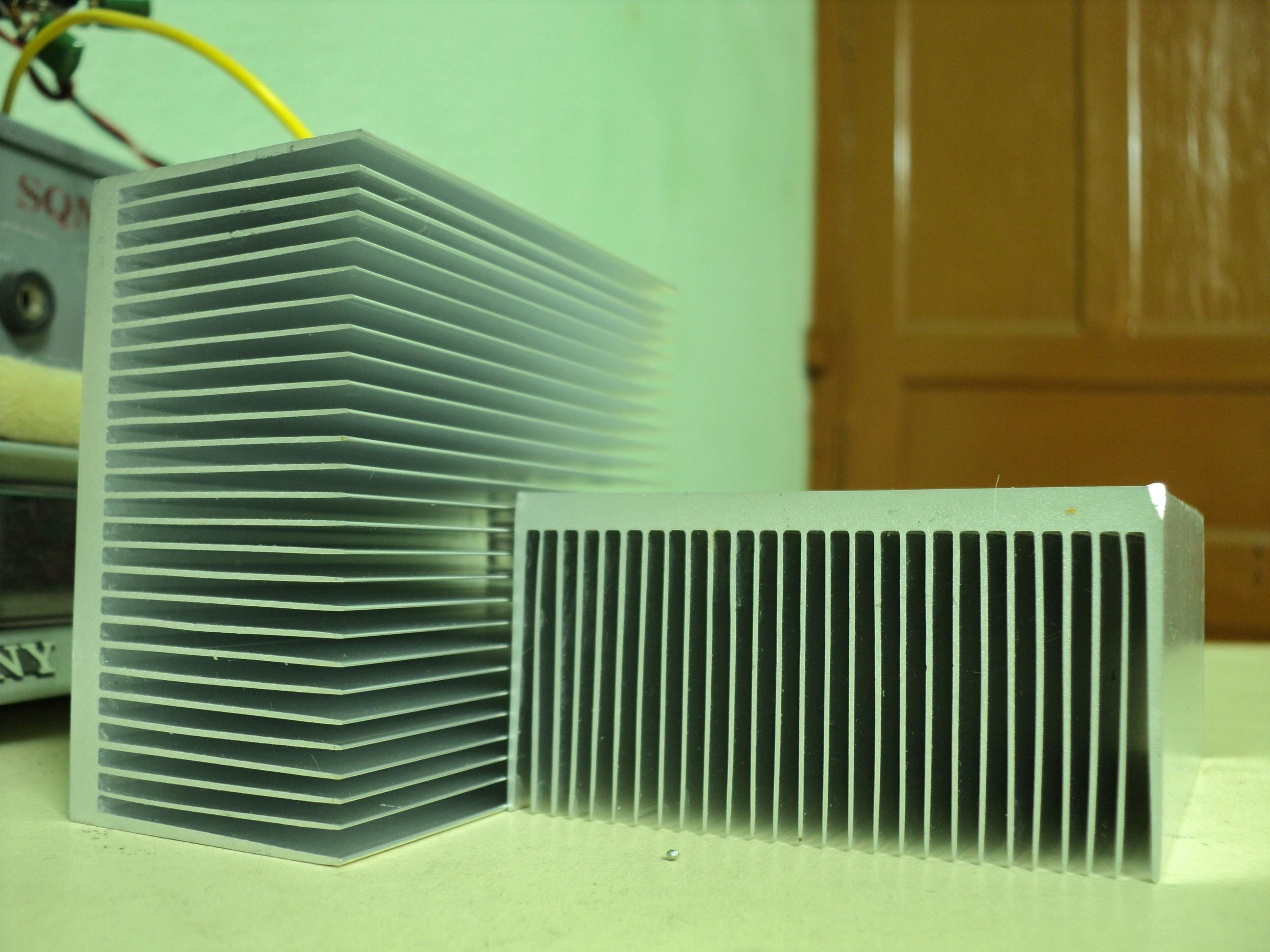

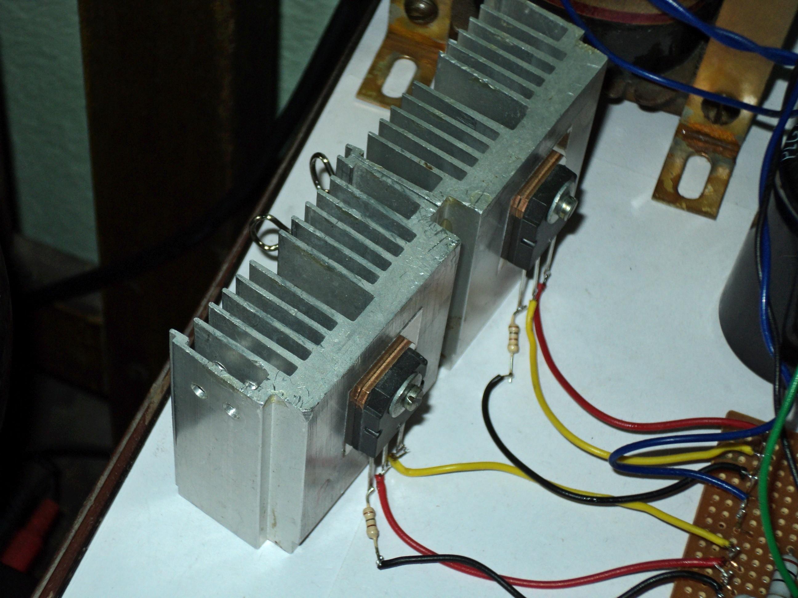

Since I have decided to put these two amps in my soon-to-be-born music system, I am feeling very excited. And although currently bias is limited to ~90mA per channel, I plan to run them at a bias of ~250mA, which the FETs are probably not ready for with the current pentium-iii heatsinks.
I have tested the p3 heatsinks with high bias. They get angry very quickly and demand airflow with 250mA of bias(it's the magic of summer). So I am making an upgrade... and also presenting the FETs a nice and beautiful gift.
P4 heatsinks.
Larger and cooler.
LOL I have bought 2 of them. Plan to recruit one for each FET. So gonna buy two more soon, may be tomorrow.

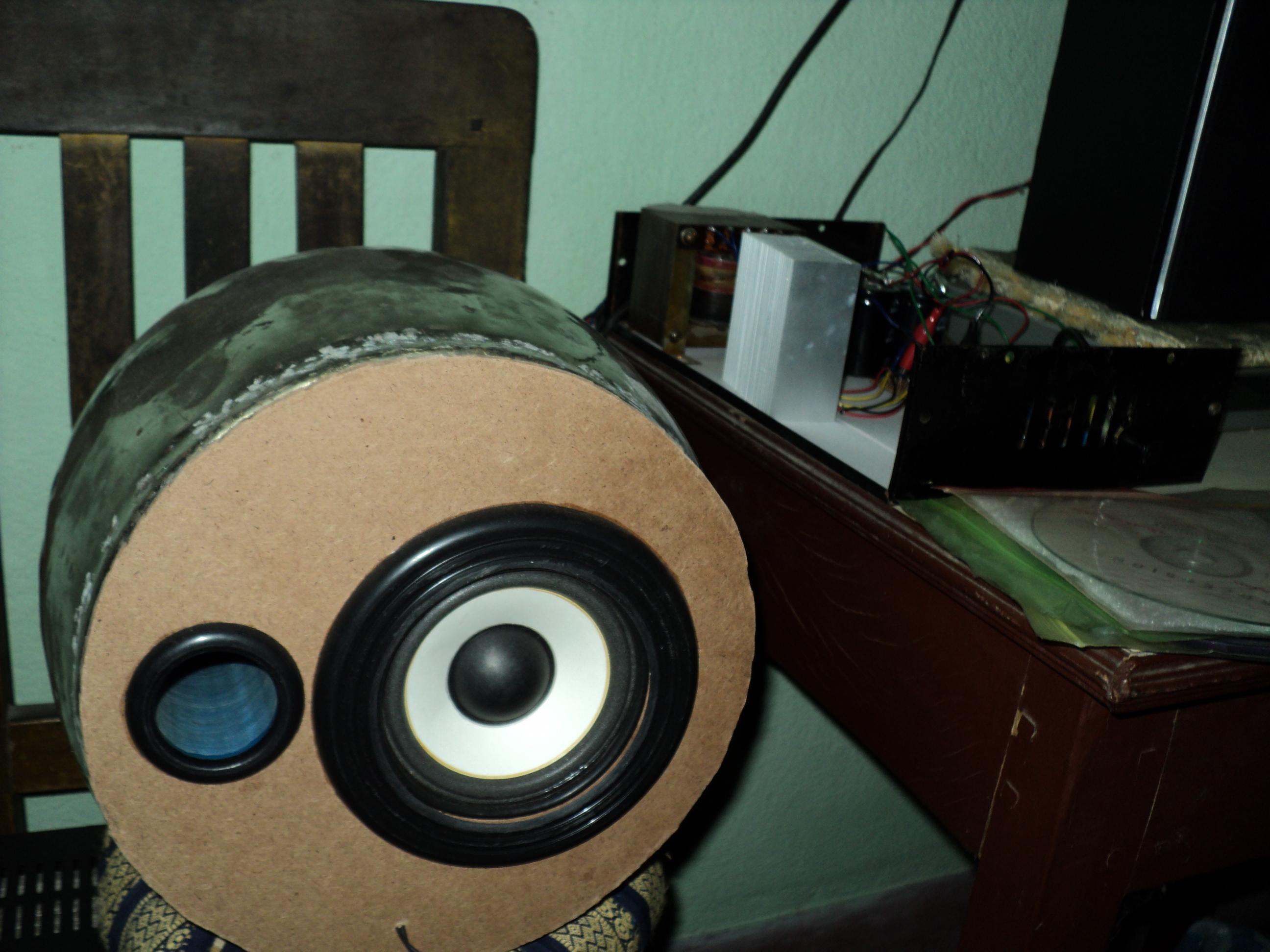

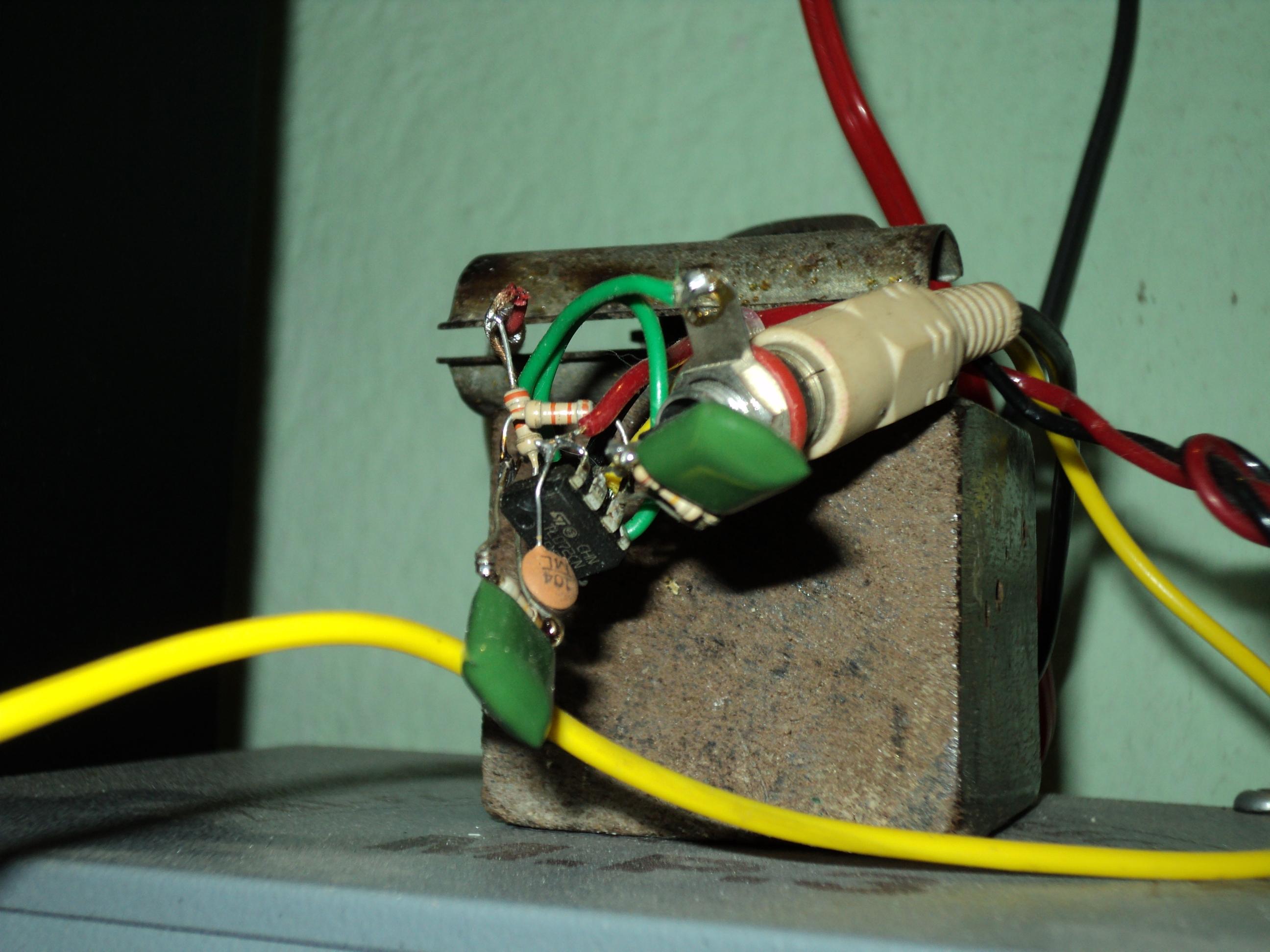

Bass testing the amplifier on my "Specially Made Metal Back" round-shaped subwoofer of 4ohm impedance. Signal is filtered with the ELF subwoofer processor from ESP, a hanging, naked and highly portable version of it. 😀 Shown in third attachment. The subwoofer was run with the high-ish 2.2ohm Zout of the amp.
The result is excellent. Tight and deeeeeep bass notes are produced very well, I expected the sub to act funny with the high Zout but it surprised me. Note that the sub has no damping installed inside. Still the sound was definitely better than P3A's output with low impedance. Probably because the rise of impedance of the voice coil at resonance causes the amp to deliver more power to it. It's just an illusion then...
Although I am going to use the amps for mid+high only, I am now convinced that it can take the place of my sub-amp too... maybe with a bit increased supply voltage.
I expected the zeners to produce artifacts into the 4ohm load in medium volume because of the higher current need at lower load, but clipping occured at much higher volume than I expected. Either the zeners are dead or my sub is very efficient! 😀 😎

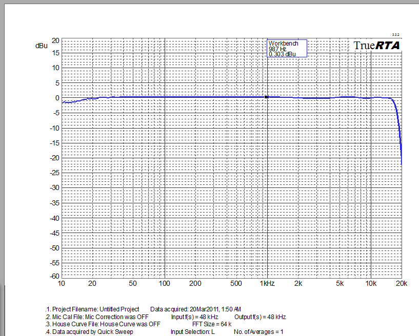

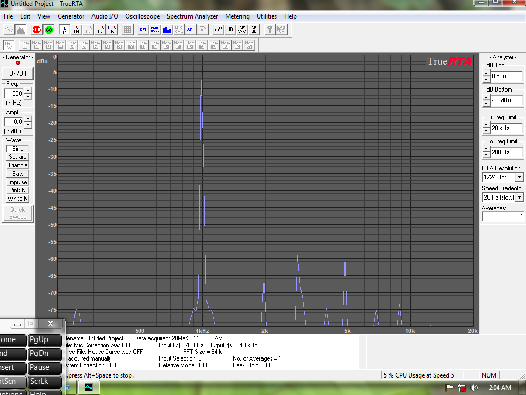

Some Basic Measurements.
The distortion spectra is of 1kHz sine-wave at 20V P-P output on 5ohm resistive load. If I am not wrong then THD seems to be around 0.001%. Negligible amount of even harmonics and a tiny bit of odds. As with all PP amps, odds are dominant.
There is also a sweep test. Looking at the graph I can say that this amp has a large power bandwidth. Although the graph starts falling after 16kHz or so, I think the limited response of the awful onboard soundcard is responsible for this. Because the crystal-clear highs that the amp produces through the speaker gives hint to a totally different dimension which can NEVER be limited to 16kHz, as my ear and listening experience suggests.
However, the basic tests were a success and I had a lot of fun.
