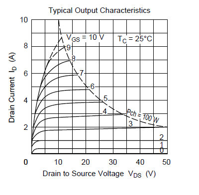

If you look at the datasheet for 2SJ162 you see that there are internal gate to source diodes. These are for ESD protection of the gate to source junction, since more than 15V between gate and source pins will shoot through the oxide layer and destroy the device. However, a smaller voltage gate to source zener would limit Id by limiting Vgs. for 2.5A, limit Vgs to 4V or so. On the issue of gate stopper and crossover, a gate low pass or Zobel filter right at the device gate pin to GND will allow the use of smaller gate stopper resistor. It is common to use different values for N-ch and P-ch. They are not identically oposite.

I better try it myself than waste any more time explaining my question! For the time being I am using a 3V3 zener and a 1N4007 in series. So Vgs would be max 3V9 or so.
Now I need to figure out Id at Vgs 3V9 by testing.

Looking at the graph below I think my default choice of a 3V3 zener + 1N4007 limits Id to ~2.75 Amperes with 20V of Vds.
Am I wrong? If I am then please correct me.
Thanks.

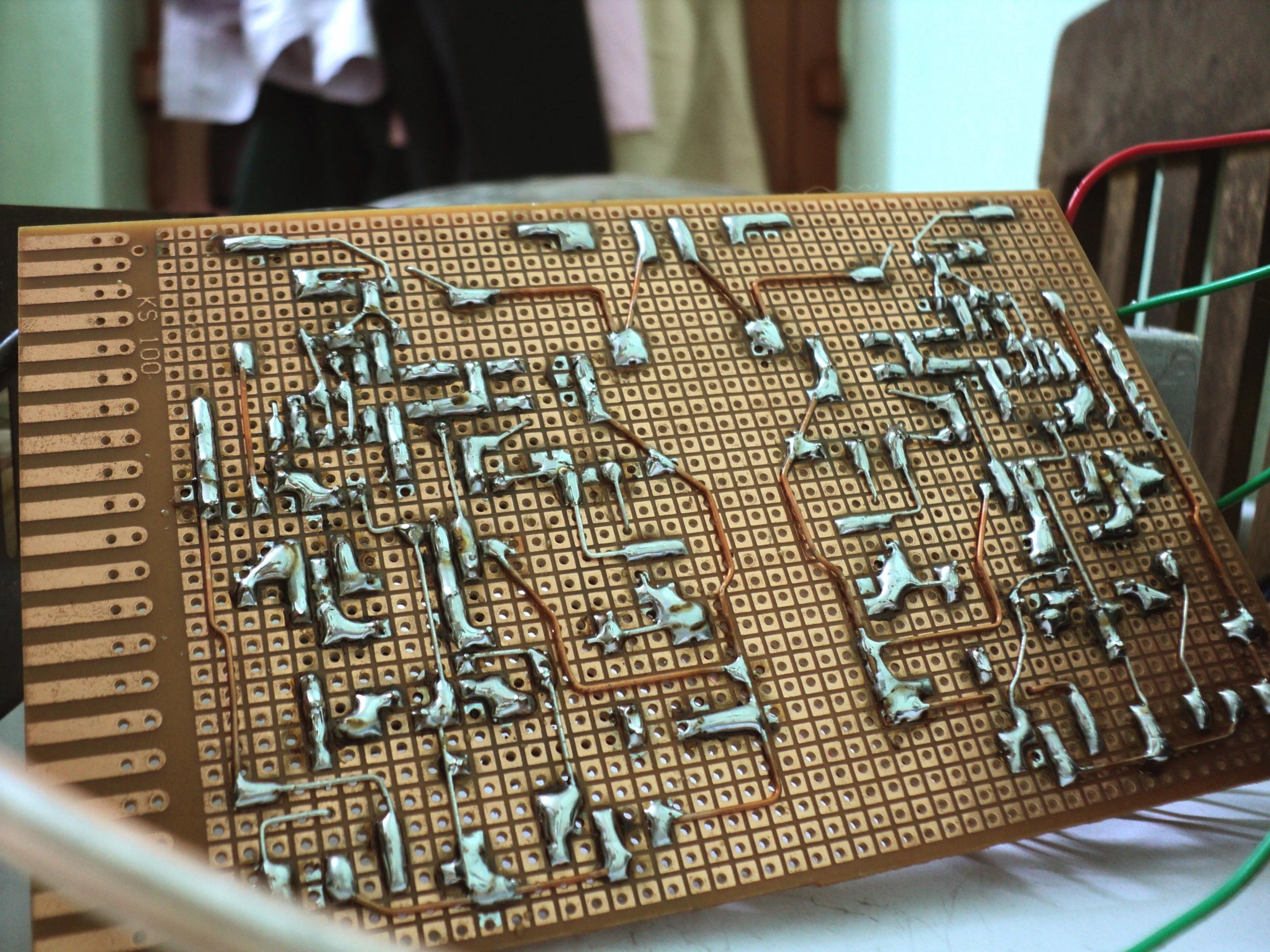

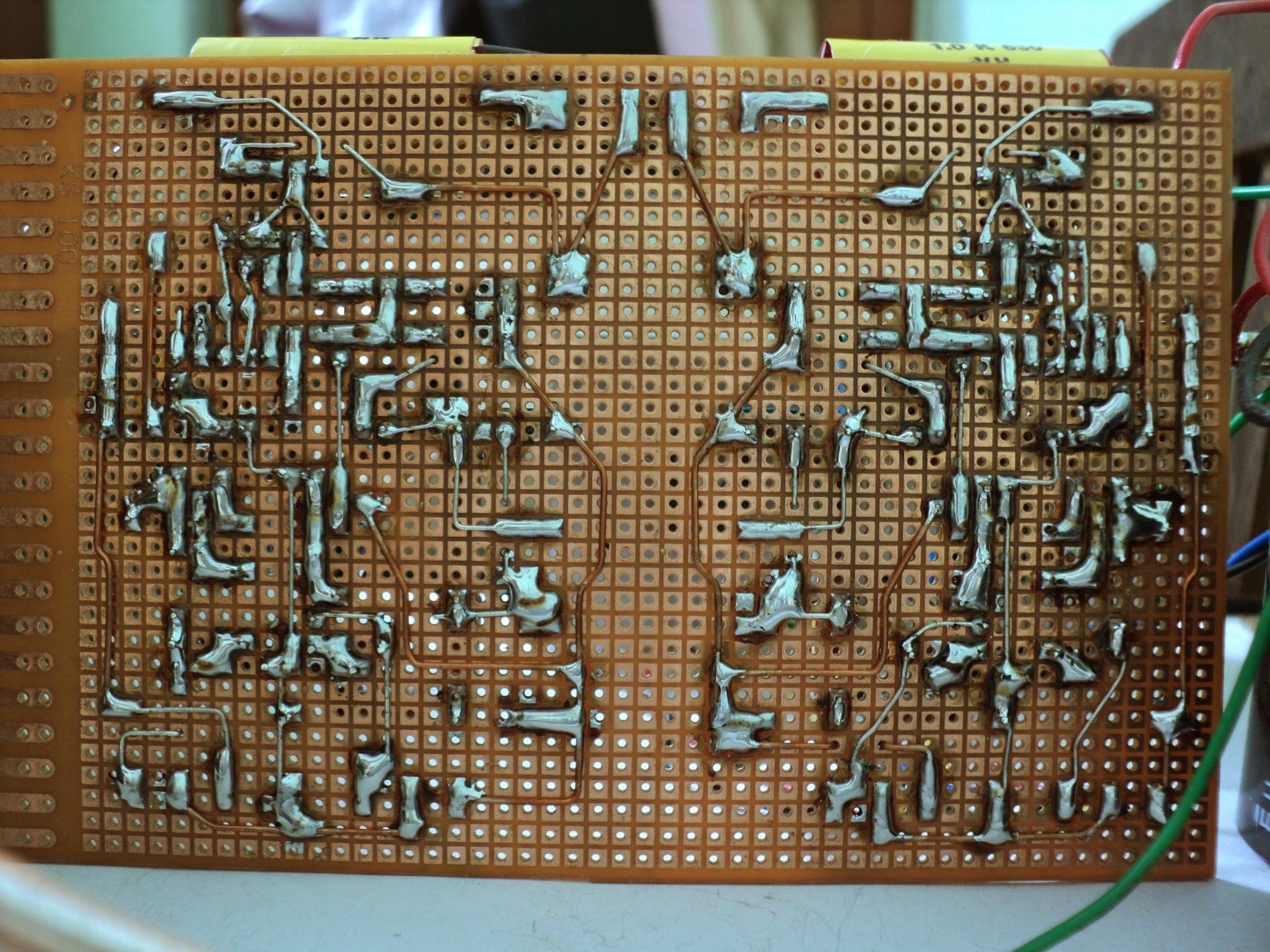

Thanks for your kind words colwaiting. The following picture is dedicated to nice guys like you! I know you can do it a lot better than me though. 🙂 All the best for your version of Magic.
Have a nice day.

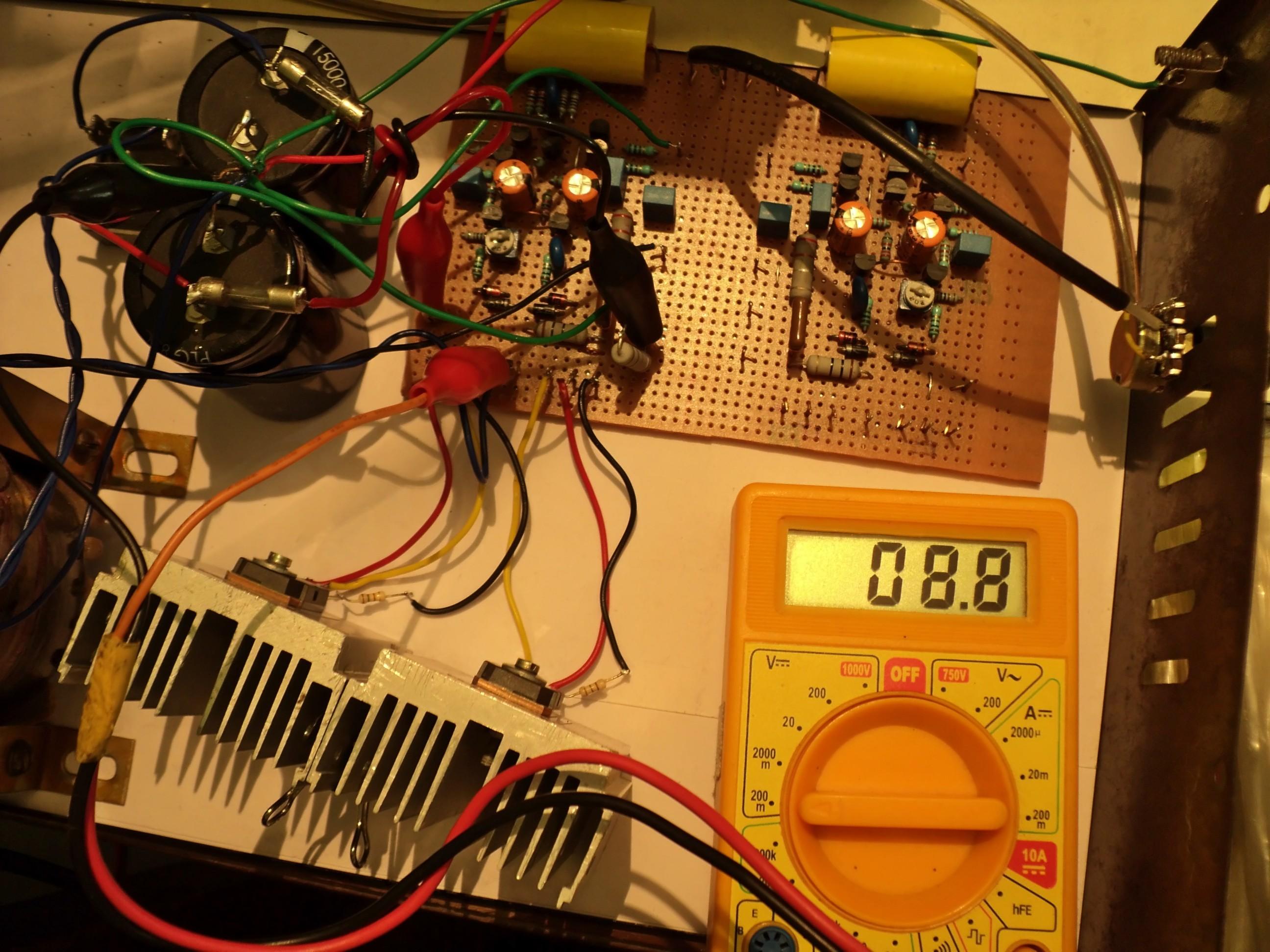

One thing I completely forgot to post is the output offset voltage.
Attached picture shows the offset which is +8.8mV for the current channel. The other channel showed -6.8mV when connected. Both of these are without any optimization, with default quiescent current of ~88mA and an 8ohm speaker connected. Disconnecting the speakers doesn't alter the offset. However, I have seen that at power up the offset rises to above 50mV for half a second and then quickly stabilizes to less than 10mV. The same happense at power down and is common in both channels. But nothing is heard of seen or felt on the speaker(cone moving or so...).
I suspect the charging delay of the feedback capacitor for this.
(the number 8 dominates... do you notice?🙂)
