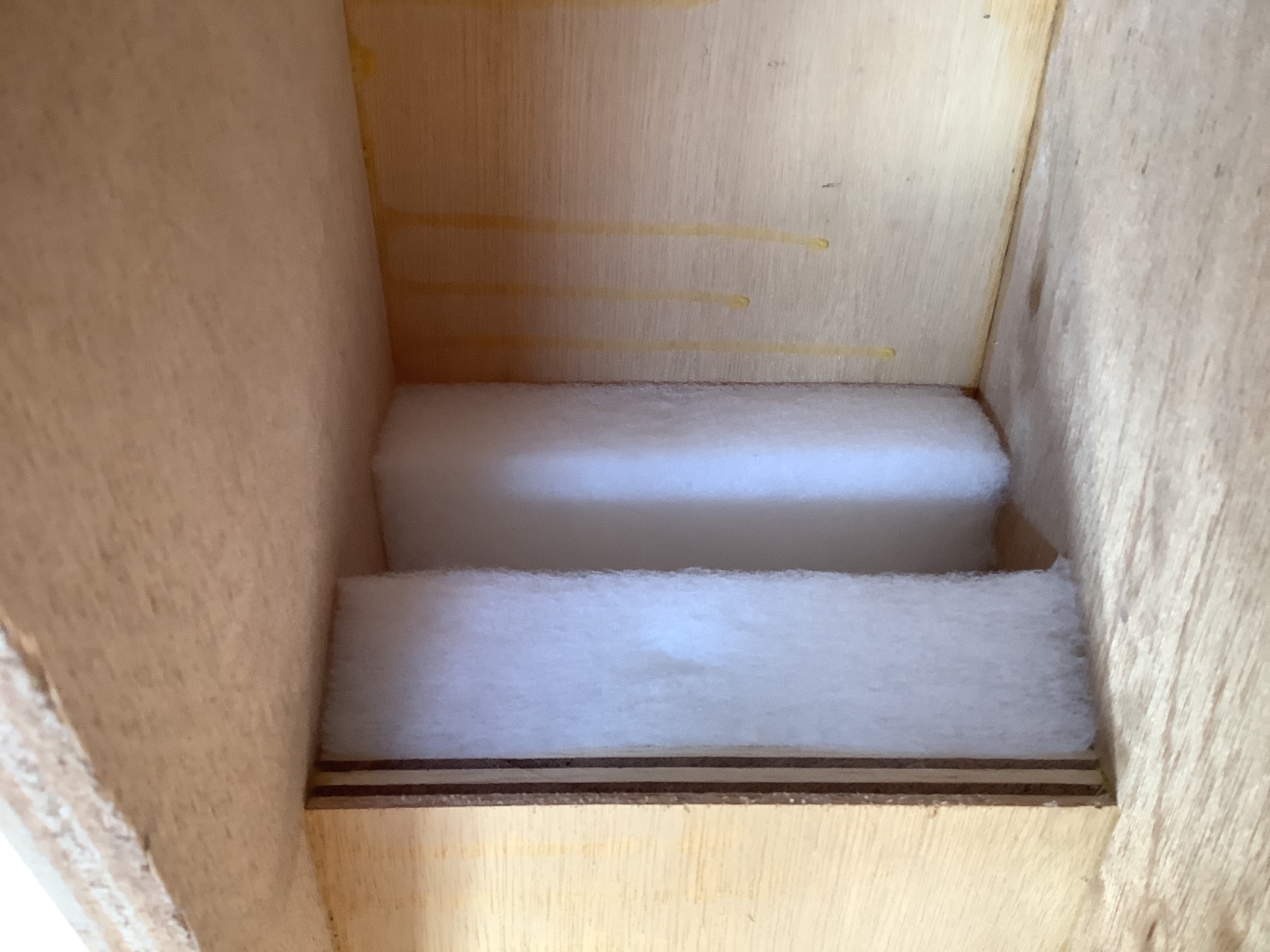

Damping in the chamber & throat area is the default; you can start to trim excess LF output by adding material above / below the deflectors, as relevant.
Damping material is always most effective at the point of maximum air velocity, which for LF frequencies is near the bifurcated physical termini; you can add some to the deflector surfaces also of course if pets etc. can't access them. And then it's literally a case of adjusting to suit your preferred balance -preferably per channel since few spaces are acoustically speaking completely symmetrical, although the one shown is probably more so than some.

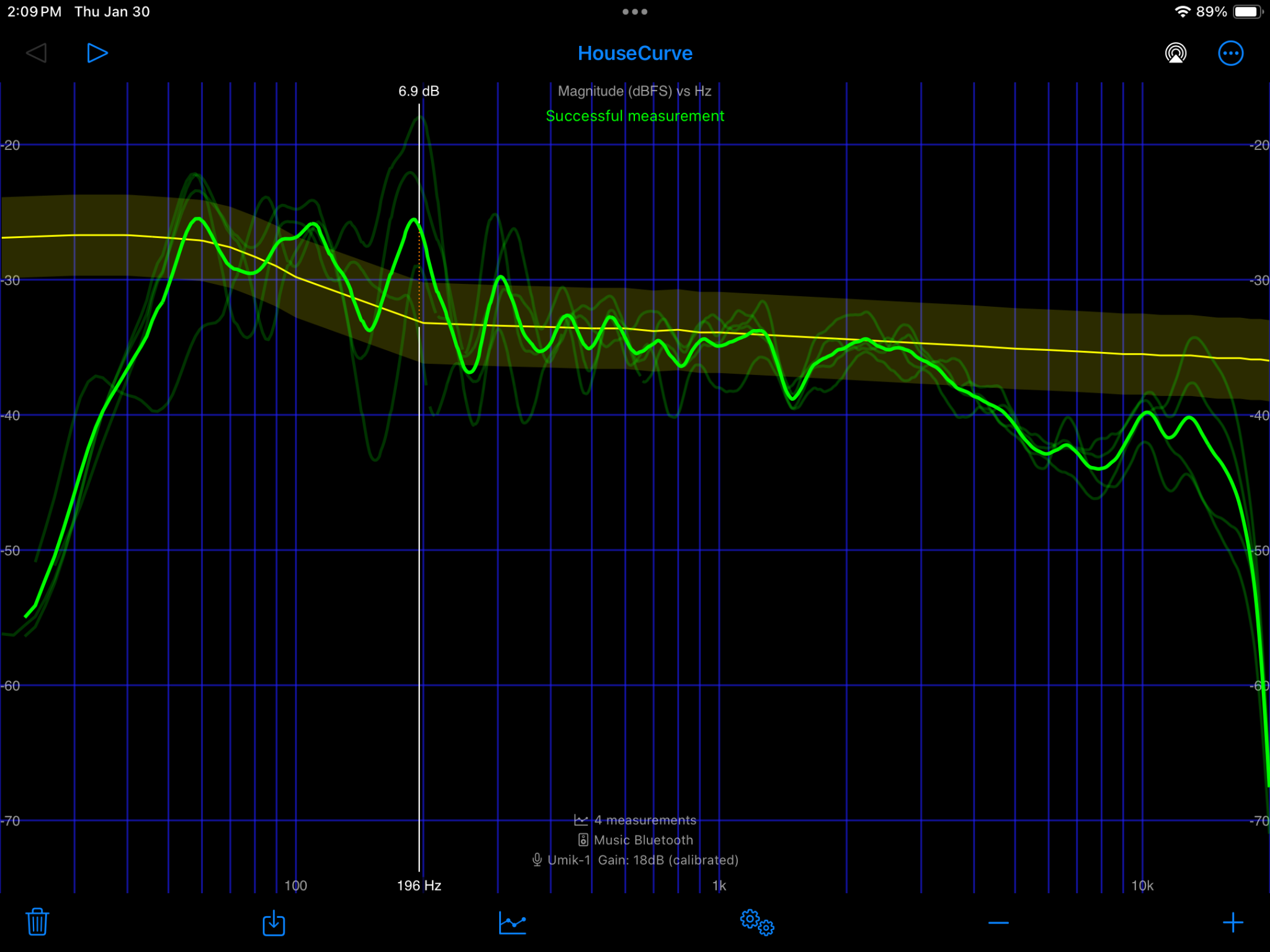

The gain BW you measured is roughly in line with expected, near-raw, albeit with the usual variations you'd expect for room acoustics, mic. type & placement. So it appears to be behaving as intended, which is always a good start. 😉 As an advance suggestion -go easy with the Harman house curve on a direct-radiating wideband. I like it as a basis myself, especially for direct-radiating multiways, but (but) you can end up chasing your tail a bit with any nominal system response curve since it's not ideally accounting for differences in the actual polar / power responses in radically different systems. That's why, say, the so-called 'smiley face' curve with roughly symmetrical peaking LF and HF can actually sound quite balanced for many people since the one tends to cancel the others out. In the case of wideband drivers, with their reduced HF dispersion, tilting it down significantly can sometimes end up causing more of an LF heavy balance than in other setups -especially if you have a large (in relative terms) horn coupling to the room over a wide (again in relative terms) LF BW compared to a sealed or regular vented box.
That hound looks like I feel. :rofl:
Thanks for the guidance and advice! I will continue to tweak things and see what happens. Damping in the mouths / termini near the deflectors will be much simpler than removing the drivers every time I want to make a change.
Your point about LF and HF balance is on the mark. It sounds like the test looks. I will aim to balance it better, for a crisper top end.

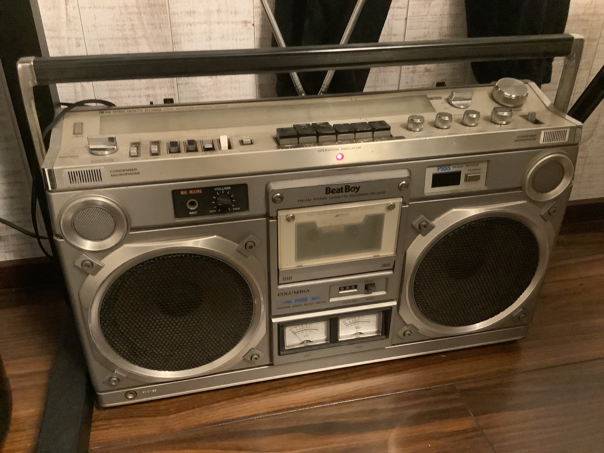

To provide context around my excitement to get these speakers up and running, this has been my primary sound system for the past eight months:
Circa 1980 Columbia RN-3000 Beat Boy (http://wikiboombox.com/tiki-index.php?page=Columbia+RN-3000). Amazing that it still works and manages to sound pretty damn good, too. I feed the rear audio inputs with an rPi Zero 2W running Moode, into a $7 DAC. Literally everyone who enters the kitchen is compelled to ask what’s going on there. How can something look so odd but sound so good? My nephews from Osaka (both early 20s) had huge grins while they inspected it. When they realized they could use Spotify Connect with it, they were blown away.

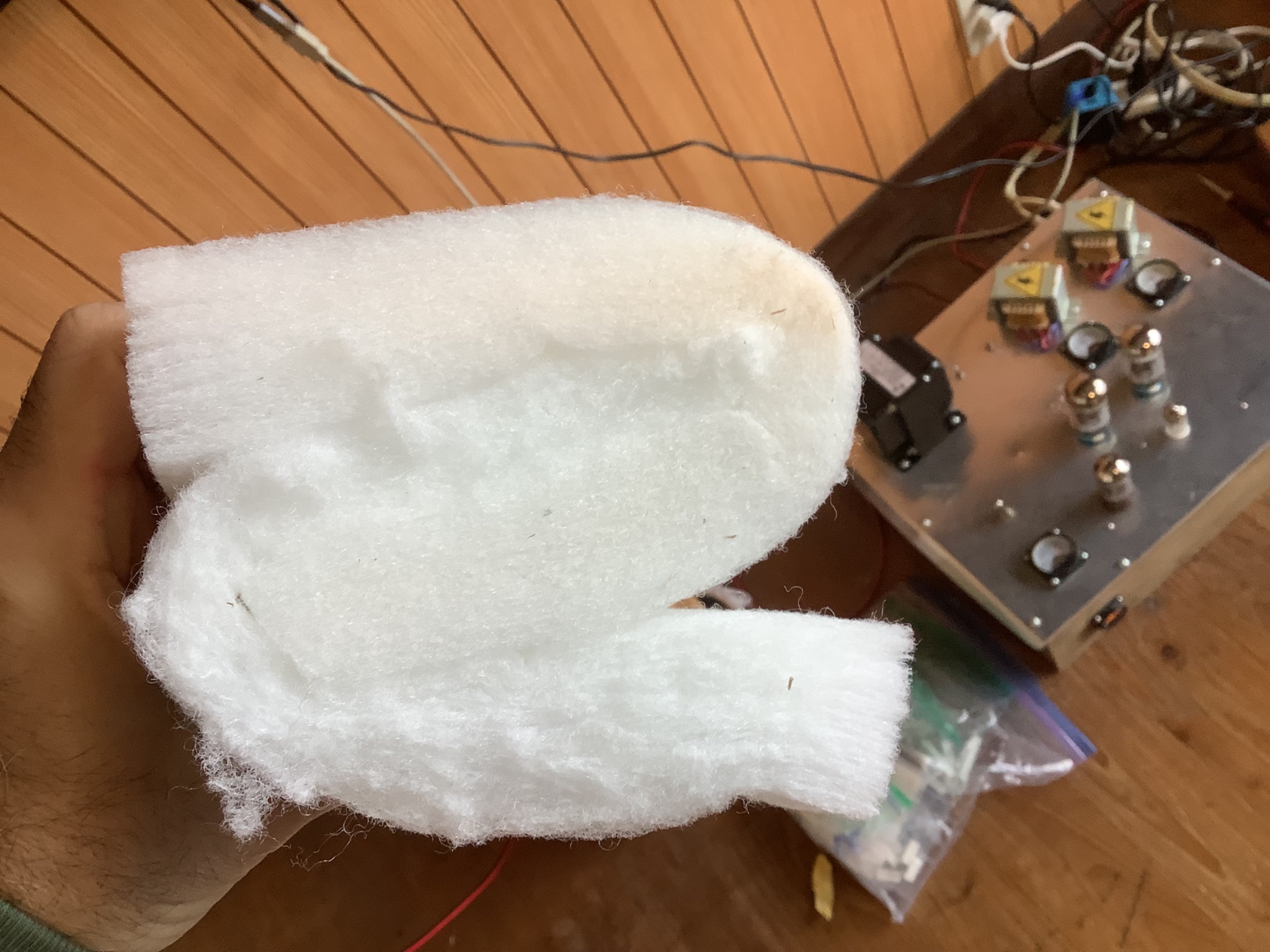

I picked up some 40mm PET felt and some polyfill today. Started with the PET felt. They were 30cmx30cm, so cut in half they fit perfectly inside the horn mouths. Tried a three different configurations and finally landed on something that works quite well. I folded each piece in half and inserted it as shown, folded end first, so that they expand to form a triangular shape inside the mouths:
The result tests well and sounds very, very pleasant.
It’ll be dead simple to iron out the remaining warts with a relatively light-handed FIR filter.

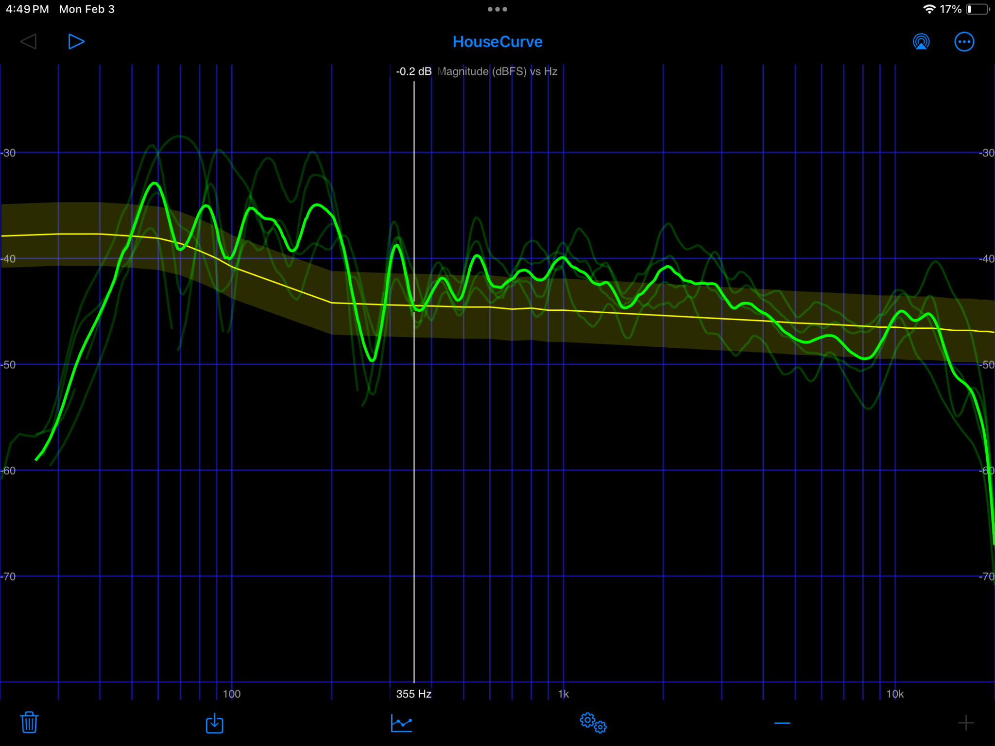

Update:
As I mentioned before, it was quite simple to create an FIR filter and use it in CamillaDSP (via Moode) to get a super-smooth response. It sounded very, very good.
It didn’t take me long to realize that this would be moot with any other sources. I did bring a select few records with me to Japan and plan to buy a TT some day, and the TV is an audio source as well. Besides that, it just seemed like the “right” approach was to continue adjustment of damping and dial the speakers in closer to ideal, so that they sound good with any source, regardless of DSP.

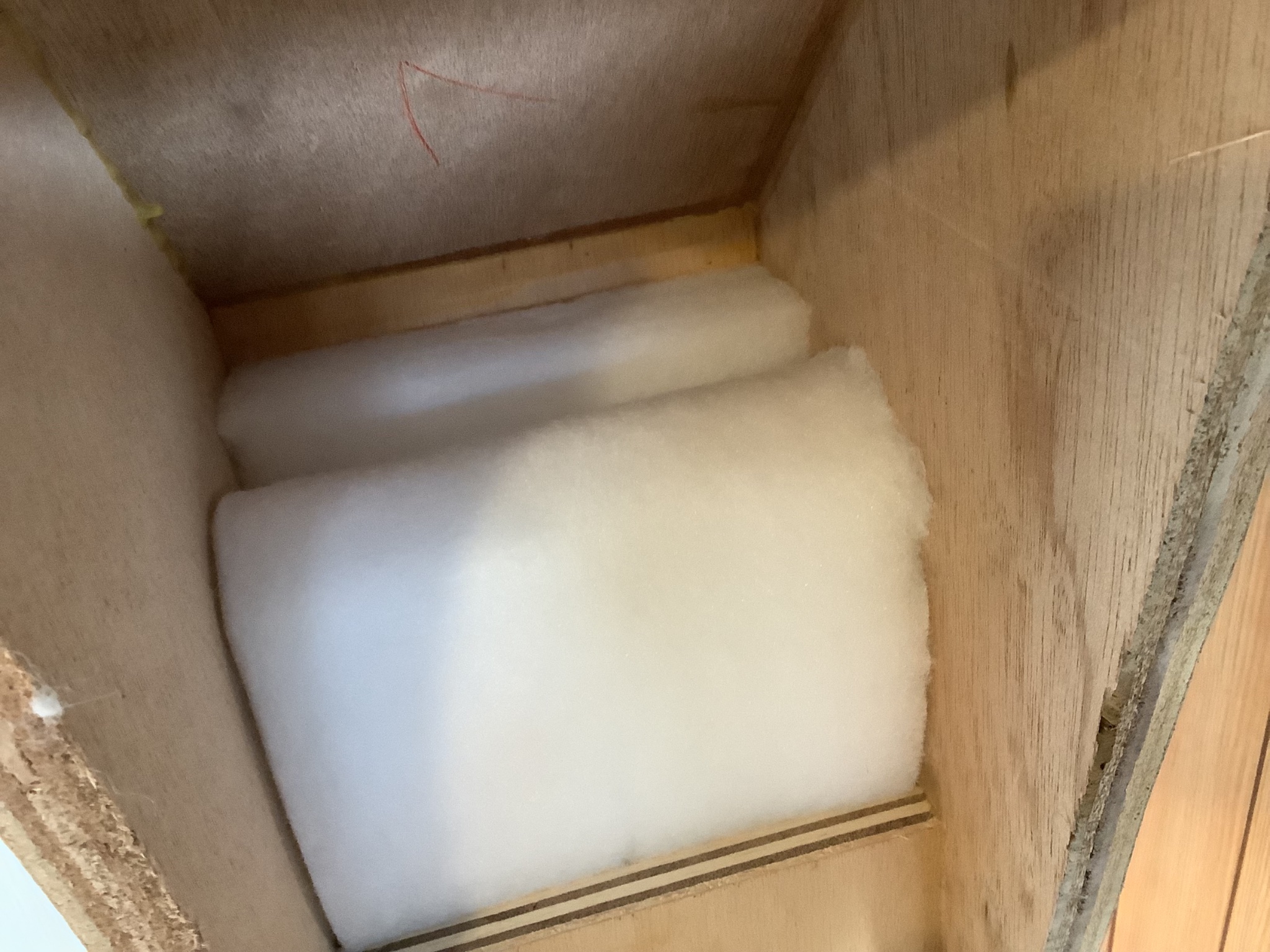

I bought 2 more 30cm x 30cm x 40mm pieces of PET felt, cut them precisely in half (as I did last time), and sandwiched them into the horn mouths with the existing pieces. Two pieces, folded in half and interlocked, which doubled the quantity and also increased the density (via compression).
Before running any sweeps in HouseCurve, I always play a couple of very familiar tracks to get an initial subjective impression of the sound. In this case, one song was enough; Dire Straits - In the Gallery. Amazing! Very close to perfect for my taste! I did notice something, though; I needed to increase the volume on my pre-amp a bit to get to my typical listening SPL. Of course! It’s the damping! So then I really cranked it up and I noticed that driver excursion was very much under control, and the sound was very tight and coherent even at these higher levels. This was very different than before this latest damping change. I mean, it sounded good before, but it started to fall apart a bit at higher SPL. Now, it’s super solid. I can easily push these speakers well beyond what I find reasonable SPL and they remain poised, tight, crisp.
So I did some sweeps:
Still heavy at the bass end, but not nearly as bad as before and honestly it suits my taste perfectly. My mind tends to fixate on rhythm in music, so rich, warm bass is always welcome. Really pleasing to listen to without any DSP.

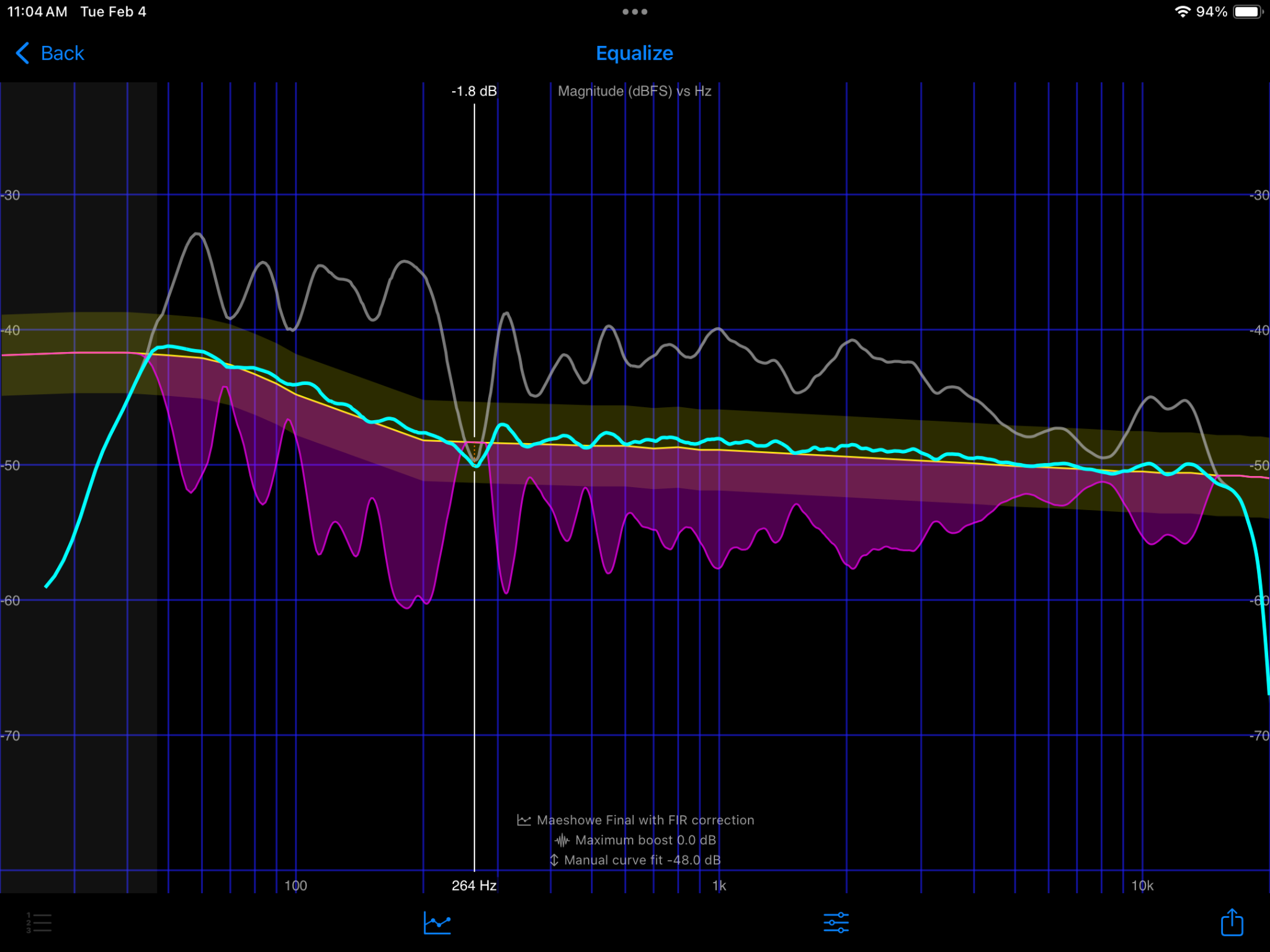

Having said that, I went ahead and generated another FIR filter for my Moode player. The results sound almost too perfect. It feels like cheating. As you can see, I used a manual curve fit in order to allow only cuts (to avoid clipping).
