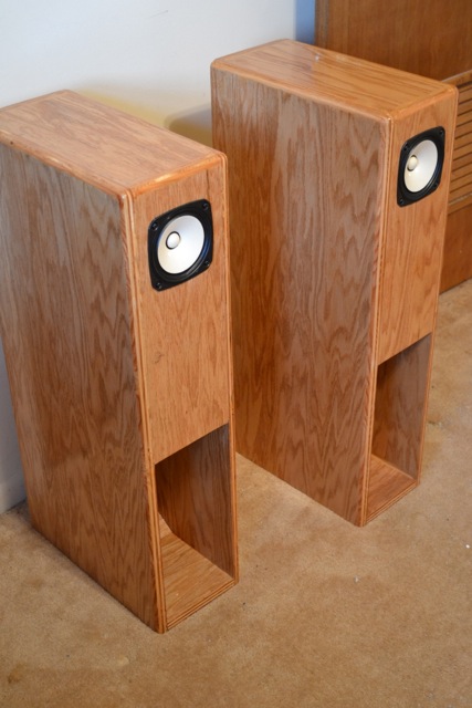

My BK-12ms
A big thanks to Planet 10 for this plan, built these from scratch mainly out of 3/4" MDF with a piece of stained beech for the baffle. (I live in Europe so shipping the madisound kit over here wouldn't be worth it)
Powering them off a Topping TP21 class T amp.
