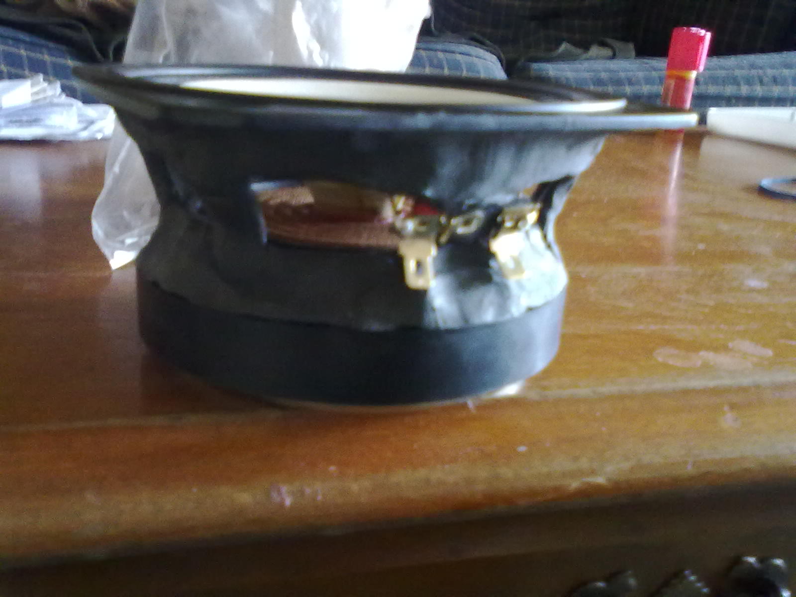

just finished a set of bk-12. duct compound'ed the basket frame, and made a set of outriggers with spikes. deff want to get them on some cheap slabs of granite, think it will help for some extra base. sounding better ever day. going to give these 50$$ a good break in, then rip them a new *******!!!! love the birch wood with just tung oil and some steel wool. ed

hello! how do you do this (duct compound'ed) and what's the effect/improvement on the driver performance?
