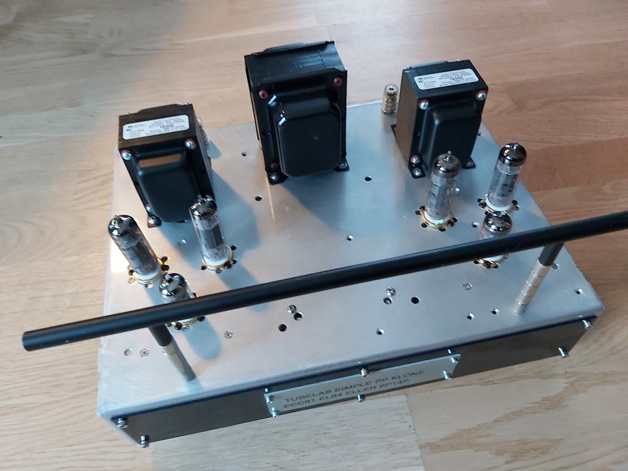

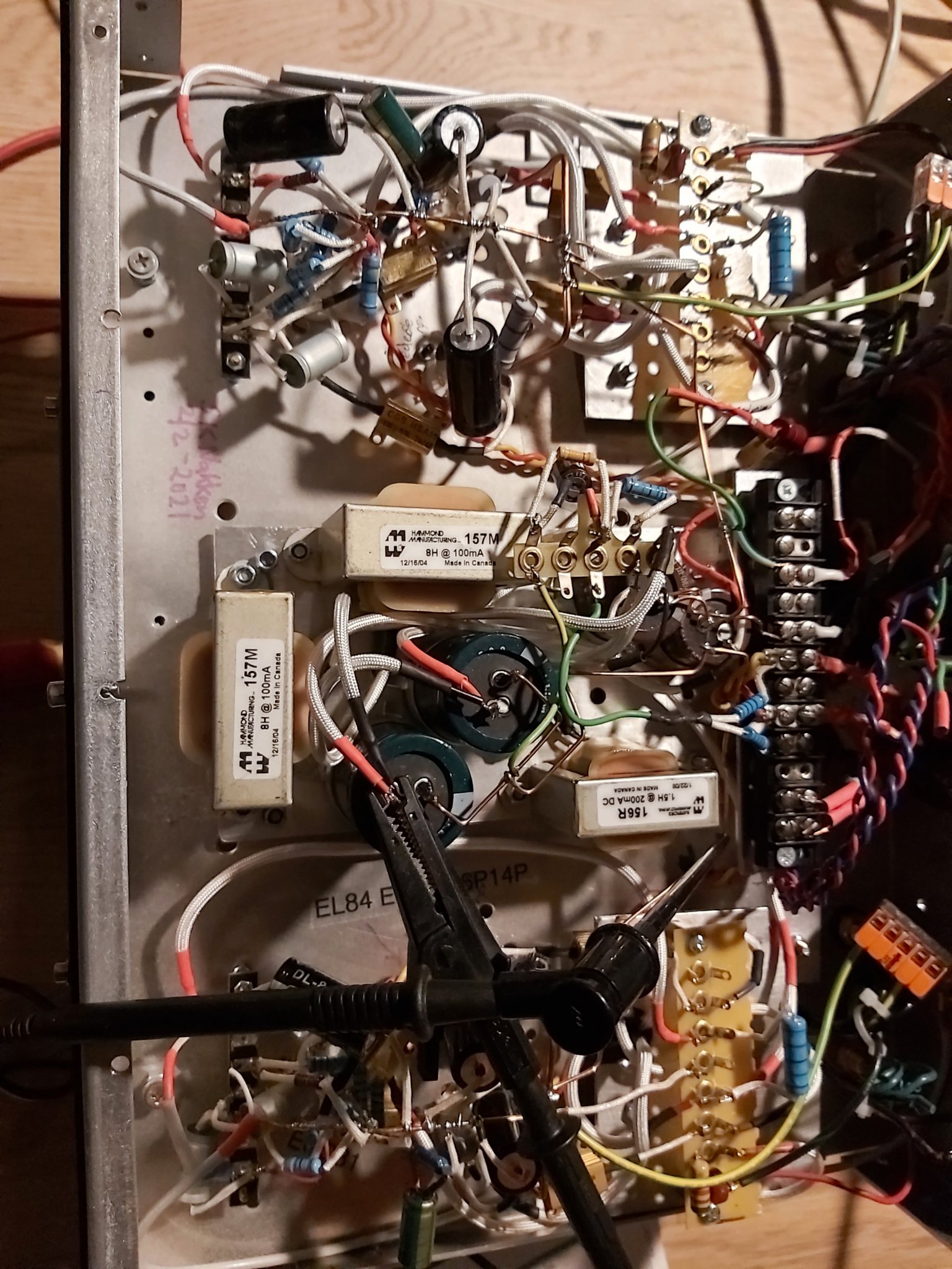

I have been working with my El 84pp, Tubelab clone for some time now. I have Hammond output transformers and chokes for my project. For about twenty years ago I bought a transformer for 250v and 6,3v. Made for 220v, and I have 235v in my outlets, so I had to get rid og 15v. If not i got 7v on the heathers...I solve the problem by using av 235 to 220v transformer! i series with the IEC-socket. Using 6P14P-EV and ECC81 from the late 50-s.Have been playing cd-s from a Cambridge player, through a Topping Dac, to the el 84 Tubelab Clone and in to my Klipsch RP 160M. I just love the sound! Bass is good, midrange are great..and so are the treble
..I put some more pictures out tomorrow
The Tubelab is a truly fine take on the classic EL84 amp, IMHO. I think it's the ECC81s that set it apart from the ECC83s typically used in EL84 PP designs. Lots of chokes in yours! Have you been influenced by some of the Japanese amps shown in the links provided by Soundhappy?
I wanted to build the amp with a "dual mono power supply"-ish , and thats why I used three chokes. Have not seen the links from Soundhappy.Think I must check it out! Build a couple el84 pp amps 20-25 years ago, but I was not satisfied with the sound..Morgan Jones had a project called "Bevois Valley amp" in one of his books, I built the amp and I remember it sounded terrible, or I did not like the sound?... , so I sold the transformers and chokes.. Maybe one that I built, was a clone of the Dynaco el84 or was it Fischer? I can not remember..
If that is the only problem a small resistor in series would solve the problem.The output tansformers are Hammond 1650E. The one in the middle are one I bought 20 years ago. Probably made in Italy?, and with 220v primary winding. Get about 7v on my heaters, little to much, so I going to remove the transformer. I just ordered one Hammond 370 HX....

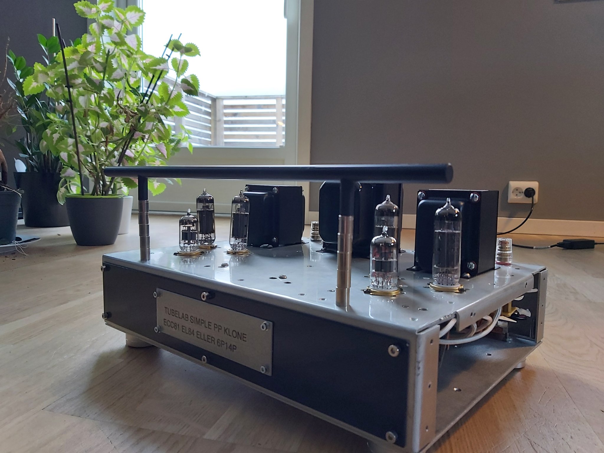

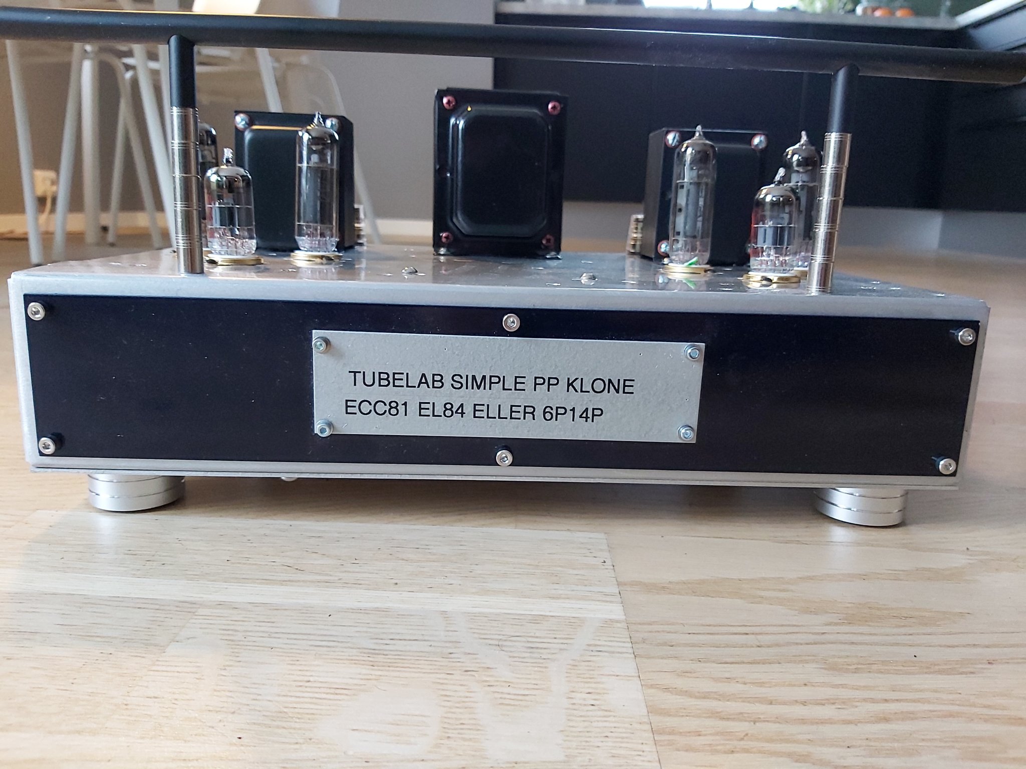

Maybe a crash-bar? I mounted the handle so it is easier to have the amp standing upside down, in the test period. The valves will not touch the floor.Is that a crash bar?
Thanks! I found the enclosure in a box of "waste", probably been a powersupply? 2mm aluminium all over, and solid. There was nothing left inside the enclosure. Everthing was better in the old days? Electonics, powerelectronics , amps...had linear power supplies and all enclosures was made of metal. Remember I found some Marine electronics on the landfill. Inside we found heatsinks large enough for BIG class A amps, and there were capacitors large as 0,5 liter beer cans in there . Now, plastic enclosures and smps are taking over..
Didn't think of that, but I do think it brings something to the party: work stand, protection when falling on the amp, handle, Plymouth Superbird spoilerMaybe a crash-bar? I mounted the handle so it is easier to have the amp standing upside down, in the test period. The valves will not touch the floor.
