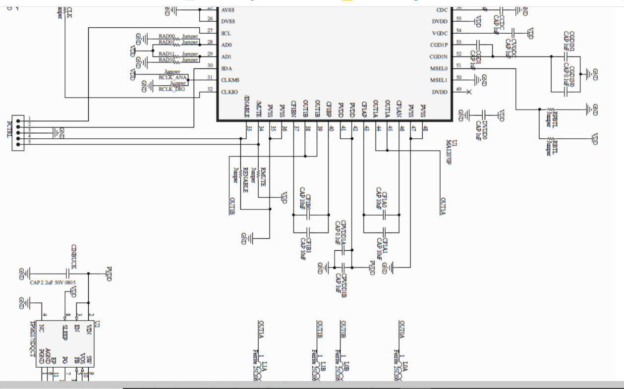

I found this image in another forum, looks like my amp doesn’t initialize correctly. I’ve tried with a 19V SMPS and is the same as with the battery

I’ve checked an Enable is pulled High and Mute is pulled low. How can i change this?
So the voltages on the resistors don't match the voltages on the pins?

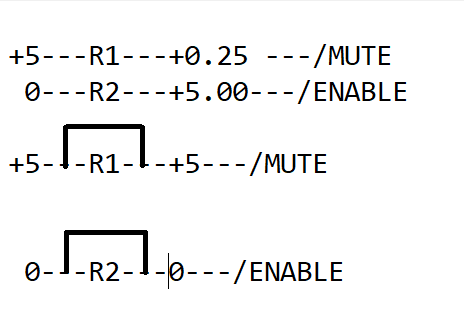

Sorry I'm not much help. I was hoping it was more like this now...
+5---R1---+0.25 ---/MUTE
0---R2---+5.00---/ENABLE
And by bypassing the resistors you would end up with this...
+5---------+5 ---/MUTE
0-----------0---/ENABLE

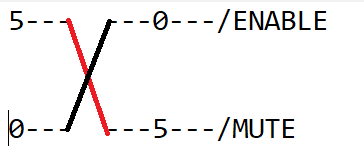

That's why I thought to cross the tracks from one side to the other, do you think its a good idea?
I'm suggesting this to pull /MUTE high and /ENABLE low. Is this what you mean by crossing the tracks?
I don't know what to say. It looks like when they went from V 1.4 (attached) to V 1.5 they really messed things up.
Unless I'm missing something, the best way to fix V 1.5 is to remove R1 and R2 and hardwire the cross like I believe you are saying.

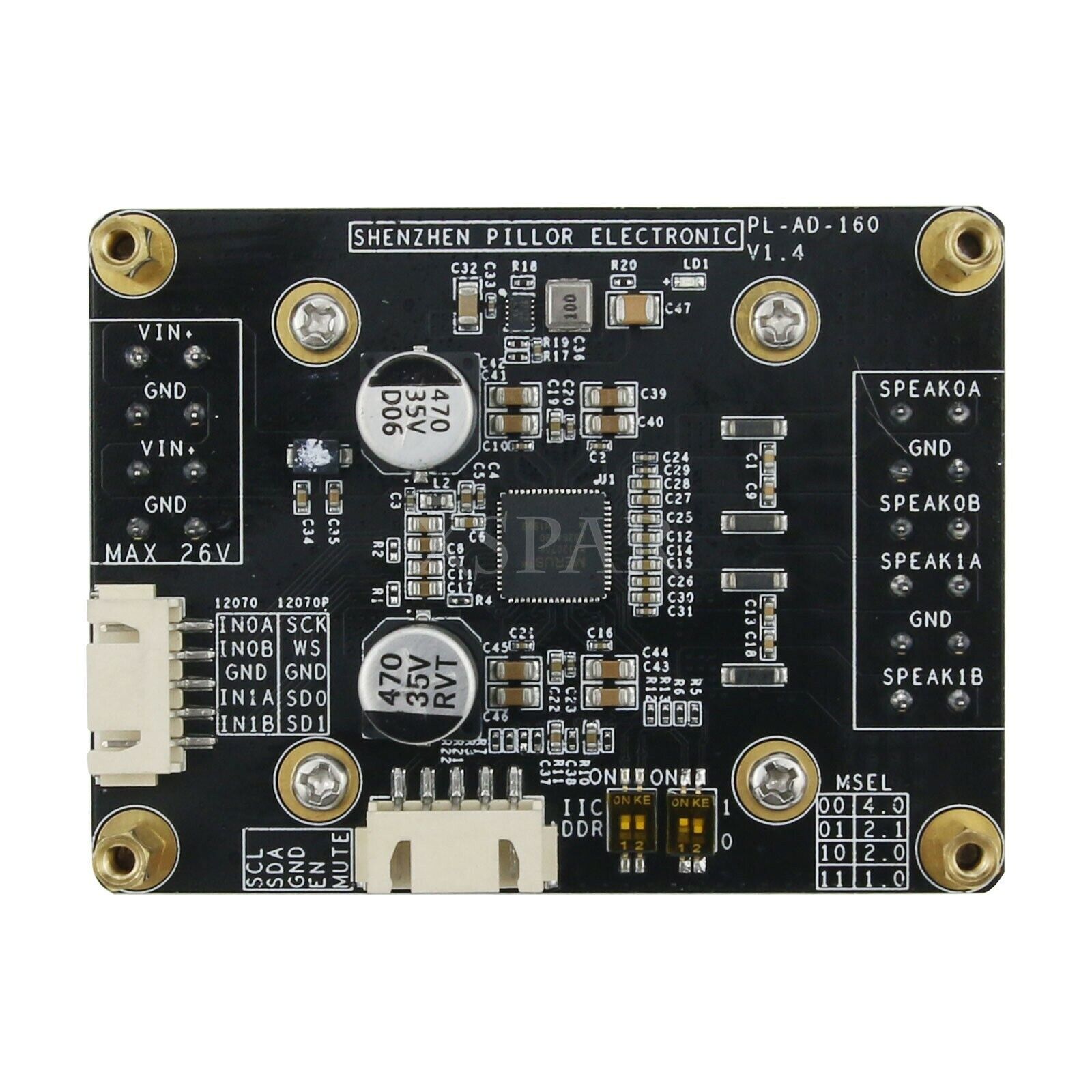

Here's the back of V 1.4. It exposes the /MUTE and /ENABLE pins. It also allows for differential inputs.
Don't think so, my v1.5 board works with those resistors in place.I don't know what to say. It looks like when they went from V 1.4 (attached) to V 1.5 they really messed things up.
So you think there's something on the board that will determine when it's time to pull the /MUTE pin high and the /ENABLE pin low? I've seen Rpi (?) Merus drivers that pause for a second or two before changing the voltage on those pins.
I think that with the resistors on and as it comes, it should work. I don't know what to think anymore. I've ordered another one from AliExpress. If I see that it doesn't work, the problem must be me, although the connection is too simple, I don't understand what's going on.
Maybe messed up is too strong but they certainly tried to make it cheaper.I don't know what to say. It looks like when they went from V 1.4 (attached) to V 1.5 they really messed things up.
