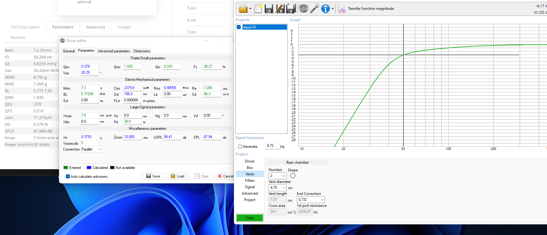

MA Alpair winISDpro files?
Leave out some of the values, as WinISD will auto calculate the exact value for certain parameters. An example would be: don't input a value for Vas, if you also input both Mms and Sd. Which driver are you trying to input?

Start the program. Select "New Project" from top tool bar. A dialogue box (select driver for project) will pop up. Select "New". The driver dialogue box will pop up. Add the driver make and model number. Click on "Parameters" and add Qes, Qms, Fs, Sd, Re, Vas. The program will auto calculate Qts and Mms. That's all you need to get started. Save, and close dialogue box.
To load your new driver, select "New Project" again and scroll down in the dialogue box for your driver. Click "Next" and choose box type (sealed or vented), alignment (QB3 is usually the best to start), and "finish". The program will auto calculate a box size and tuning. You can change this to suit your own design.

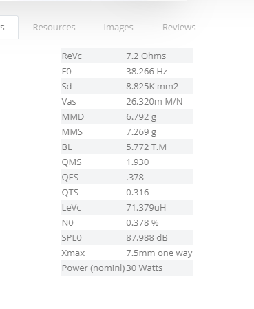

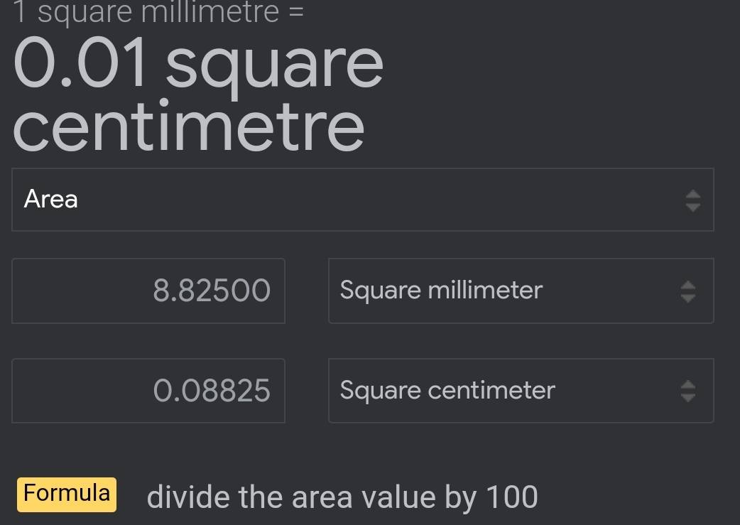

i think there is a problem with SD .What is that ''K'' ?
1000 times thank you for help
best results today
i own you some beers , just give me your mail for paypall
I still think I made some thing wrong but that's a big improvement
thank you
bye the way ,I uploaded the wdr file ,maybe someone would like to take a look at it .
