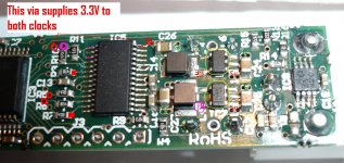

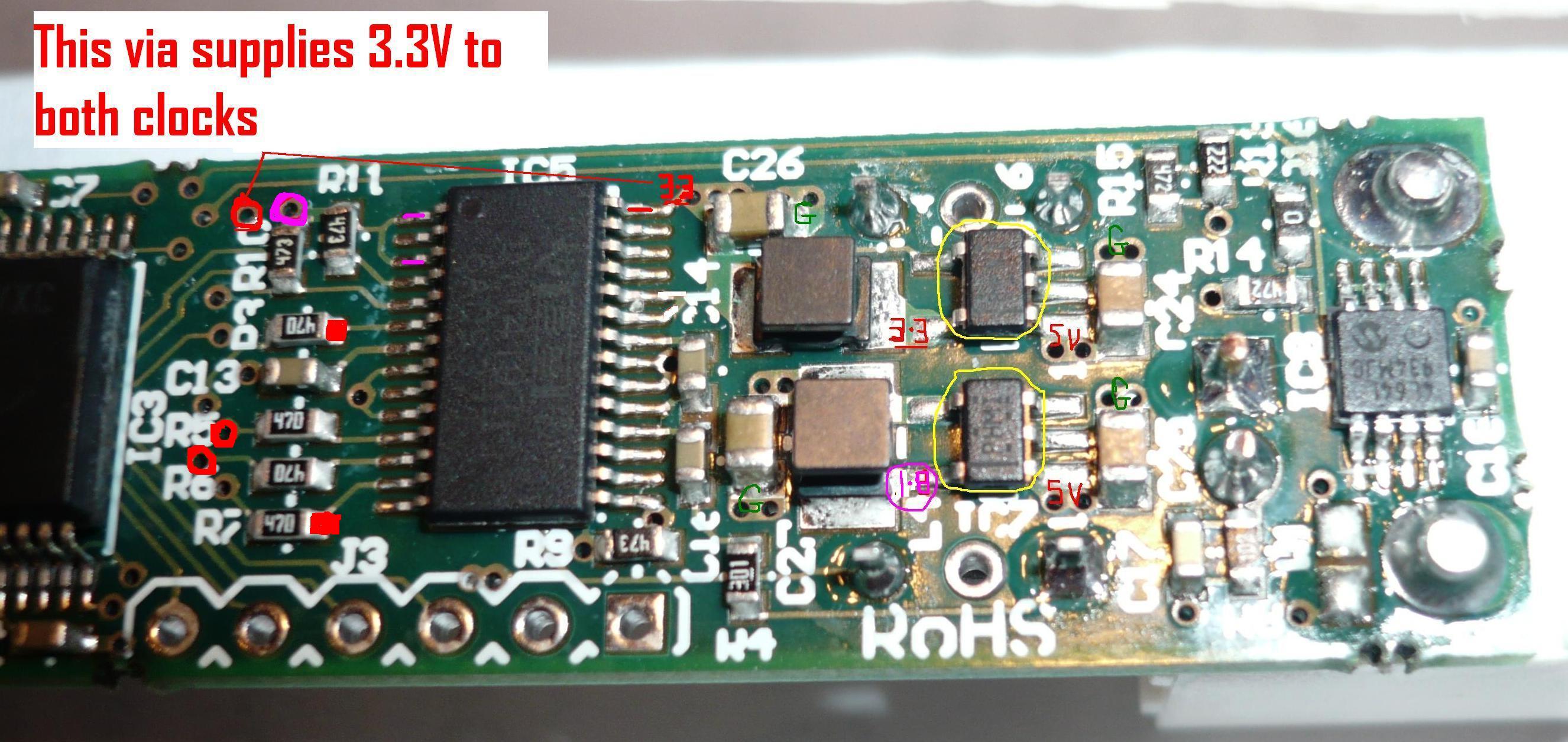

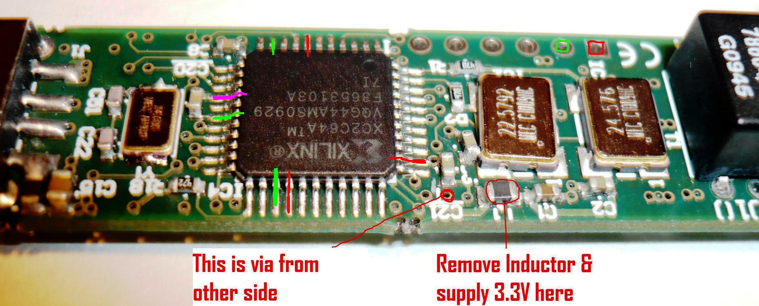

So here are the mods I intend & the stages of implementation:
- Tap out I2S from the attached points in the pic (red points show the points for tapping the signals downstream from the resistors)- I'll be using short leads to a local DAC so I'm hoping I can arrange a plug-in connection for this DAC. I'll be listening to this configuration for a while to get an idea of the sound but knowing me I'll want to go straight to the next stage.
- Supply an external clean 5V supply in place of the USB 5V - evaluate
- Supply an external clean 3.3V supply to the two audio clocks - evaluate
- Supply a separate clean 3.3V supply to the CPLD - evaluate
- Supply a clean 1.8V supply to the CPLD - evaluate

jkeny
where are those red points? I see two red squares and 3 red circles (one carries the 3.3v?)
I will just supply a clean 5V and tap the I2S.
jkeny
Here you go:

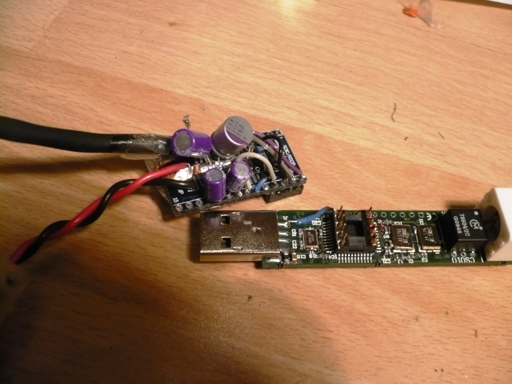

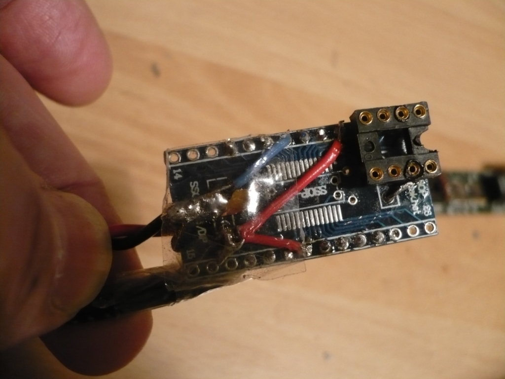

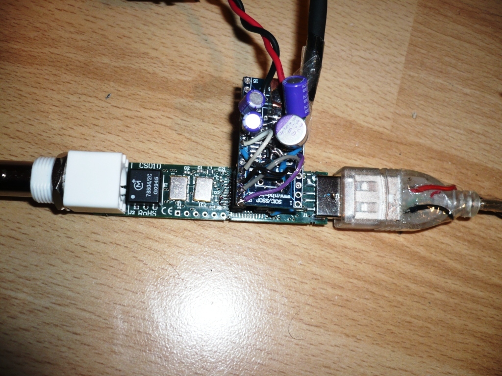

Here's some pics (but my camera has developed a fault & I don't know if I can get any more pics)
- ESS DAC is a small, easy & good sounding DAC
- I used DIP8 sockets for both plug & socket
- DIP8 socket is glued to the top of the Xilinx CPLS on the HiFace & pins point up. Thin varnish insulated wires are soldered to the 4 pins on one side of the DIP8 & ground is connected to the 4 pins of the other side. The I2S wires are soldered to the bottom of the board.
- The ESS DAC board plugs into the Hiface at right angles (it could probably be done directly on top of the HiFace).
- The third pic shows the connections - LiFePO4 battery PS to the ESS DAC - you can just see the red & black wires running into the USB connector for external 5V supply - the output is through transformers to a TA2020 amplifier also running on batteries.
- My laptop is a Dell Inspiron 6000 but I have no batteries for it anymore so I'm running it from the laptop charger without the ground connected. I reckon it would sound even better running on batteries.

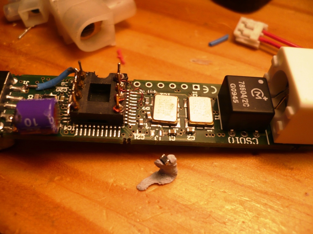

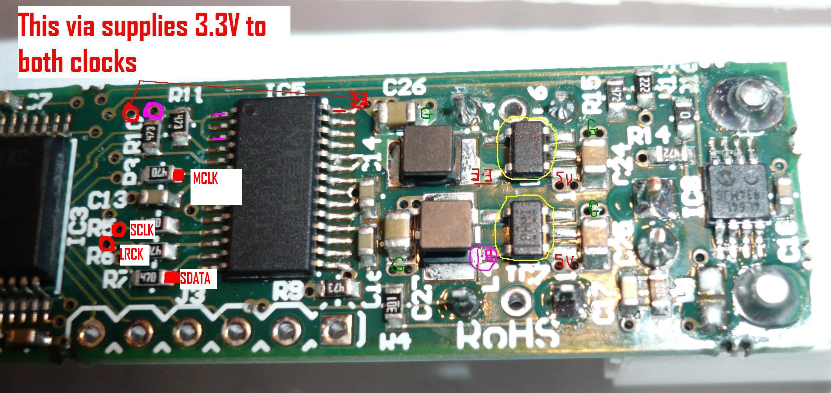

- Next pic shows the clock inductor removed from the pads marked in red & sitting on bluetak. You can see the I2S wires more clearly here going through the vias & soldered to the connection points previously shown.
- an external +3.3V (again from battery) was connected to the pad closest to C1 & battery neg connected to ground

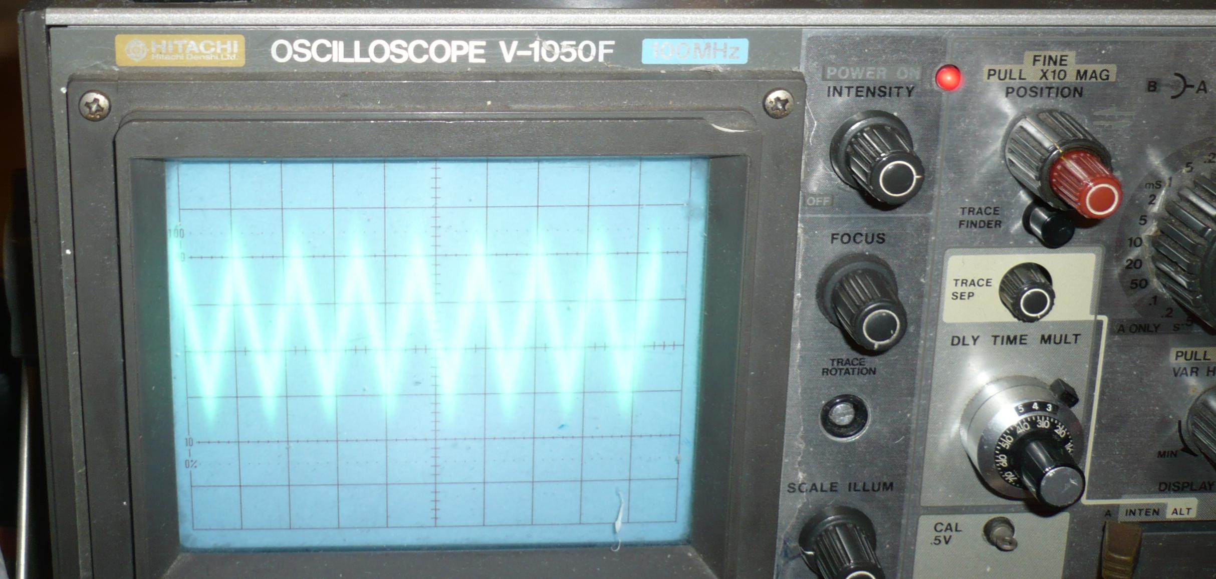

Finished most of the potential mods to this unit - here's my experience/impressions:
- The clean 3.3V supply to the clock is a must do - it clears up the sound substantially
- After I did this I put a scope on the existing 3.3V on-board - pic below - looked like 40mV peaks @ 80KHz?
- I took off the 3.3V switching down-converter & supplied 3.3V from battery to the rest of the board - another jump in clarity - not surprising as this supplies the PS to the CPLD IO banks & the clock is Muxed & buffered there.
- The only switching converter left on board is 1.8V & removing it may not have too much benefit as it supplies the core logic to the CPLD (apart from removing whatever hash this puts on the ground plane which may be no bad thing)
This is the best audio I've had in my system to date - I reckon it would compete well against the best. The weakest link now, I reckon, is the fact that there's no way to galvanically isolate the USB 2.0 signal so the quality of the sound depends on the computer (& PS) feeding it.
