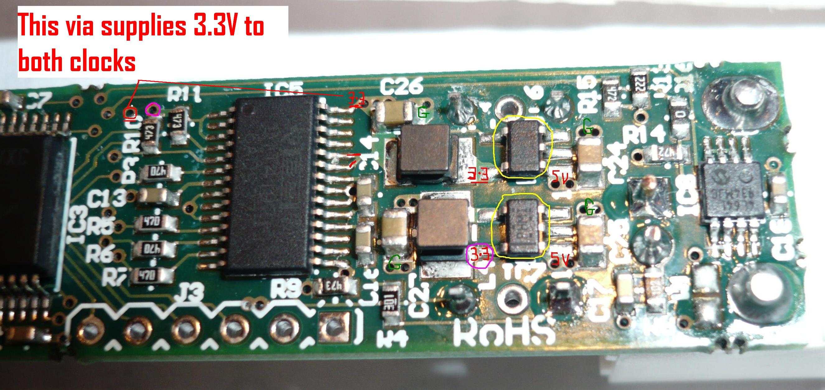

Hi guys,
I got my HiFace but can't listen as I have no SPDIF receiver DAC only I2S, so ......
I it opened up & had a look inside - I2S tapping shouldn't be a problem, I reckon, using the 3 vias (there are an awful lot of vias on this board? - not the best idea with high speed signals!).
I'm trying to find where the USB 5V gets converted to 3.3V for supply to the various chips but am finding it impossible to trace the 5V - any help would be appreciated 🙂
Is this a 4 layer board? I see lots of vias from top of the board to bottom but there is no trace connected to them on the bottom?
The only candidate for 3.3V reg is D1 but I can't trace or probe 5V coming in to it!
Edit: I see now there are 2 regs down at the output end of the board! 5 pin units (don't know their IDs) with 2 large smd inductors above them. Any idea how good these are? I'm thinking of directly feeding 3.3V battery supply to this board so I'll be looking to lift the legs of these.
OK, here's what I've discovered so far - refer to the pic attached:
- DIT4192 requires 5V supply at pin 19 so can't dispense with 5V
- top regulator in pic supplies 3.3V to the two clocks (it also sets the DIT4192 into hardware mode by setting MODE pin 28 (top right) to on i.e 3.3V)
- bottom regulator supplies 3.3V to everywhere else that needs it, (including pins 1 & 3 of DIT4192)

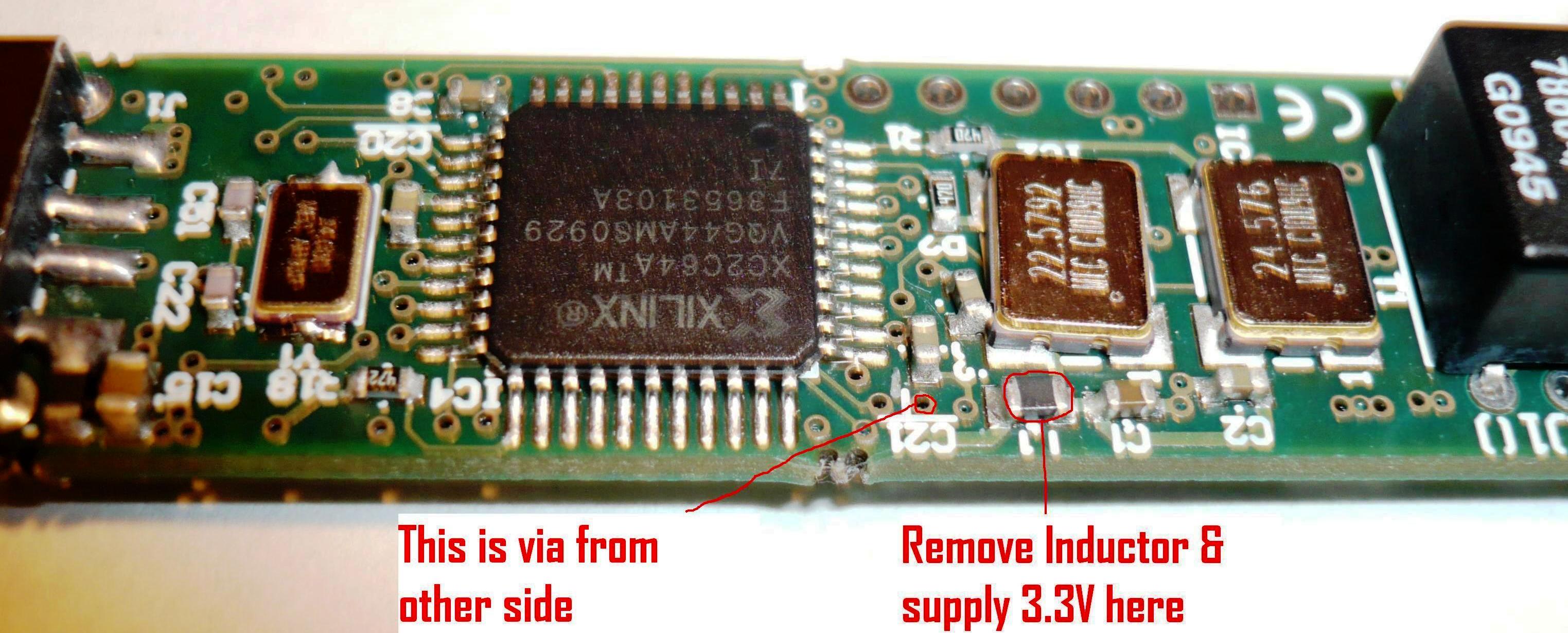

So it seems that an external 5V is probably the best & easiest option. But as clean PS to clocks is important, I might try an external 3.3V supply to clock by removing the inductor in series with the 3.3V supply to both clocks & feed the external 3.3V supply to here (see 2nd pic).
Hi John.
nice to see your progress.
two regulators are used onboard for 3.3v and 1.8v..please note that bottom regulator is supplying 1.8v not 3.3!
of course you can lift the output pin of these and feed your own preferite clean supply (battery?😀)
ciao
Vale
I
Thanks Vale,
I must measure the bottom reg again - I thought I got 3.3V but maybe I didn't pay close attention - that board is very tight & I was concerned about not shorting anything 🙂. The 1.8V is the PS to the CPLD, I presume. Any idea what regulators are being used?
I assumed that the designers had dedicated a 3.3V supply to the clocks but it seems not (3.3V is also needed for the Cypress chip)
I'm really only interested in a clean 3.3V supply to the clocks (LiFePO4 battery 🙂) - the PS to the rest of the board is probably not as critical & well de-coupled, by the looks of things. The 2nd pic shows the easy way to do this by shifting/removing the smd inductor - this is probably the route I'll take.
