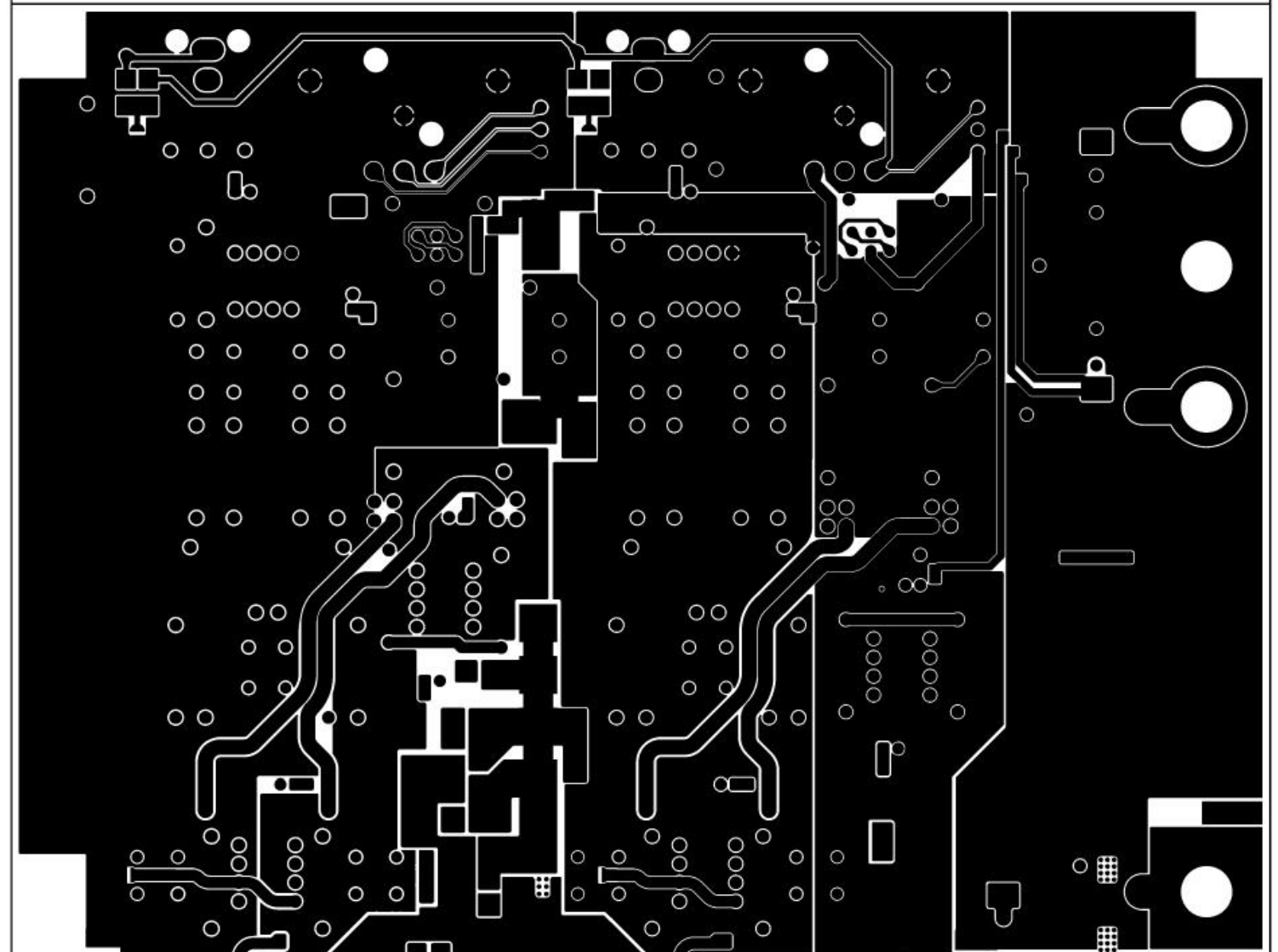

They routed the +/-15V on L3 with maximum length, high inductance, skinny traces, and put low ESR film caps at the end. This is the power routing:

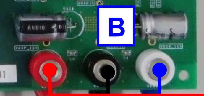

With the fast opamp mounted, I'd like to see a scope shot of +/-15V. On the furthest opamp from the power entry connector, probed on the opamp power pin (not the decoupling cap, that's cheating) with the probe ground clip set on the closest ground via... Something like 10-100 ns/div to observe supply ringing on transients, if any.
If ringing is observed, an effective fix is to replace the SMD film caps with a smaller MLCC and a tiny 0R47 or 1R resistor in series. The SMD film cap looks like 1206 so a 0805 MLCC and a 0603 or 0306 resistor should fit on the existing pads with a bit of tweezer work. If you solder the resistor upside down, with resistive film against board, that shaves off a slice of a nH, but that doesn't matter here.

Also due to cuts in ground plane, the return current path from opamp's decoupling caps to DAC GND remains mysterious.

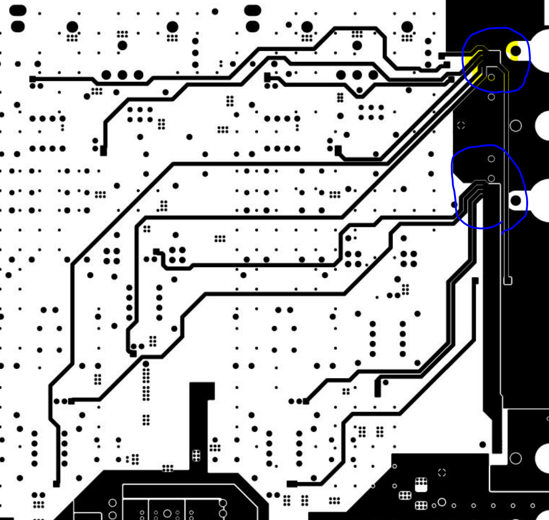

But look at this. The power traces are not routed on ground plane, they have to cross like 4 cuts
Ouch, You are right

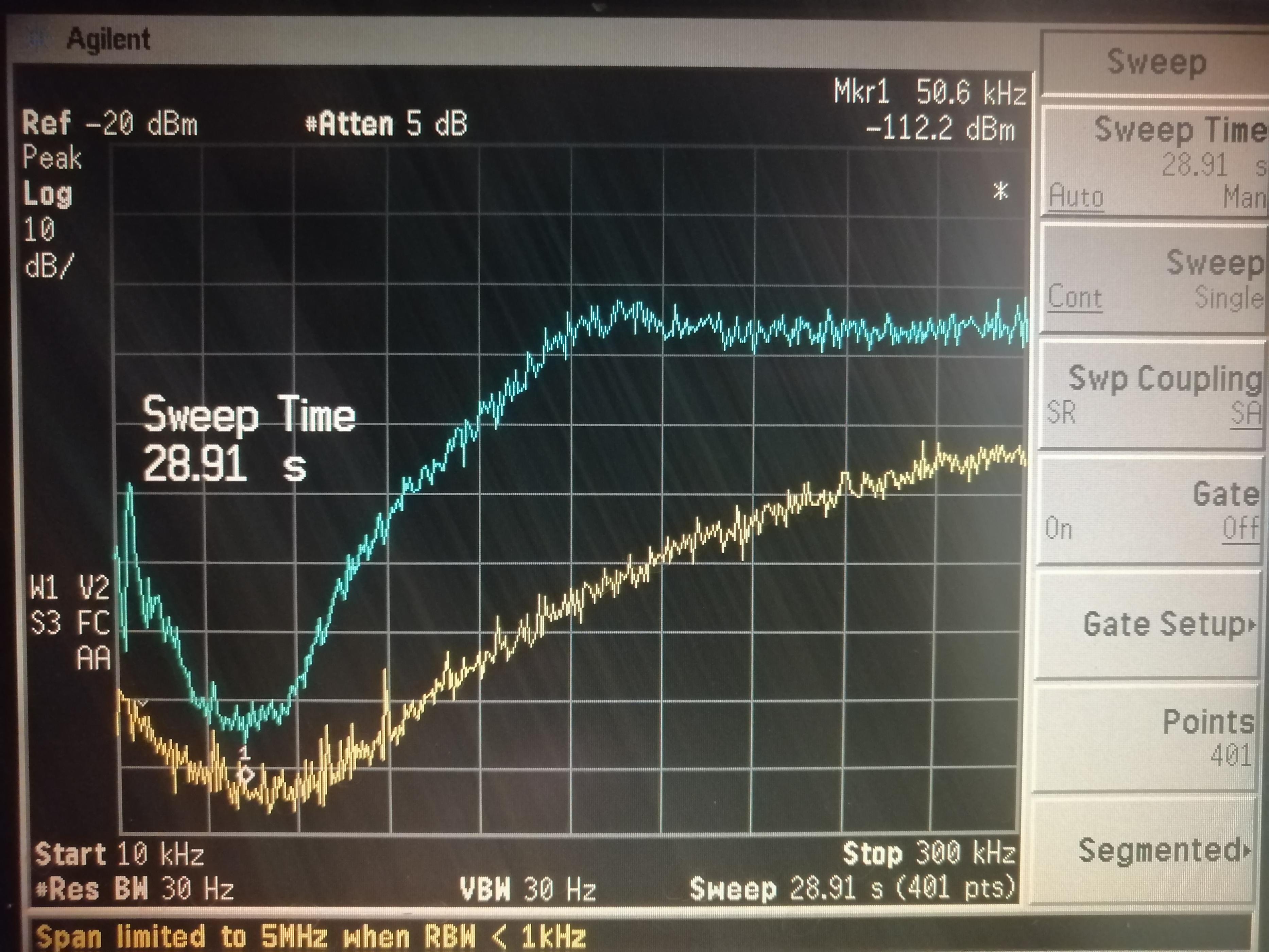

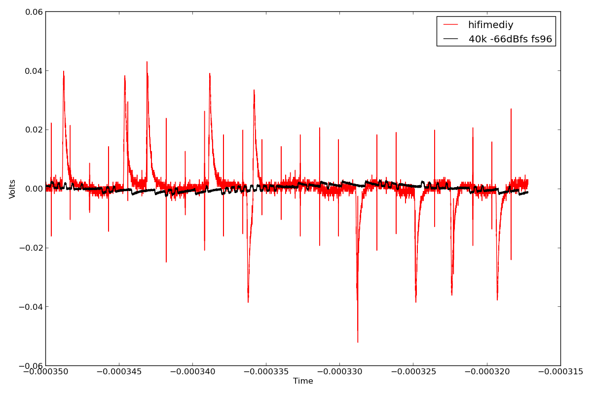

That's the output of ES9023 with ridiculously bad layout (red) and good layout (black) ; in the latter case there's only modulator noise which is unavoidable...

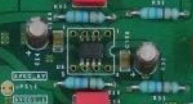

Also, opamps are on Brown Dog adapters at the moment. Agree inductance is higher than if SMD mounted right next to decoupling caps. Probably, I should just solder OPA1612 or OPA1656 to the PCB and work on trying to make things sound right that way. Also know I can do much better at the I2S and MCLK input than straight from I2SoverUSB. Take some time to get it all setup though. May want to do a revision of a clock, digital input, and DSP board I made for AK4499. Haven't decided how I am going to do some tests particular to this chip. Scope probing may tell me if there are problems with the board design around the opamps (not unlikely), but I know from lots of time optimizing AK4499 that is hardly going to be the only problem.
