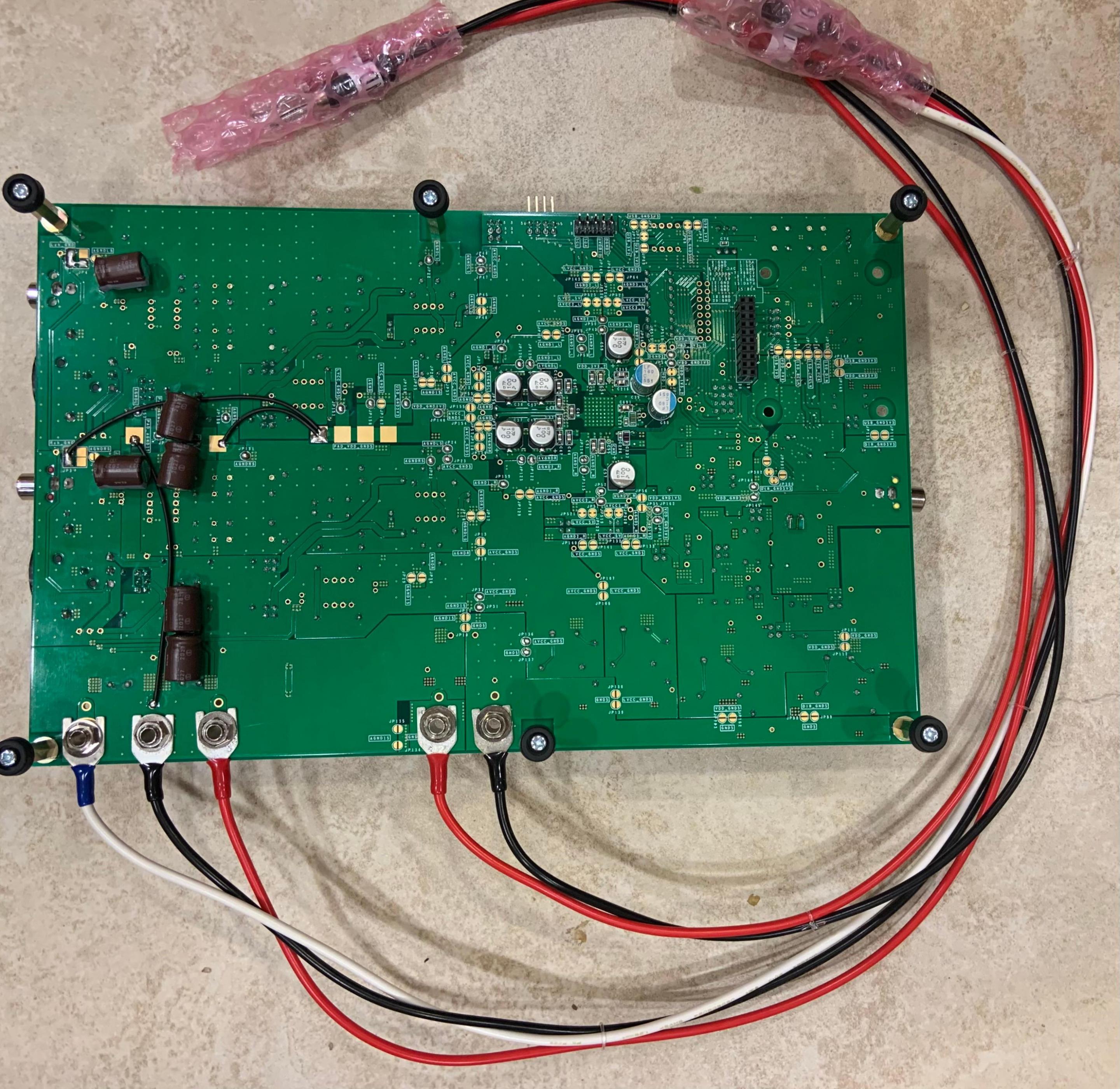

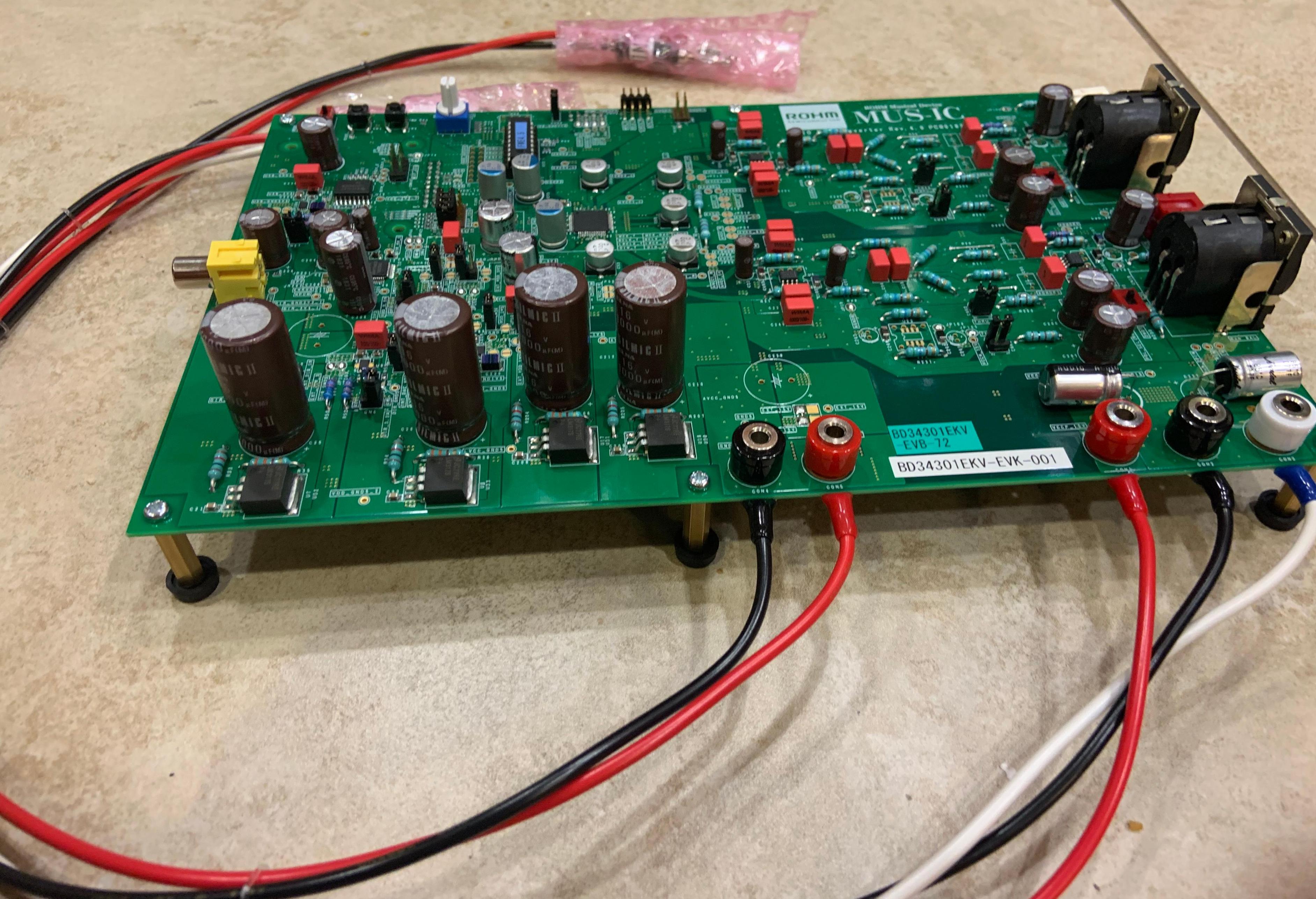

The 5532 are TI brand. The Rohm regulators use all Rubycon PPS SMD caps. Just the 10uf output caps are about $10 each at Digikey. Output stage uses all through hole passives including Wima films. Opamp bypasses appear to be Rubycon PPS SMD. Most of the electrolytics are Silmic 2.
Also, the board is indeed very intricate. It appears to be designed to allow for many different kinds of experiments. Could be in some places there are using PCB fill to ground plane capacitance to make some very low ESR distributed caps. The grounding scheme appears to be patchable with soldered wire jumpers on the bottom of the board.
More later. I will try to post some pics when I have a chance.

yes, the arrangement and combination of SMD passives is very similar to what i've got on my boards (except i'm using a fair bit of ceramic decoupling too), with PML, pps. I believe the larger rubycon PML caps like the 10uf are acrylic, rather than pps. pricey. I bought a bunch years ago along with the pana pps, but I was blown away by how much those and the ltc6655 references have increased in price since my past purchase. it doesnt surprise me about the jumpers for ground, the pin descriptions of all the analogue supplies and analogue grounds and whether they are separate are a bit ambiguous in the DS and I need to study it in detail. I look forward to your photos and some more time available to study the DS some more.
