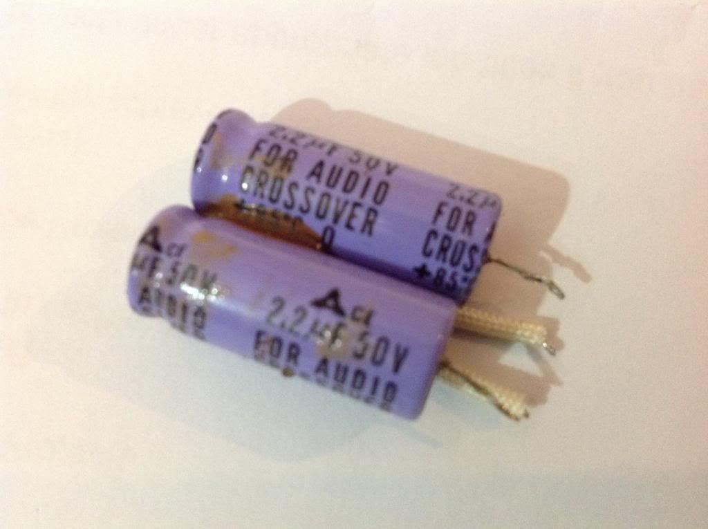

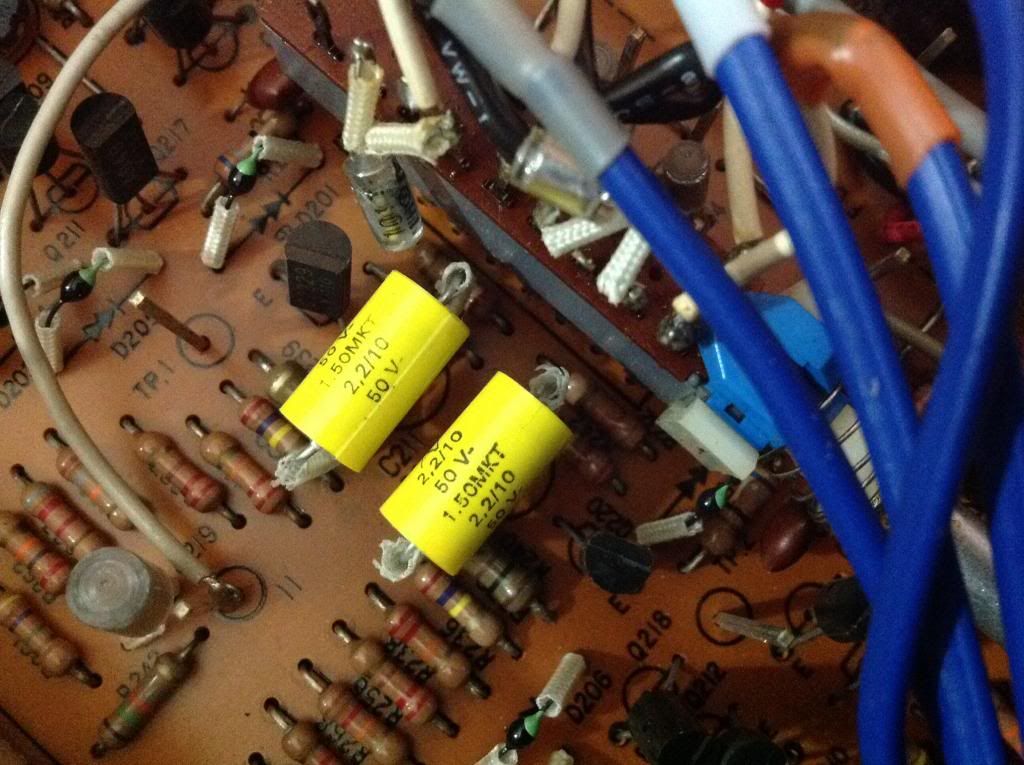

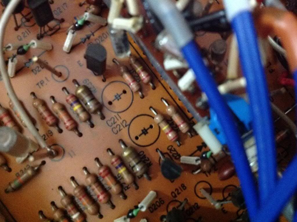

Replaced the el caps with poly extra pair in my parts bin..
Old caps & location
New caps installed

Replaced both with poly caps which worked well.
