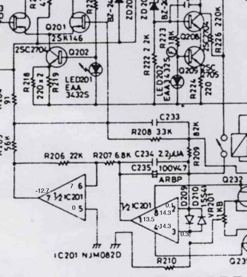

Hi Marc,
All right. There is something seriously wrong in the front end. This may also explain your low bias. The DC offset integrater is doing it's best to correct things.
At this point you may be further ahead to simply remove and test all you signal transistors. While you are there, measure the gains and match the ones that work in pairs.

I found a cold solder so here is what I get now on the servo op amp .
The bias seems stable with no bias on the outputs (I work on the board without heatsink on outputs)
I tried to raise the bias and got 40 mv like it was.
Pins
1- 1.742
2- -.003
3- -.008
4- -14.4
5- 0
6- -.003
7- -5.8
8- 14.4
Marc

Hi Mark,
That's better, I still don't know if it's working okay. At least it isn't pegged. What is your DC offset now? Is it stable? Where is teh offset pot?
-Chris
