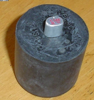

(aren't the big amplifier feet i received from ApexJR a sight for sore eyes)

Marc,
Ssang Yong can build an engine under license, that doesn't make it a Merc.
The 2SA1302, 2SA1943 and MJL1302 are all different devices.
Japanese semiconductor manufacturers base their production solely on demand from the Japanese market. If the local demand level does not justify continueing production of an item it is taken out. There are plenty of Japanese semiconductors that were replaced by lesser ones because of changes in the Japanese audio industry. Wish i had been more prudent in the past and bought twice as many parts every time.
The 2SK146 in your M-05 is a prime example. There is nothing like it anymore, and probably never will. That device was pretty expensive when i bought them while it was a regular production device. Now you pay at least 6 times as much, if you can find them.
Question is : would you rather risk using inferior parts you paid top dollar for to rebuild a classic car and keep the original flaws, or use affordable aftermarket parts and build a more reliable car ?
A lot of the amplifiers from that era were not constructed with longevity in mind. Japanese manufacturers in particular had/have the urge to minimise parts and production costs wherever they can. Especially with class A amplifiers and output stage cooling more than one Japanese manufacturer had a hand of going for undersizing and designing for high temperature levels. Some made that decision over and over again, despite market feedback to be more prudent. Several Japanese (class AB) amplifiers are notorious for this minimalise state of mind.
If i had your M-05 i would rebuild the output stage with heavy duty OnSemi's. (despite me having all the parts to keep it fully original)
But then, i'd toss a Chevy V8 in a Range Rover instead of retaining the crummy original engine. I'd never buy a Tifosi model.
