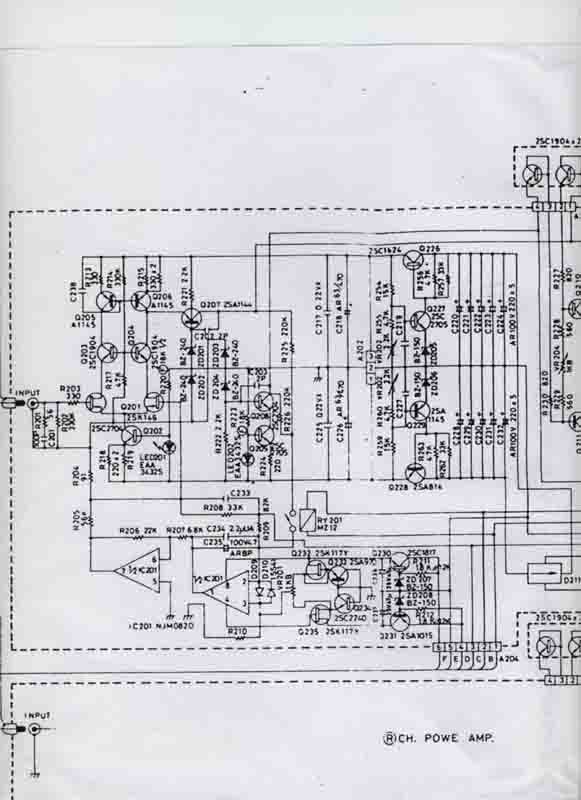

I can't use my M-05 now because there is a problem with the bias. The left chanel doesn't heat at all but is playing.
VR202 is normally set to get 110mv between pin 1 and 2 of A202. I have 35 mv when the pot is set at the maximum. Do someone know what can be the problem ?

legarem said:VR202 is normally set to get 110mv between pin 1 and 2 of A202.
Care to tell what A202 is ?
I only see something with 1-2-3 on the picture after the +/- voltage regulators for the front end.
Fujitsu devices, 2SK146: pretty obsolete stuff.

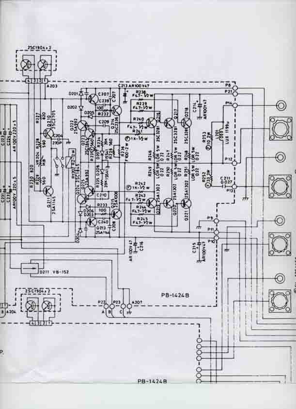

Is it possible to post the right half of the schematic with the output stage ?

Marc,
VR201 is for trimming the zero DC-offset point of the output,(no signal).
Its located before the DC-servo opamp in the schematic, bottom of the pic.
VR202 and VR203 trim the +/- voltages of the voltage regulation stages for the front end, right side first pic.
VR204 controls the bias setting of the output stage through the Vbe multiplier.
The two 2SC1904s at the top of the schematic of the output stage, second posted picture, are switched as diodes and placed on the heatsinks.
I would check the 2SC1904, if the left contact of relay RY202 is sticking you wouldn't hear music through a cold heatsink.
