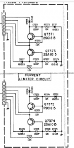

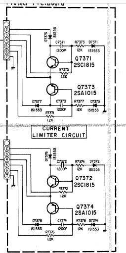

I have not followed all details of this tread, but I had the same symptoms on an LV-103 after I had to replace MOSFETs.
Turned out to be damaged (shorted) transistors on the Current Limiter board of one channel. Disconnected the board and now turns on. I did not have any replacement transistors of correct type for repairing, so the amp see little use.
I am running a 2SK1056/2SJ160 on the output I believe I should fix the current limiter to avoid new damage since the temperature drift of these transistors are different from the originals.
Can I use generic transistor types in this circuit or do you believe type and Beta of Q7372/Q7374 to be critical?

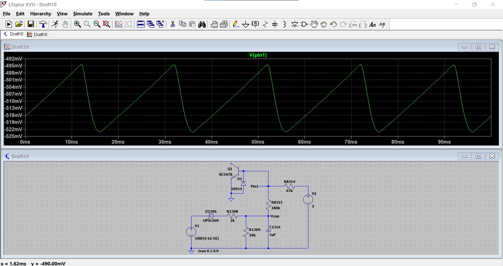

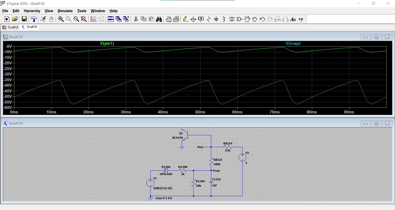

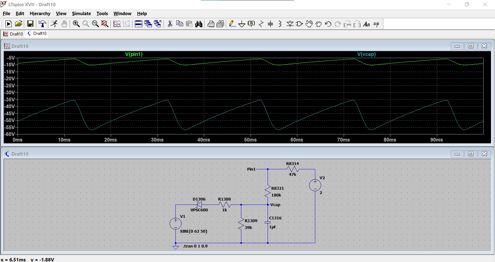

This is the setup as I see it. If you have 62 volt rails then that must equal the peak AC voltage... set here at 62 volt.
The voltage on pin 1 depends on three things which are the voltage on pin 9 is, by how much pin 1 loads the circuits and also what Q8301 is doing.
You have measured the voltage on pin 9 as being about 2.98 volts. (I set it to 2 volts... won't make much difference)
Q8301 should be off. We can emulate that by lifting the 47k to its collector so it has no influence.

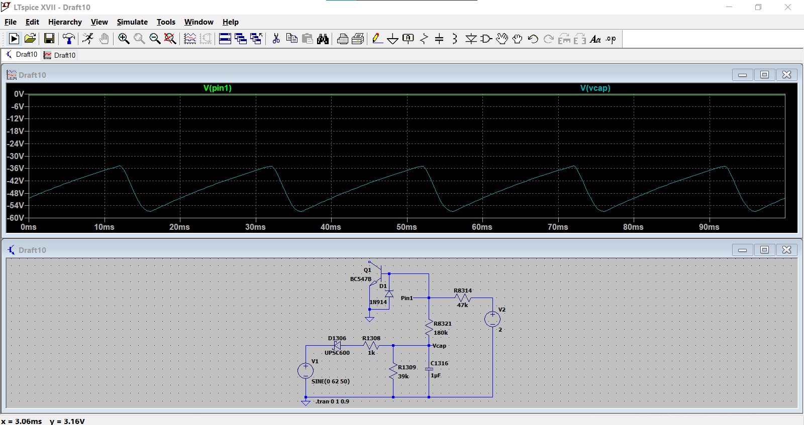

That leaves loading of the chip as the unknown variable. The application note shows pin 1 to be a base emitter junction and so that is what the second image shows.
Could there be an internal protection diode on pin 1 to prevent reverse biasing to any large degree... that's quite likely in an IC because any such situation if it occurred can turn on 'parasitic' parts and cause total non functionality. The chip might even latch up.
That's the third and fourth image image.
In an old-fashioned bipolar process, the parasitic diodes are from the NPN collectors to substrate and from the PNP bases to substrate, so you can pull an NPN base negative without turning on unintended junctions. There could nonetheless be a diode to prevent emitter-base avalanching, though - voltages below -5 V or so could otherwise blow up the base-emitter junction.
Your simulations all show that the NPN turns off as it is supposed to.
Would it make sense to repeat the R8309 lifting experiment, so to check what happens with everything else connected normally, but one side of R8309 disconnected? At least you have a circuit that should match Mooly's simulations then.
