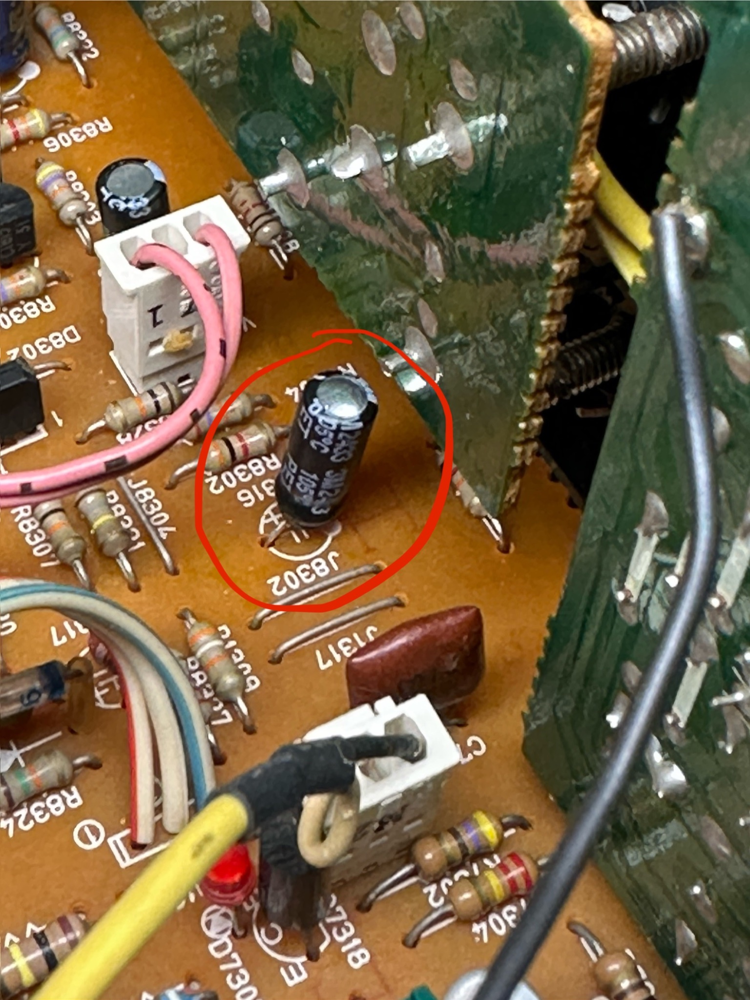

Just wanted to add a tidbit of information pertaining to the LV-105 (non ‘U’ version).
The pcb labeling for C1316 is reversed. Correct orientation is capacitor Negative leg facing the interior, Positive leg faces rear panel. The 1uF, 100V cap in the picture is toasted because it was installed following the pcb labeling.
This location has positive cap leg to ground, the schematic is correct.

That's annoying, and I have seen it with many pieces of equipment. Sorry it bit you Vunce.
These days I take many pictures before I start. When replacing caps, I mark the negative side with a sharpie as well. Getting things in turned around because you followed the service manual shouldn't happen, but quality in manuals hit the skids in the 1980's too.

Yep, boy was I bitten by this one, in more ways than you’d think. Hehe.
I picked up this unit from a neighbor and it was in terrible condition! Even infested with cockroach's! 😳 (but that is a whole story within a story)
Anyway, once cleaned up and got a good look it needed many caps replaced, protection relay, pots and switches cleaned, corrosive glue removed and affected components plus Q1301.
When all was put back together the protection relay would engage after 20 seconds the disengage shortly afterwards. Hmmm, something is wonky. Thats when I found the bad cap. Checked the schematic for proper orientation and it was incorrect. But, taking many pictures, as I always do, before anything was touched is what saved my bacon. The original cap was installed correctly which looked incorrect by following the pcb labeling only.
Anatech, you are absolutely correct, don’t blindly trust the service manuals. So far every vintage component I’ve rehabbed has errors in the SM or pcb or both. (Yamaha B-2 had many issues)
The story has a good ending though, the LV-105 sounds great! Much better than expected. This is a keeper, pushing the AU-717 out of the rack. 😉
