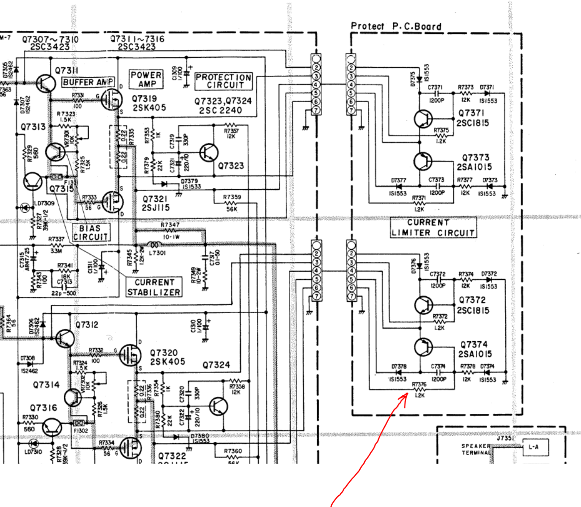

You can download the circuit diagram...
The R7376 is 1.2Kohms
Now I can see that no problem , I did look at the schematic you posted but because the detail is so small on that schematic when you blow it up it's just blur . This partial caption has far better resolution .actually would it be possible to get a shot of just the main board so its values can also be seen , it's just that one schematic that's the problem everything else on the other pages translates well . thanks so much Boky

Ok fellas , I now poses a schematic that I can read the values and have identified and replaced a few of the bad resistors , Someone has already replaced the main drivers With J200& K1529 on the failed right side but failed to find any faults caused by the mains failing . I am new to this and need a strategy , Seems all the damage was on the right channel and from what I was told and what I am seeing the left channel seems to be good . Would the next step be pulling and checking the transistors and caps on the right channel of the main board . cheers Roger
Hello Extreme Boky , the same schematics you posted I think it was in post #13 , I was just expanding them wrong , if you use your touch screen to expand them you can't read them at all, if you use the magnify tool it expands clearly .. cheers

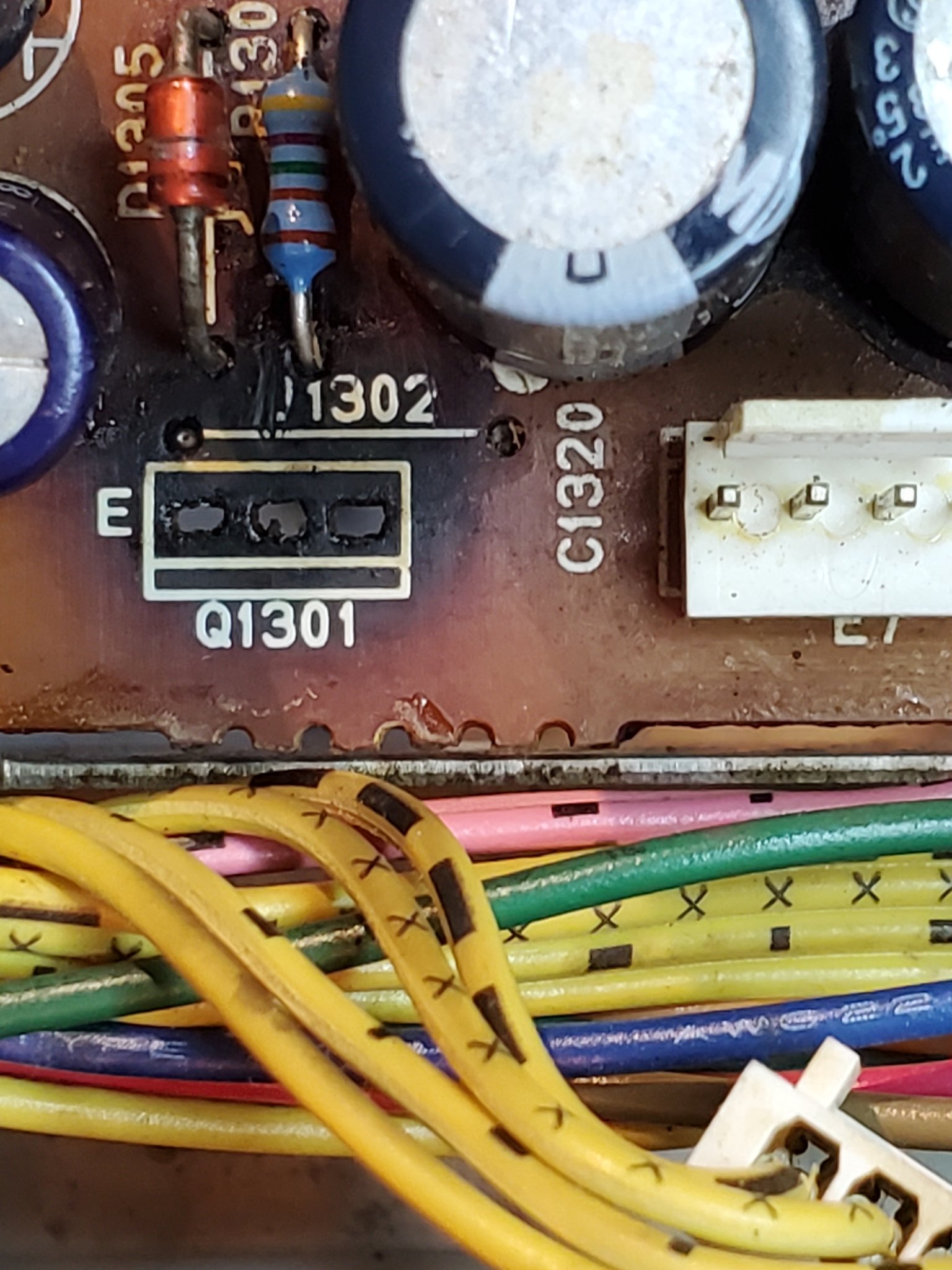

Ok guys having a bit of a problem here , I've been going through the circuit board repairing failed components and when I removed Q1301(transistor 2SD1266) to test it , don't even ask about the mangled holes.. I see beside it what I assume is a missing component , hard to read but looks like J1302 the board is showing the symbol for a jumper but when I look at the tracers on the back of the board the jumper would be jumping 2 legs of the transistor . is that even possible . The schematic does not show the placement of jumpers so I'm a bit in the dark as what to do here .. Anyone else with a LV105 that can confirm what if anything belongs in this spot would be extremely helpful , thanks so much guys ,Roger

Hi Roger,
First, confirm where the ends of the jumper end up. I don't think they would short a transistor out. Typically if they used it as a diode you would see a base to collector short in copper.
Was there solder on those pads originally? I have not had a chance to look at the schematic. But you should be able to figure this out.
