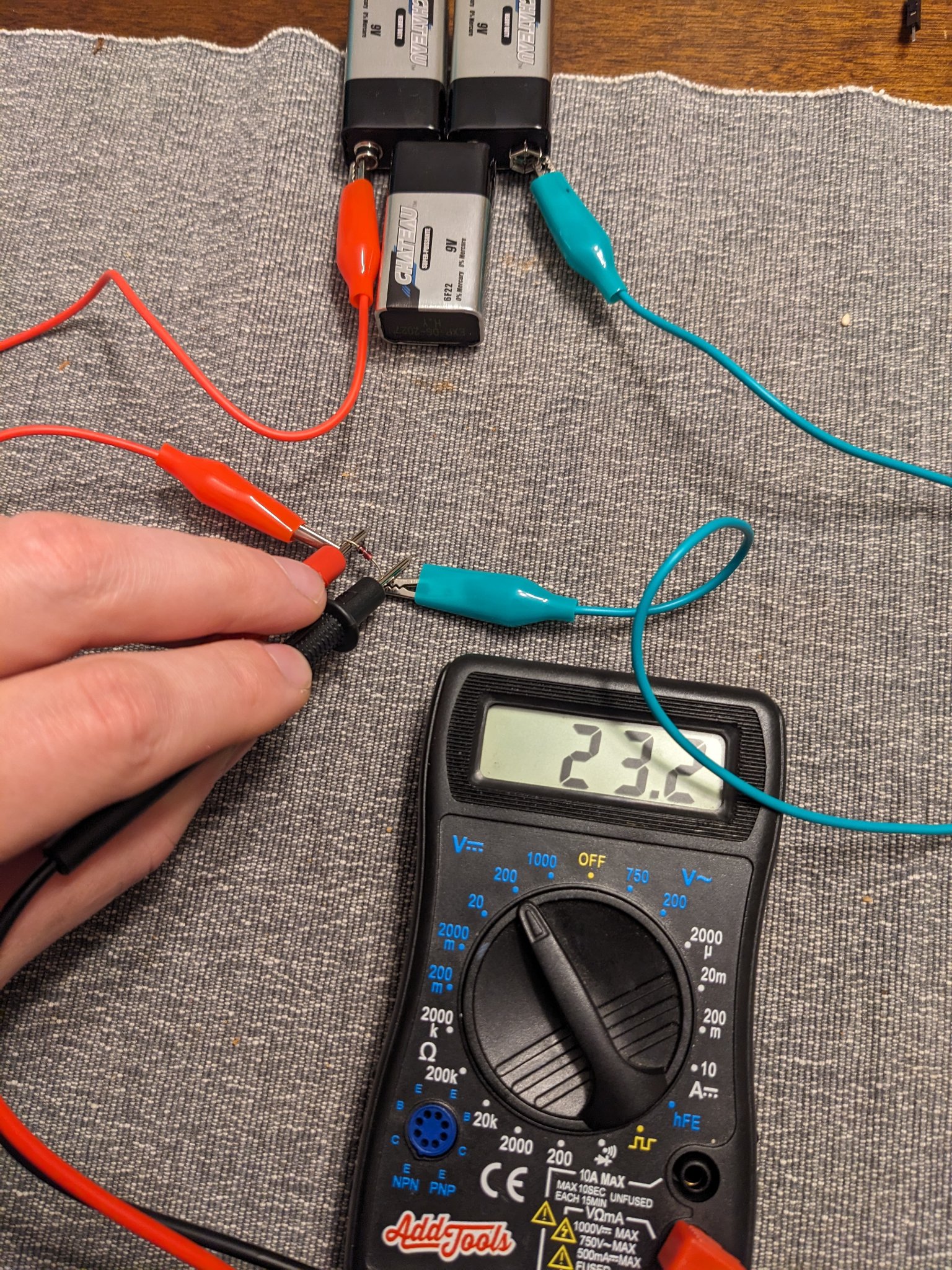

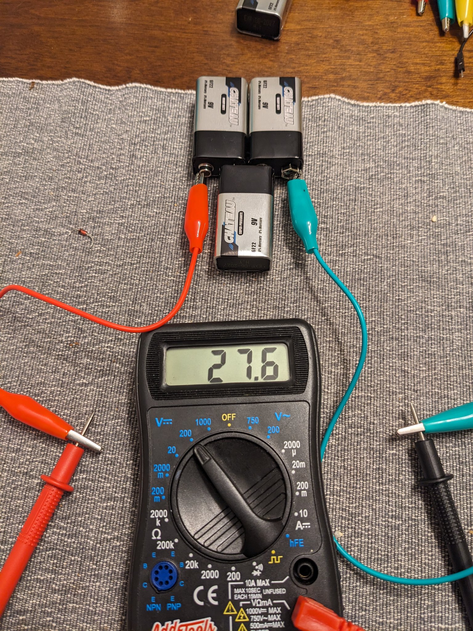

Got too much components off the board so I tested it them outside the board with this setup! Tried to test it in diode mode first, got 0.789 V and OL the other way around. A little bit higher then what you told me so decided to test load it.
Got this setup going, 3x 9V batteries in series with 1.5k ohm resistor in series to get close to the 19.25 V it's rated for. Everything seemed to be fine, reading about the same voltage drop at the diode. Then tried with something a bit more powerful, 27.6 V (no resistors) and got a reading of 23.2 V, shouldn't it be staying around 19-20 V max? Also it burned some of my plastic leads so I'm guessing it's getting hot. Could that mean that the diode failed?
Looks good
Diode looks ok, you need to be careful not to exceed the power rating, probably should be looking elsewhere, other candidate would be Q401, Q402
