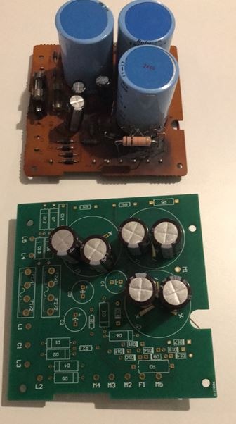

For those who are interested i tried 3x mundorf 50+50uf:
50+50uf mundorf
And tried 6x 47uf 105° Panasonic if i remember well, i selected this option: better "air flow" this way. On my design you can choose whatever you want, the holes are present for both.
The boards are the same size,it's just the way the picture is taken.
I use 30v zener 6-7mm above the board for better heat dissipation.

Dear CL34 owner, as you all know the power board of our CL34 always burn, it's just a matter of time... To solve this problem i made a new complete board with double place for the 47+47uf in order to use regular 47uf x2 instead. The board seems to be identical for all region of the world, you have to check. Someone already asked me for one so i have one left i can send to a member of this forum for a fair price, i don't care to make profit. Send me a private message with a picture of your CL34 amp and my nickname on it (to be sure it's gonna really be usefull to you) and i'll get in touch with you

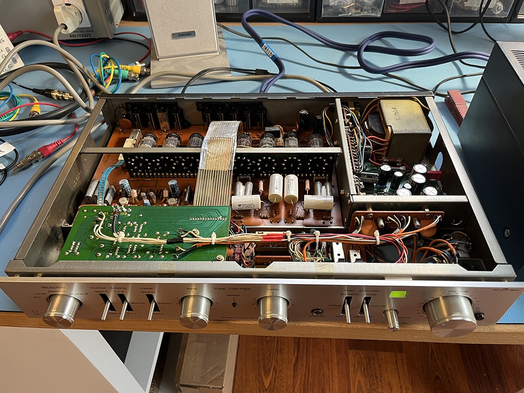

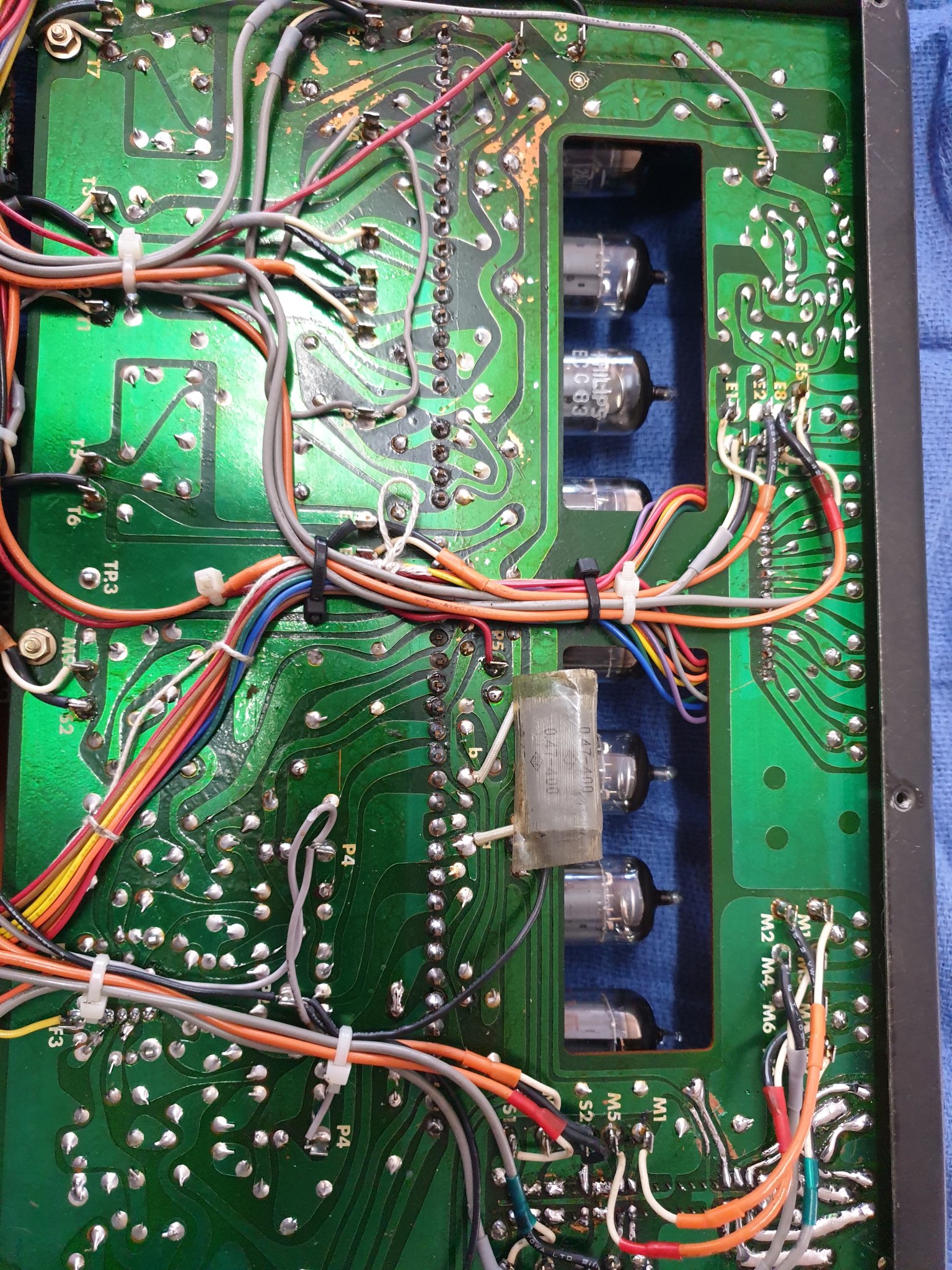

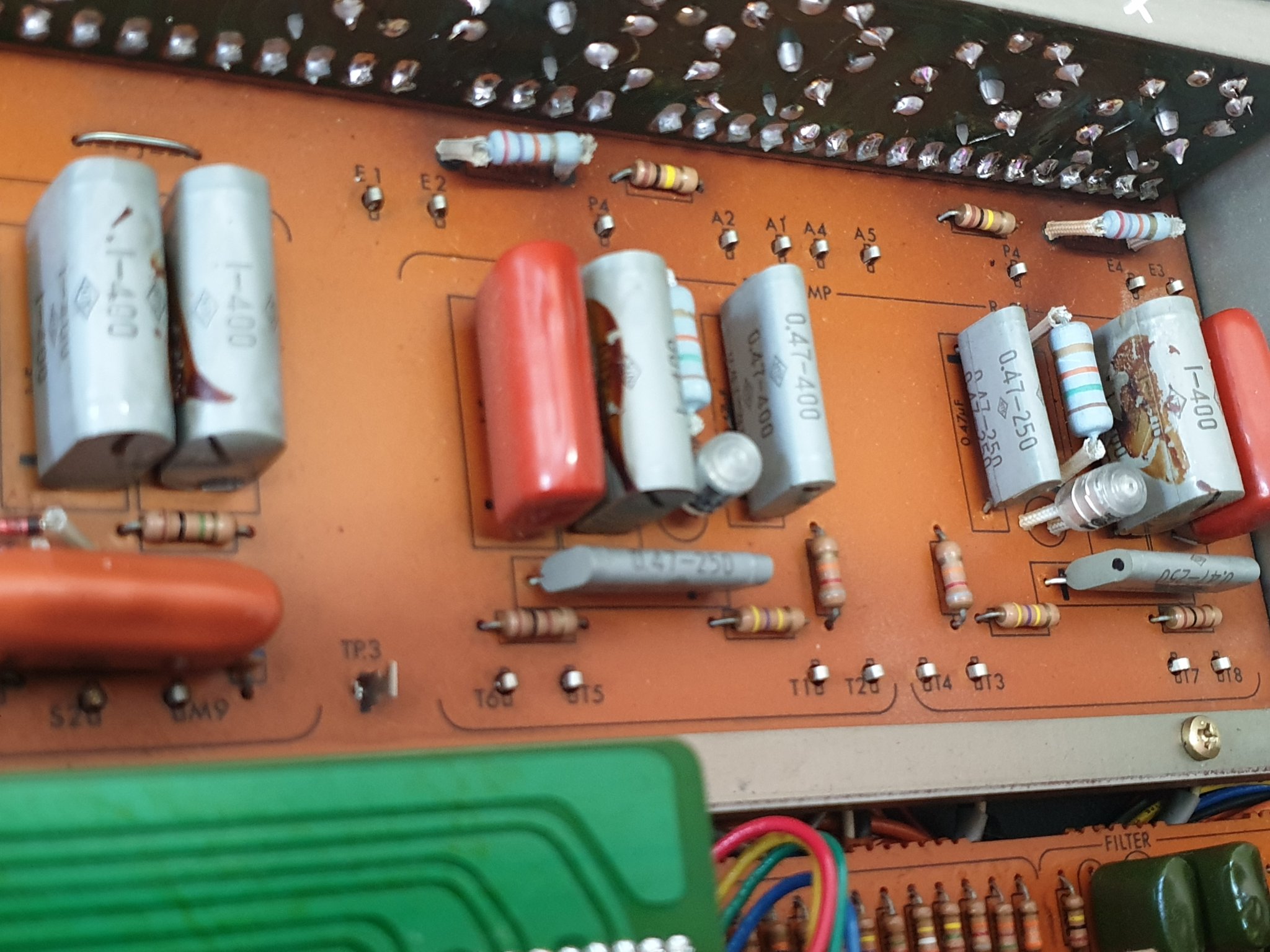

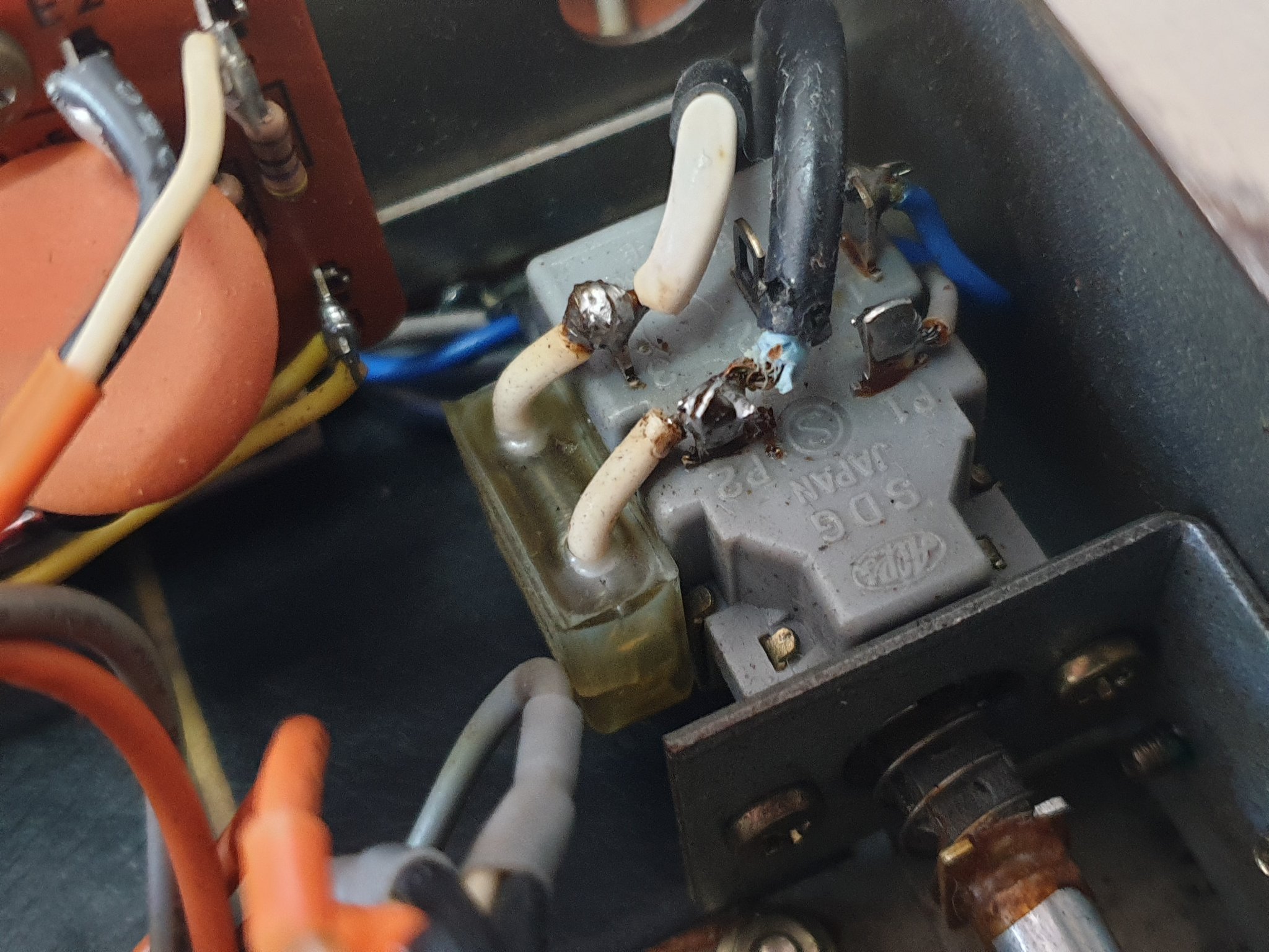

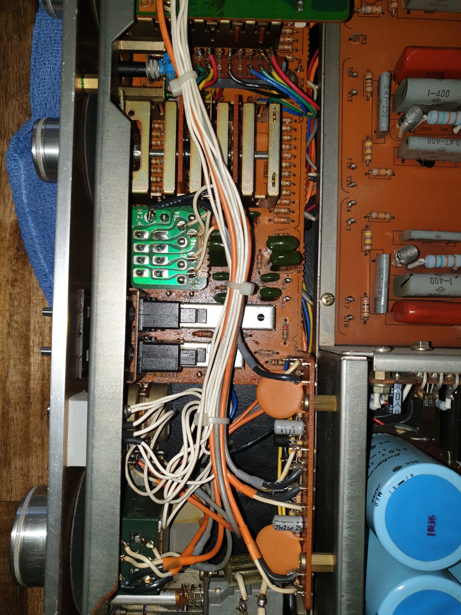

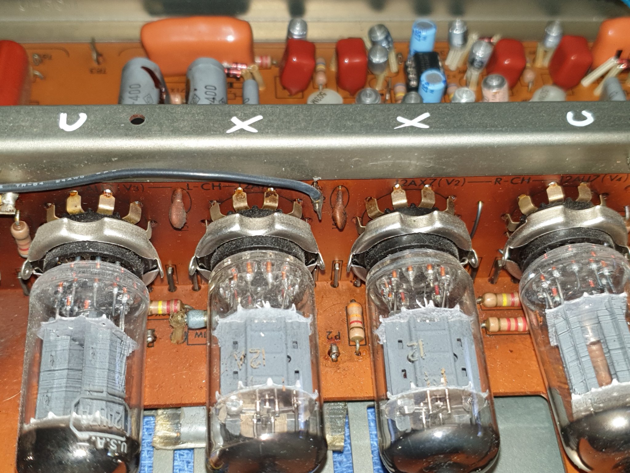

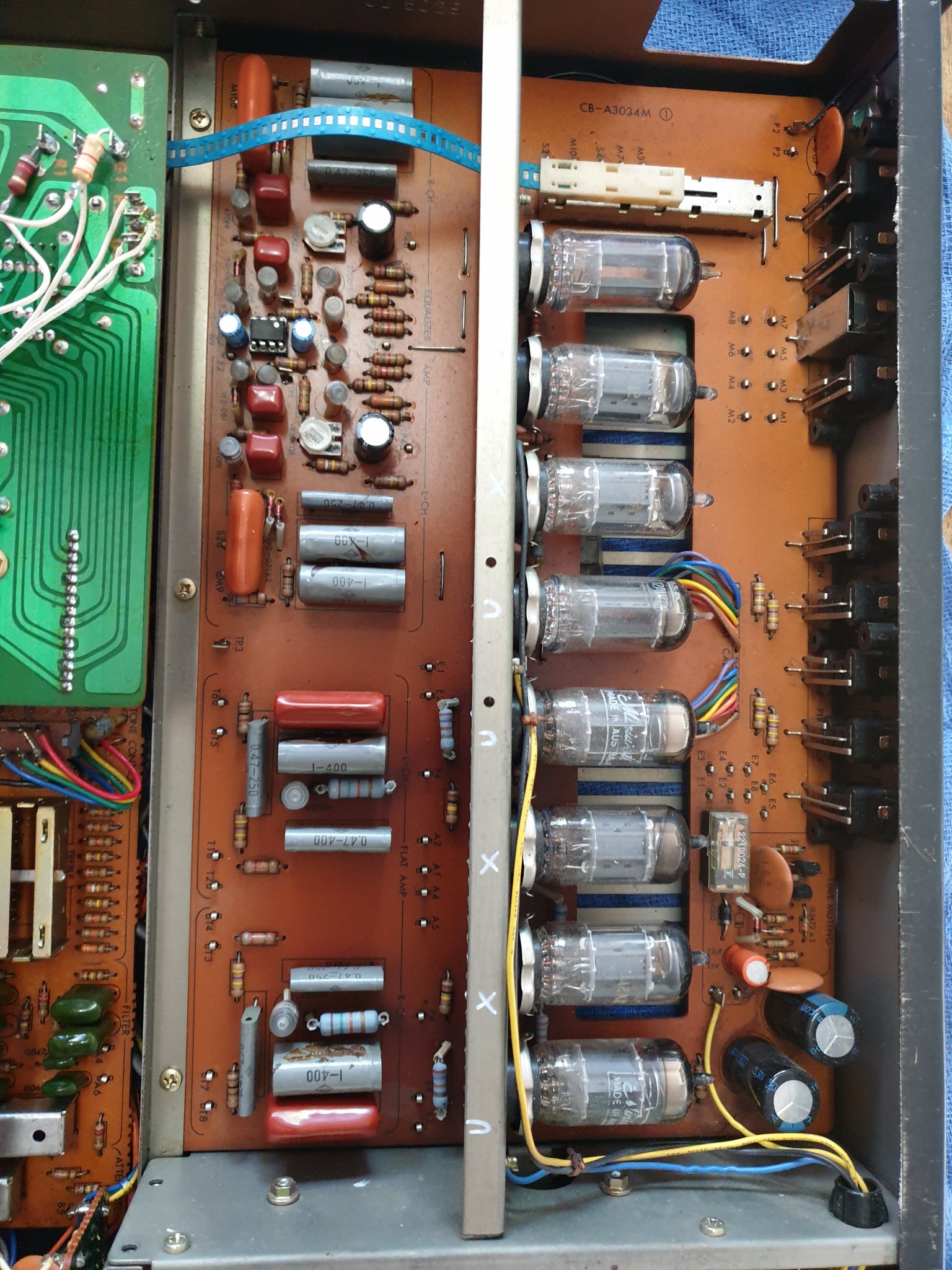

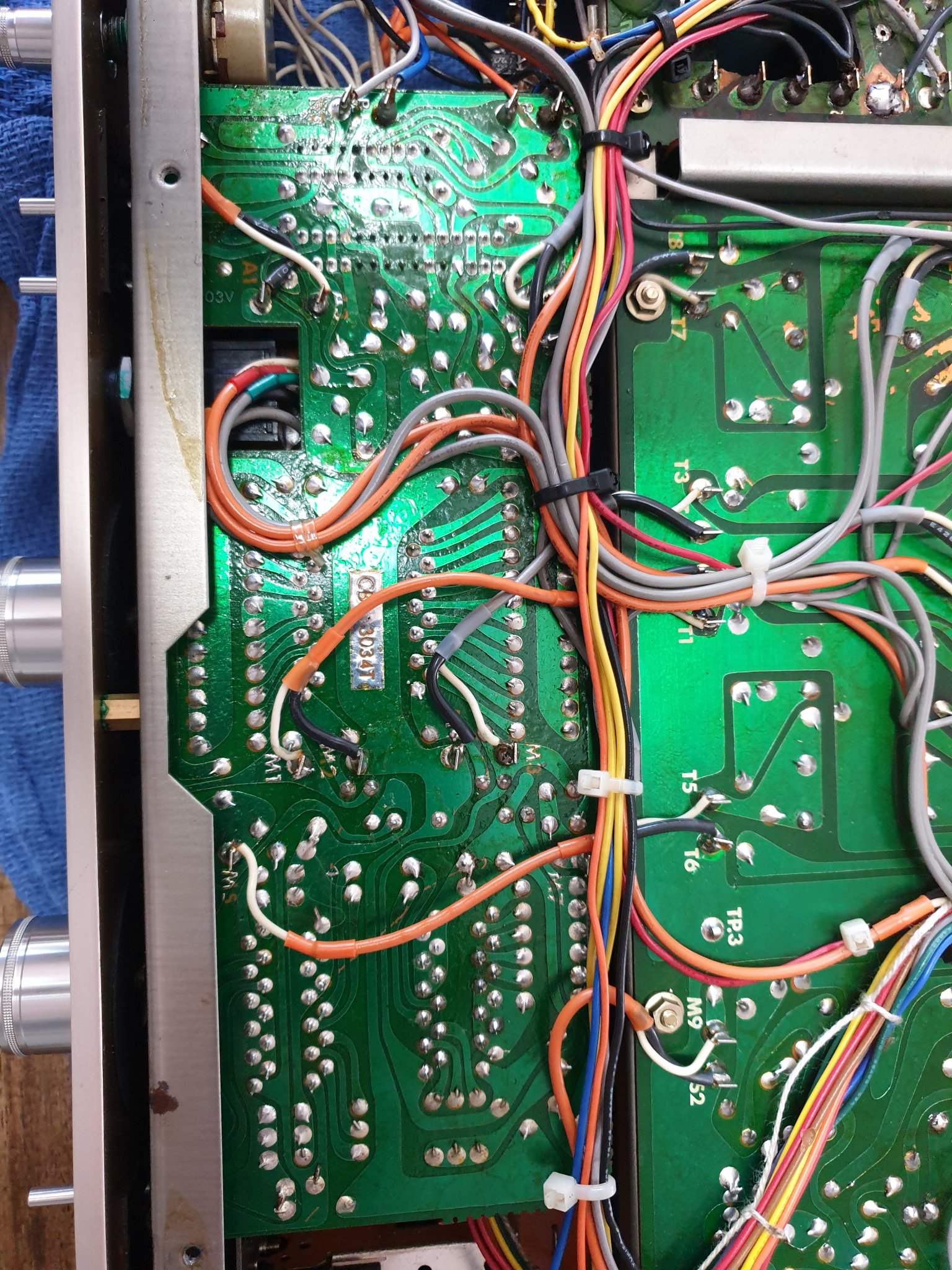

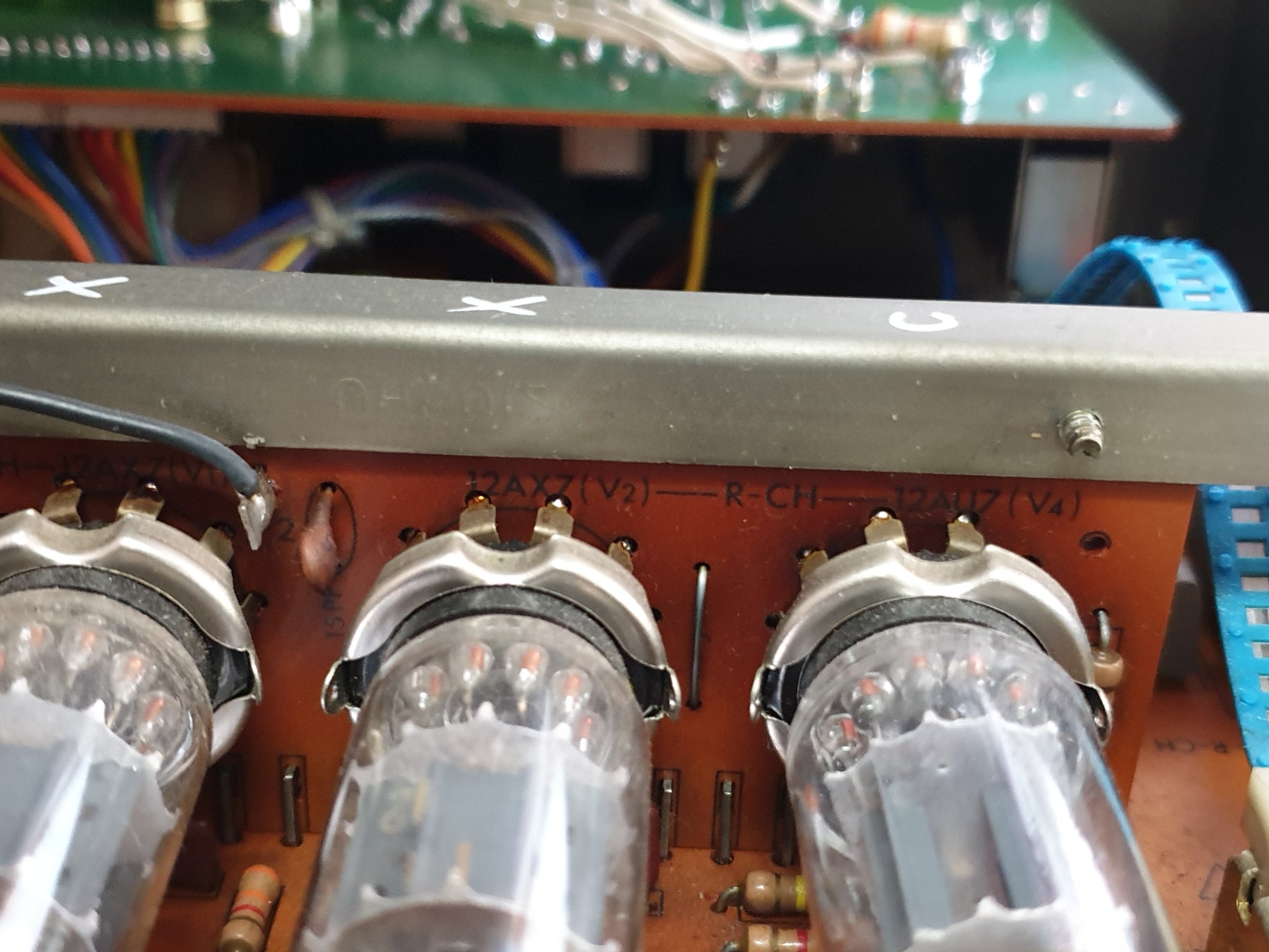

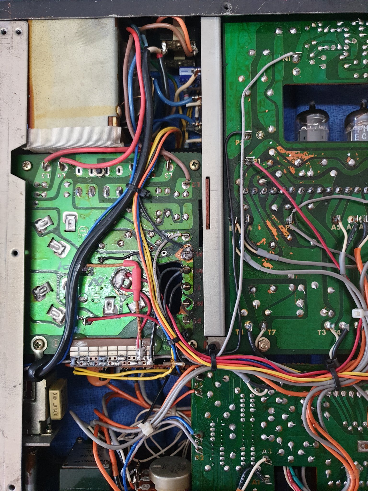

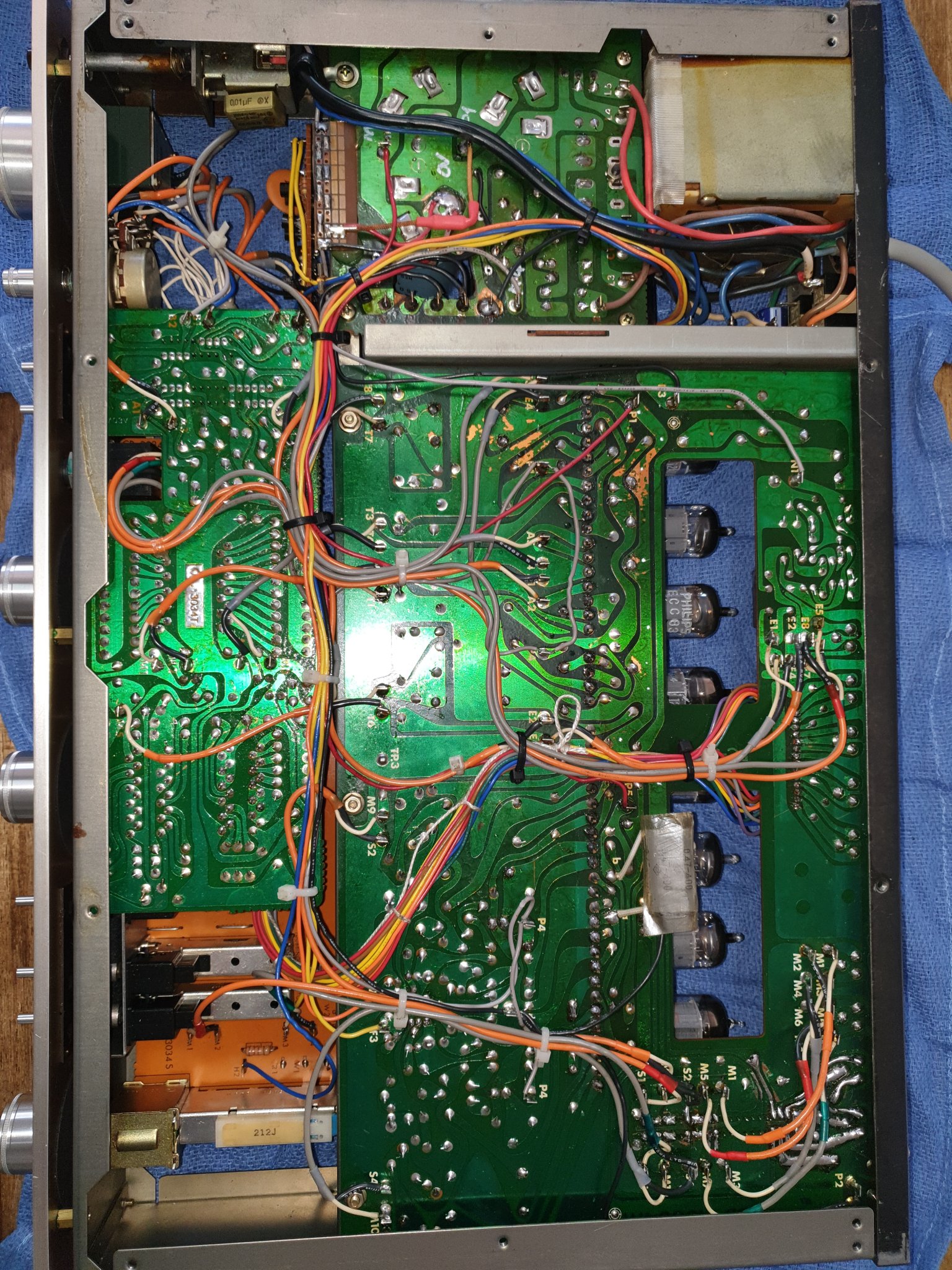

Hi everyone! Huge fan of the forum. I recently snagged a cl34 and wasnt sire if the board looks intact or if some of the board has been removed? Also any mods or upgrades would be very much appreciate. Guts shots included!

Wfm333 I have a CL-34 that I am looking to restore and am still figuring out the circuit and layout but I can give you some initial feedback on your unit. It certainly has had some issues in the past and has had some repair work done to it. The two immediately obvious things to me are 1. The large hole in the main power supply PCB and the corresponding piece of stripboard that has been added as a workaround fix. This seems to be a common problem area with the CL-34 and is presumably due to overheating of the bank of nine WZ-310 zener diodes that are connected in series to provide a 280V regulated voltage rail 2. The flexi cable that runs from the switch board at the front (dubbing, monitor, mode and pilot lamp) to the back of the main board near where the tape phono connectors are located, has been replaced by some regular stranded wire (it is in a loom with some white cable lacing tape/string). This seems to be another problem area with the CL-34 as mine has had a similar fix done in the past.

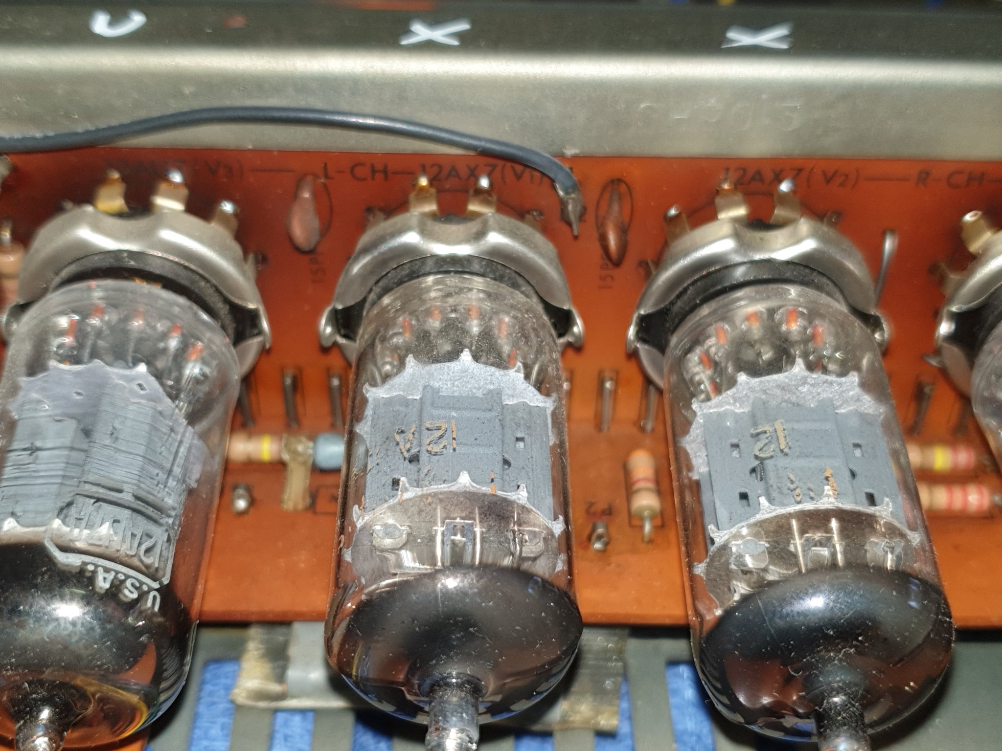

My Cl34 is running the old phillips miniwatt valves. I have a few spare new tungsols , mullard, svetlana, sovtek that i was planning on rolling too hear if there is any improvement over the old miniwatts. Most advice i have read says that v1 and v2 are the most imprtant stages to try first. Is this the case with the cl34 too? Also should i worry about biasing etc compatibility with the rest of the miniwatts or just chuck them in and go with whatbsounds best?

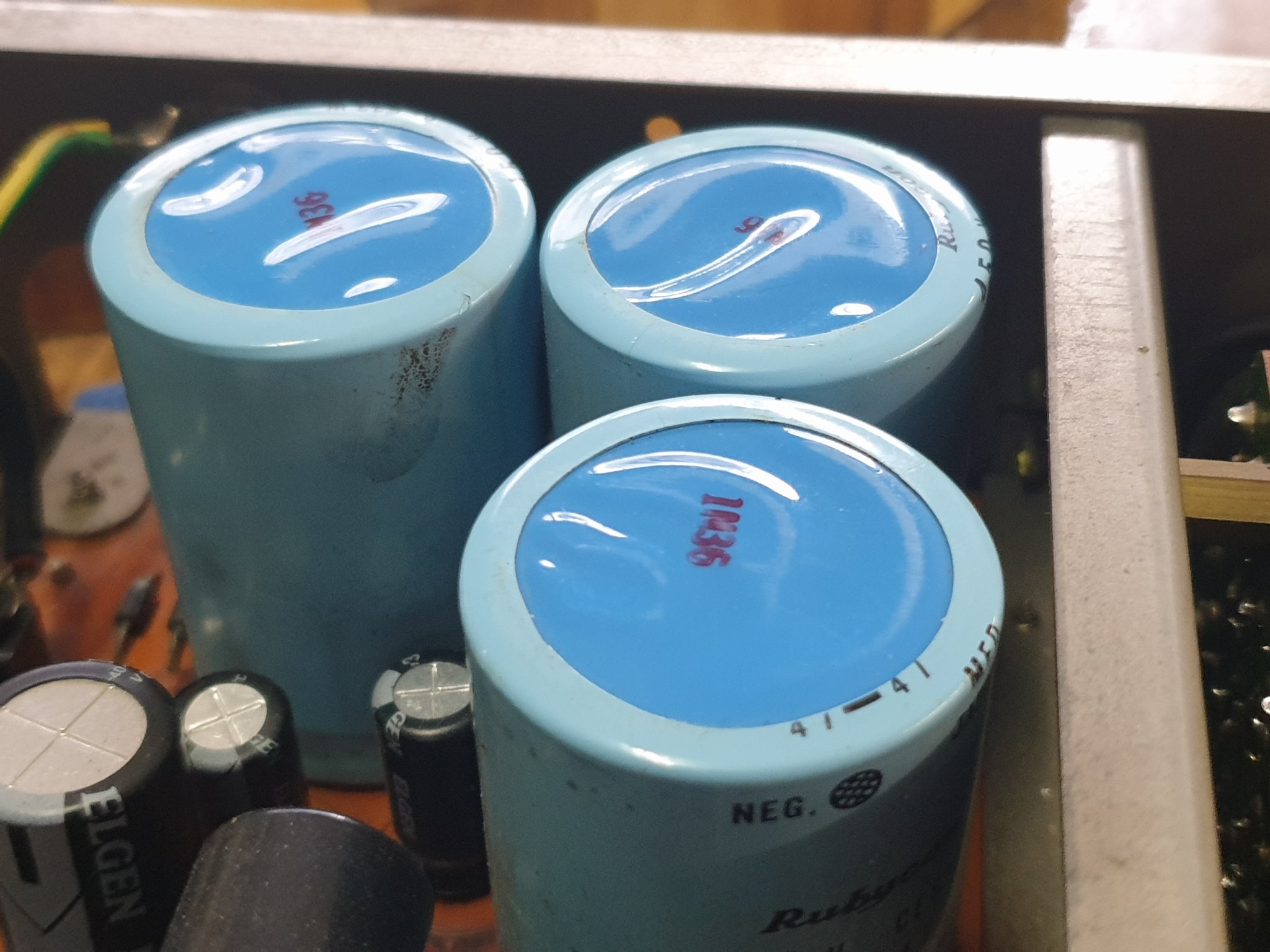

Likely just the plastic top covers are a bit warped. Best way to be sure is to look for any leakage around the seals at the bottom of the caps, and then test them for capacitance & electrical leakage. Do the leakage measurements at the caps' operating voltage.
