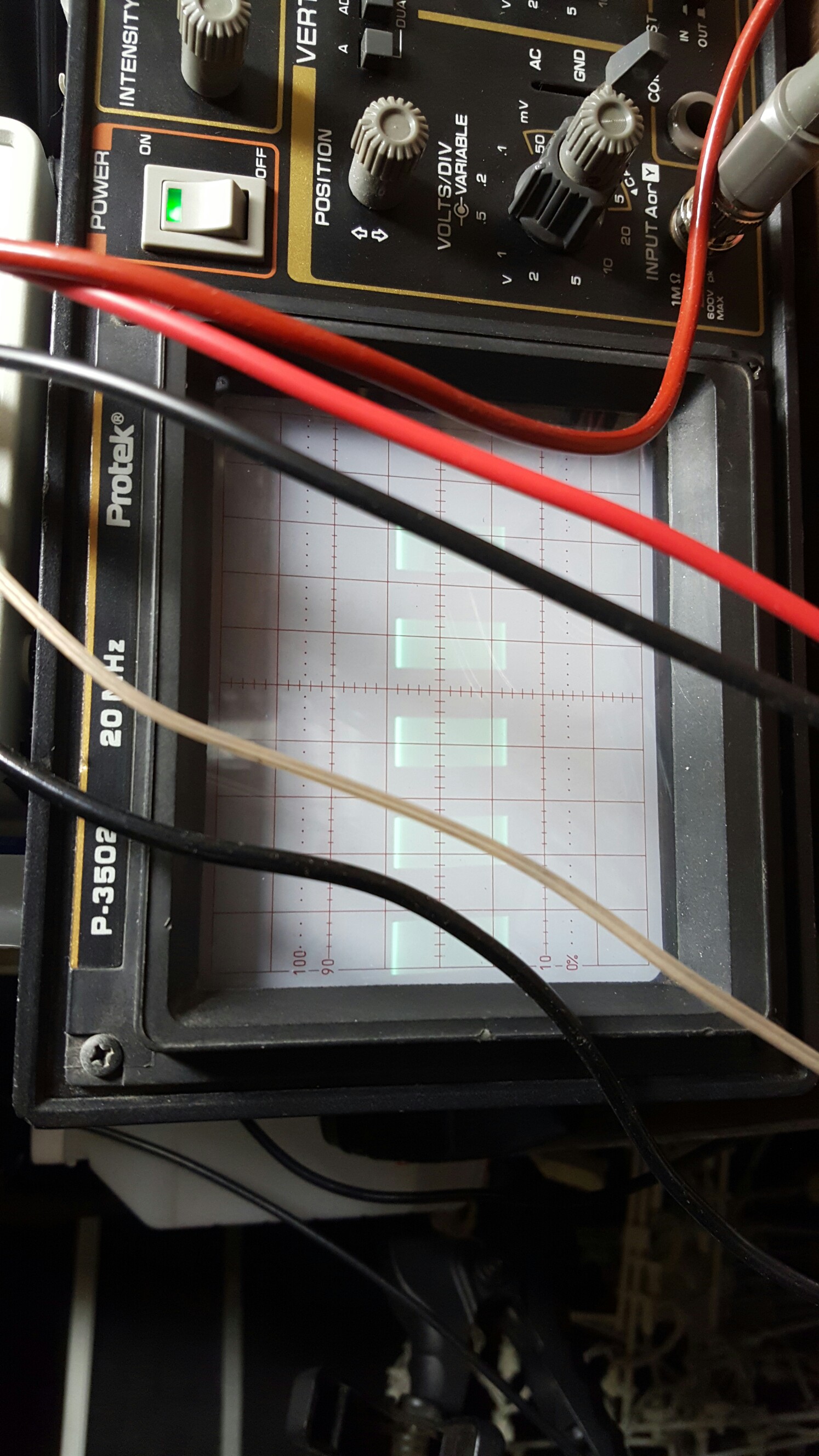

Hooked scope up and voila...there is oscillation. Images are of the top of the square wave, 500hz, .2V div, 1ms div.
Second image is with bias below 70mv. The first image showing the oscillation is above approx 200mV.
So what do I do next?
Next you'll need to find out why only this channel is doing it. Do the outputs or drivers look like they have been replaced before? Any bad solder joints in sight (especially around the output stage and the Miller cap)?
The amps output stage has not had any repairs. I have observed a few solder joints that do not look very good. Specifically one on one of the outputs on this channel, large void in the solder joint. I have not done a thorough inspection yet. Will get on that.
Which capacitor is the Miller capacitor?
Wanted to point out that the waveform is not sagging. The vertical input coupling was set on AC. Switched to DC and waveforms were not sagging.

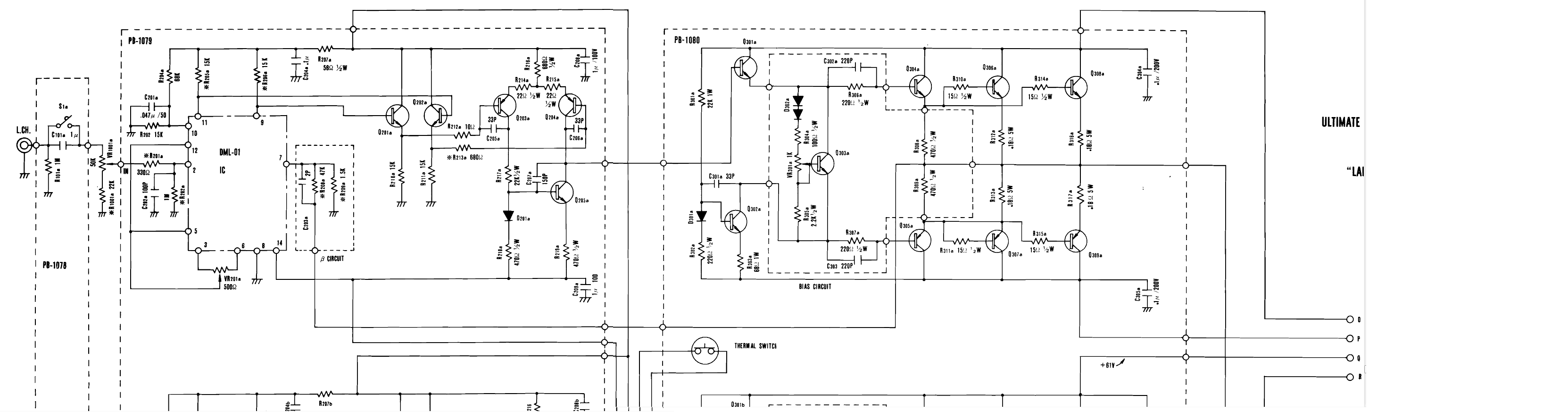

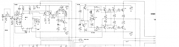

Sgrossklass, putting this out for thoughts. None of the electrolytics have been replaced. This thing has dual power supplies. Could the power supply cause oscillation? Bob
Had a look at the schematic now. The decoupling caps are all film caps, those are not too likely to fail - though it certainly is possible. If you've got some 100n and 1µ film caps rated at least 100V that you could hook up in parallel for a test, that would certainly be worth a shot. (C208/209 are 1µ, C204 is a 100n, as are C304/305. All kinda small. There's also C201 which is a 47n.) If the DML module had been removed, what about C202 (100p)? Also inspect the ground connection to the boards in question.
You'll also want to inspect the Zobel network, R512 (4.7R 5 W) and C505 (220n).
I don't think you'd see high-frequency oscillation like that if some of the big 15000µFs were shot, though the power supply certainly is seperate for left and right channels. If your scope will support a good +/-60 V when AC coupled (or maybe when using a 10:1 probe), you could look at supply ripple for both channels and note down how much you see on positive and negative rails.
Interesting, the (bypassable) input caps are a pair of antiparallel tantalums. Would be interesting to know how leaky those might be these days. I guess the idea was that they should last a long time, so the designer didn't trust regular low-leakage electrolytics, and the antiparallel circuit would eliminate a lot of the distortion (tantalums are pretty crummy). Why they didn't use films in the first place is anyone's guess.
For a fun exercise, you could run a resistor of at least a megohm from the nearest convenient negative voltage supply to the midpoint between the tantalums for each channel, that should reform 'em.
