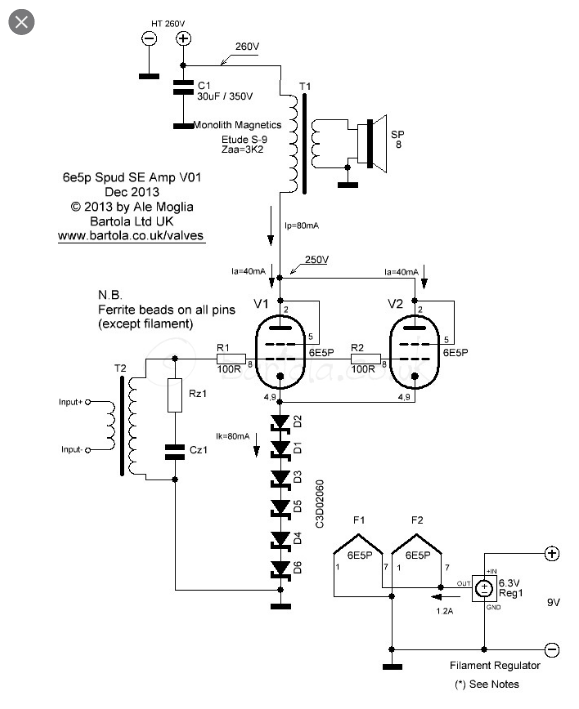

Most of my cans are planars, which are very power hungry. I'm going to wire these for push pull using 6e5p
I was originally going to use these with the 45, but then I heard the 6E5P, somehow I like it better than the 45 (I can't believe my ears lol).
I am currently listening to a 6e6p-dr spud amp. Salas High voltage shunt supply, parafeed (obligato caps) and 10k - 300r - 32r. 180v on the plates, CCS loaded with ixtp08n100d2 cascode (really really simple little circuit), and diode bias.
I think it sounds amazing. Testing on the scope, its wonderful.
The 6e6p is a wonderful sounding tube, so full. I have a/b with the siemans d3a (180v, 22ma) and the 6e6p is my favourate, slightly full mids. The d3a is wonderful up top... but the 6e6p wins out. and its £3.

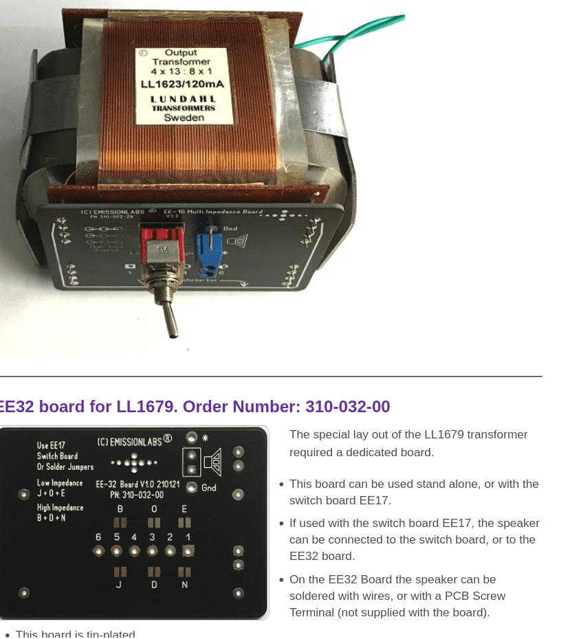

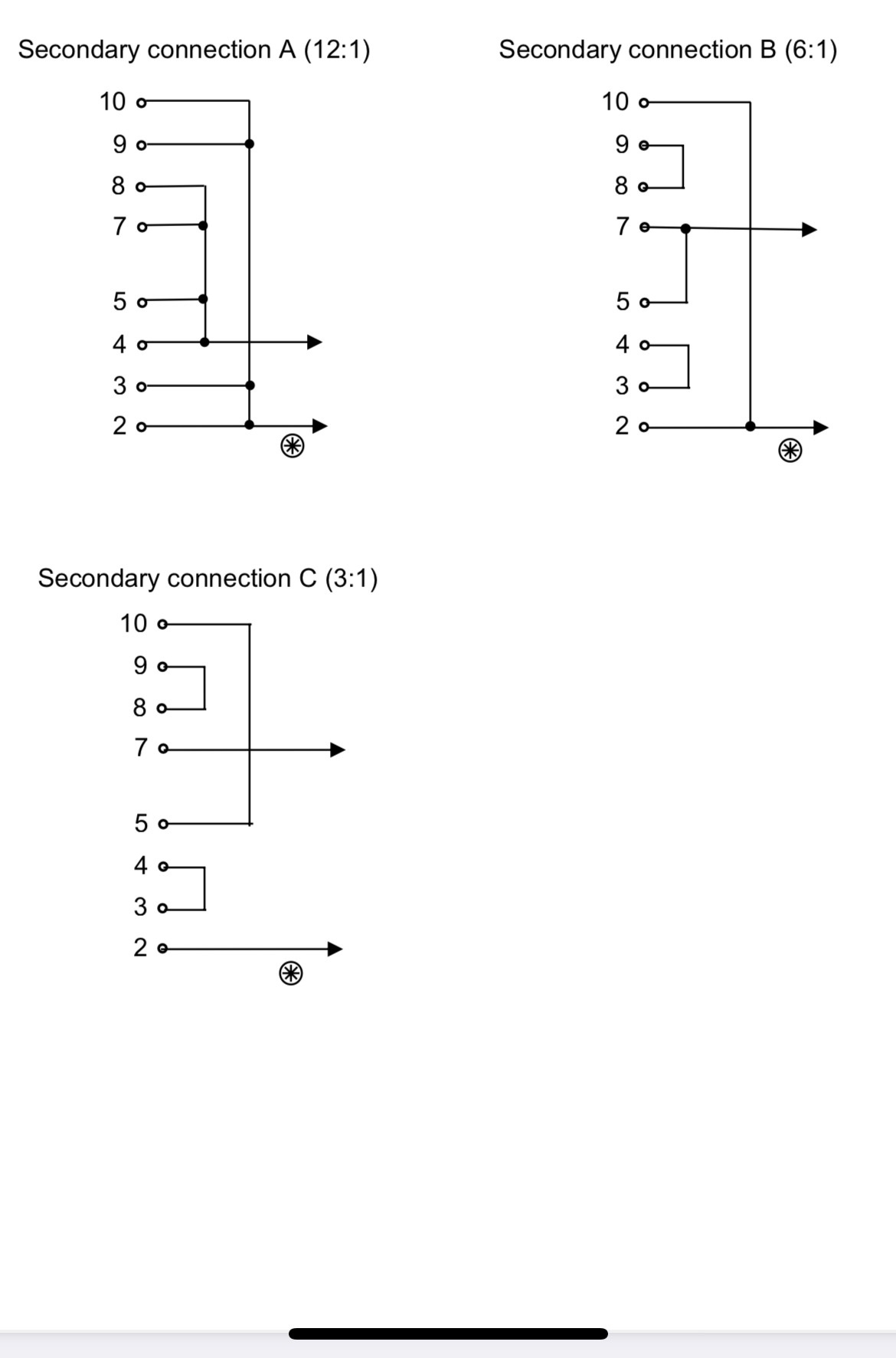

Hello all, I am toying with the idea to make a headphone amp. For the better sake of me looking at the LL2765 output connections, I can not imagine how to do it with one switch. This means that if I want to switch between two headphones with impedance of 50 or 600 ohms I would have to resolder the wiring, use some kind of ugly jumpers or some clever scheme with relays. Is there anyone who is seeing what I am not?
Thank you in advance.
Work backwards from the voltage your 600 ohm headphones are going to want, then make that available on a lower winding configuration on the OT. This will make the noise floor more reasonable as well. The transformer is rated to put out 13V on the secondary when configured as a 4.6K:32, do you have 600 ohm headphones that could make use of that much voltage? (that's 300mW into 600 Ohms, hot!)
Maybe I did not express myself. Look at the data sheet of LL transformer. How one can switch between different configurations without soldering and dissoldering. I do not see a pattern. do you
Why do you want the lower ratios to begin with? If you want to accomplish that switching, you will need a substantial rotary switch. From all the tube headphone amps I have made over the years, I can tell you that the 5K:600 configuration is very likely to be a total waste of time.
Maybe, but the transformer is made for that and why not use it… I guess I can live with one but it is a question of principles and OCD in me 🙂
You are going to spend a ton of time and money to have a "noisy" switch on your headphone amp. Provided you can put close to the full 160V RMS into the primary of that transformer, there is absolutely no point to the 600 ohm winding configuration.
