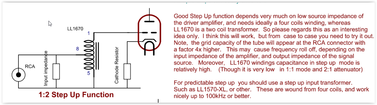

step up idea-- grid choke this way should be driven by low impedance; my gyrator scheme in page 2 will fit.
60€ a pop....
http://www.lundahl.se/wp-content/uploads/datasheets/1670.pdf
