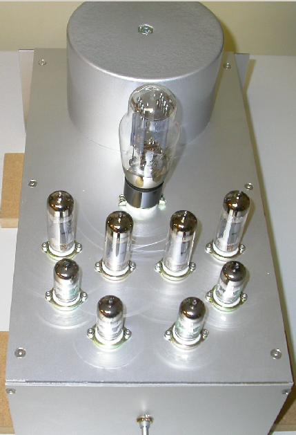

Lundahl+EL84 PP+concertina+input stage
The HT will be hybrid, the filaments will be DC driven.
Meantime, the Fostex FE127 single drives have arived. I want to use this amp with the Fostex speakers. Well, it is kind of "late" question, but is the BV sufficient for the Fostex speakers?
trif.
The electronics is done by my colleague.
The amp is evolving and I am learning a lot...from him.

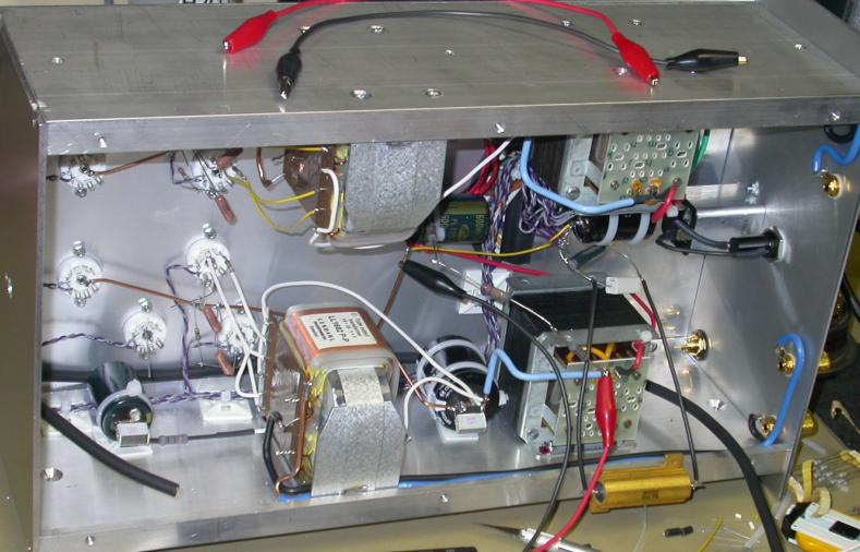

If I see well, you have only one ground wire going to each filter capacitors. I'll suggest you to wire them step by step, as shown on the schematics, from transformer and rectifier to the cap, from the cap to the chocke to another cap together with the ground wire, and so on. Ground wire is actually very loong in terms of big currents and small signals, so ground near the rectifier and/or power transformer is completely different ground wire than near the input socket!

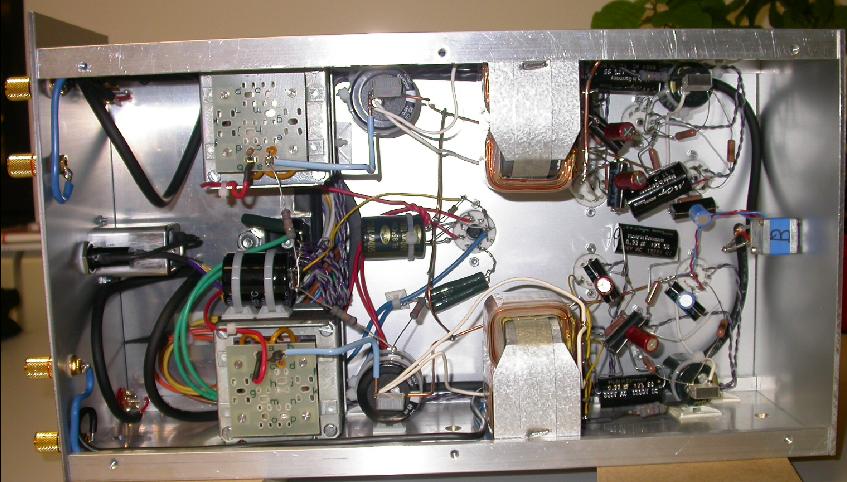

Yesterday Thomas could finish the building of the amp, and
we turned ON the amp - BIG MOMENT.
Note: No GLOBAL feedback is implemented yet.
Both channels worked! 😀 😀
Thomas checked the voltages, and all values were as planned.
And we started to listen to the amp with several CDs,
and at the certain moment we have observed CLIPPING - the input stage was CLIPPING.
Paralel to the cathode rezistor one mkp and one elko cap were mounted.
We have measured with the scope the signal - coming from the CD player (Philips CDR570) - and it had 2.8 V high peaks
Note: we do not know if this is normal for a CD player.
The plate current of the input stage at this point was 14.5 mA and the grid voltage was slightly negative but surely no enough for such a high input signal.
So, we have changed the cathode and plate rezistors, and the plate current became 4.5 mA, and the grid voltgae became -2.4 V. We have removed the cathode capacitors/per channel.
Certainly the clippind was reduced - but still audible with some CDs.
BUT the sound became completley unacceptable: it was more tight, no spaciness, kind of dry and woody sound. Installing back the cathode capacitorss the sond became more acceptabe, but still not good.
Finally we put back the original rezistors for the plate and the cathode.
I have learned: more inputstage anode current has a nicer sound, and the cathode capacitors have also nice effect on the sound.
Lower plate current has a tighter sound. The input stage has VERY BIG effect on the sound.
Any suggestion(s)???
Thoams and trif.
At this moment I like to hear from you gens what do you think about my observations.
Actually, I am used to listen to my studio monitors - Dynaudio 2.1 system what just sound very good for many different type of music. The frequency response in my room is +-3dB. So, I have something good to compare my tube amp.
But I am not that stage yet, since the sound what comes out from my PP tube amp is far from what I like to have.
Why is the higher plate current better sounding compared to the lower one? (14.5 mA compared to 4.5 mA)?
Why the caps installed paralell on the input stage cathode rezistor sound better?
