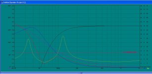

So, you're looking for 120dB max with a low frequency limit of about 100 Hz? B&C 8NDL51 in a 0.3 cu ft vented box tuned to 60 Hz. Input is 400 watts. Obviously, a subsonic HP filter is required to control driver excursion. As you can see -3dB is about 90Hz. You'd need to pair this with a horn tweeter of course. At 200 watts, it produces about 117dB. That should be loud enough for anyone. I have these in my home satellite speakers. I'm not saying they are the best.... just another possible choice.
