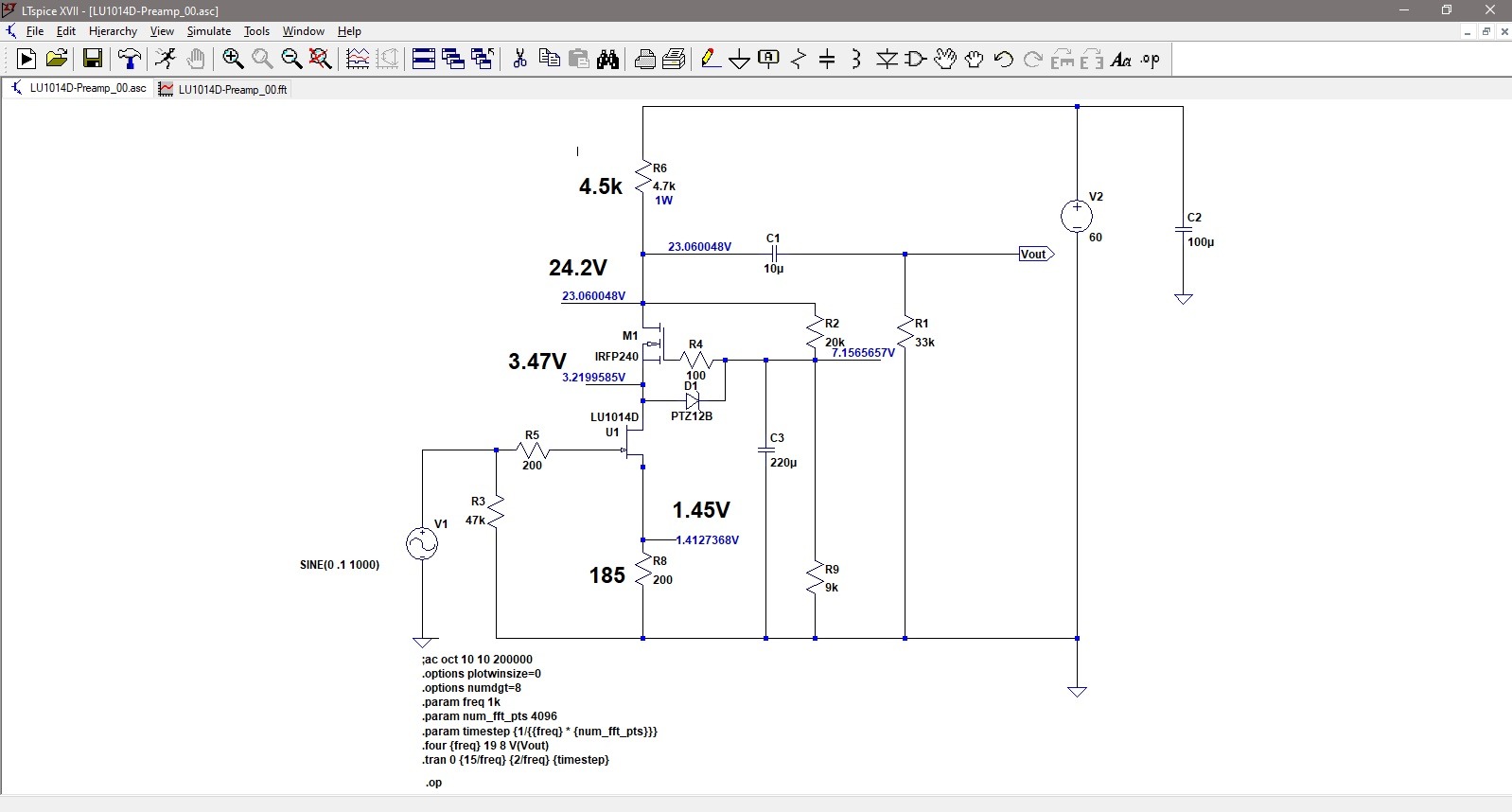

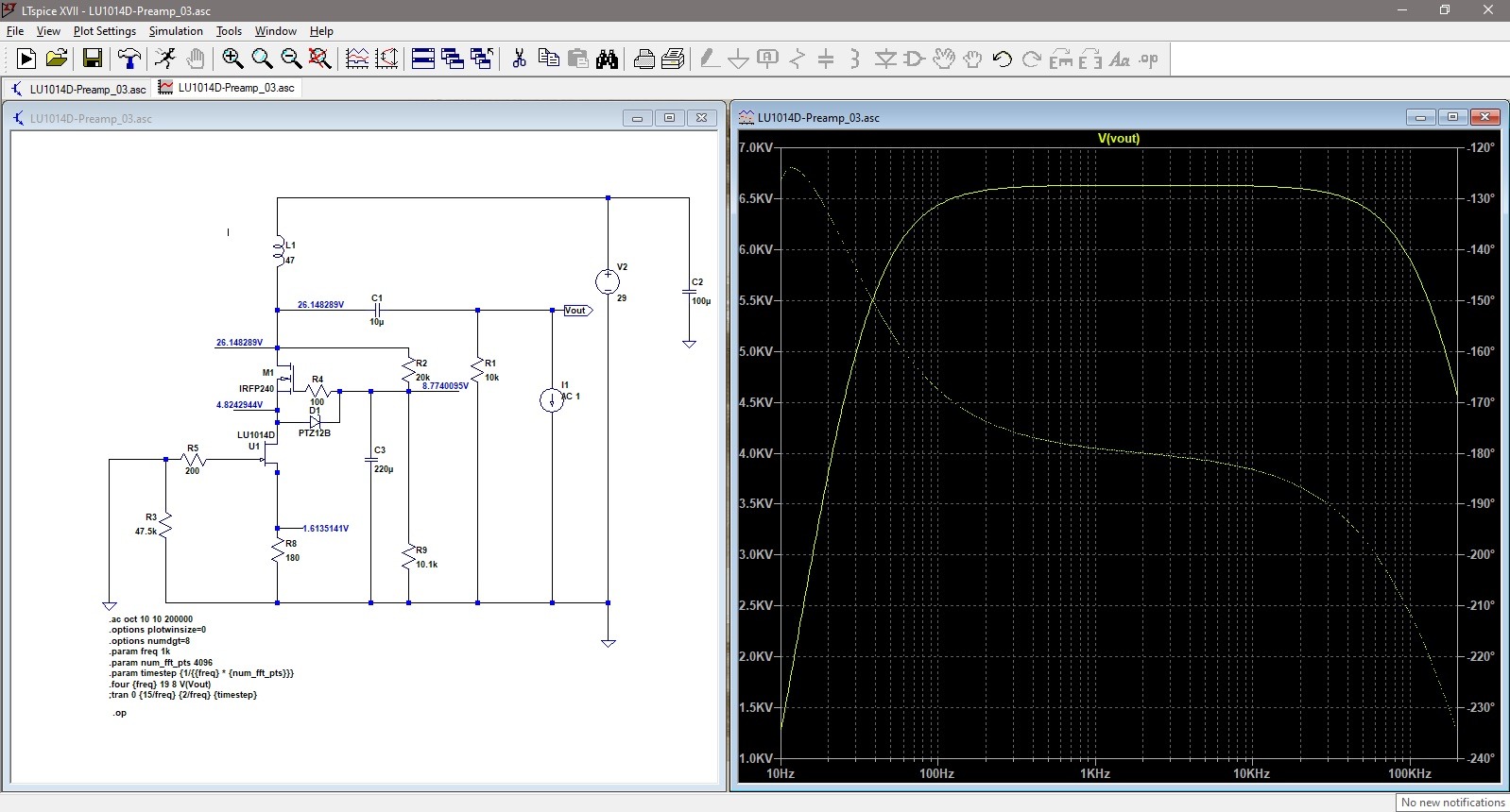

I fired up LTspice and sticking with the cascode approach and inductor loading, I played around with different power supply voltages and operating points. High voltage and low current seemed to work, although I encountered a problem with increasing gain above 10 kHz. The inductor loading was not working out.
I replaced the inductor with a resistor and that smoothed out the frequency response. I ended up with LD1014D Vds of 2.0V and current of 11mA.
The next issue is the high output impedance, around 3.5 kohm. That can be handled with a output buffer, so maybe not such a big deal.

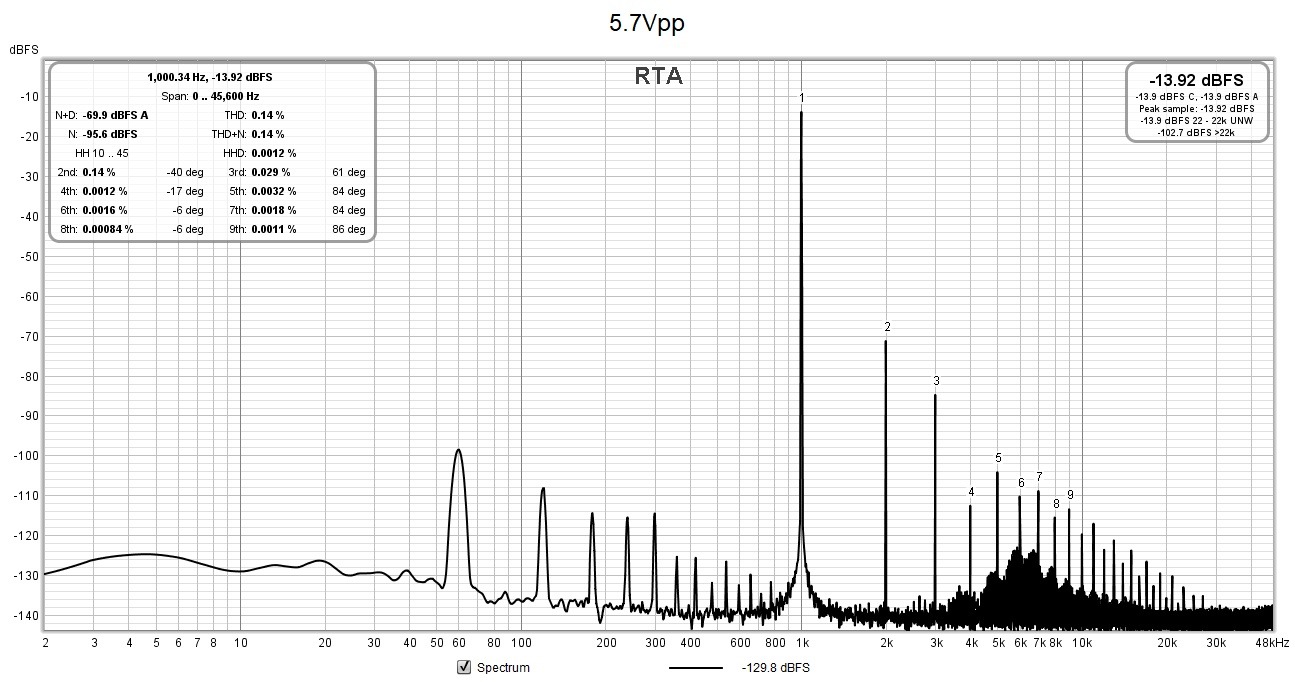

I remembered that I have some high inductance Hammond chokes somewhere which could be suitable as load for a high output impedance amp. These Hammond 156C inductors are rated at 150H at 8 mA and have a DC resistance of 3700 ohms. I could replace the 4.7k ohm load resistor with a Hammond 156C and the DC operating point would not change much.

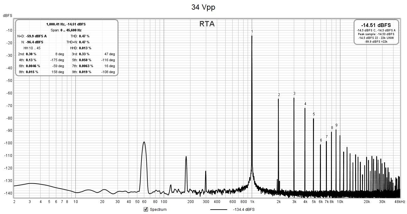

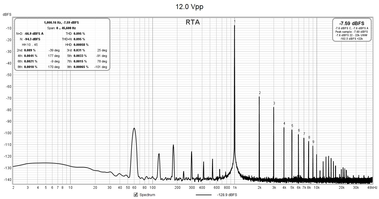

So, I made the change and ran some tests. Distortion dropped considerably which was no surprise, and gain went up. Again, no surprise. Distortion dropped to about 1/3 of the resistor loaded circuit and gain increased to about 15x.
I tweaked the operating point a bit, and ended up with the LD1014D Vds = 2.48V and 8.5mA. The voltage after the inductor was about 25V.

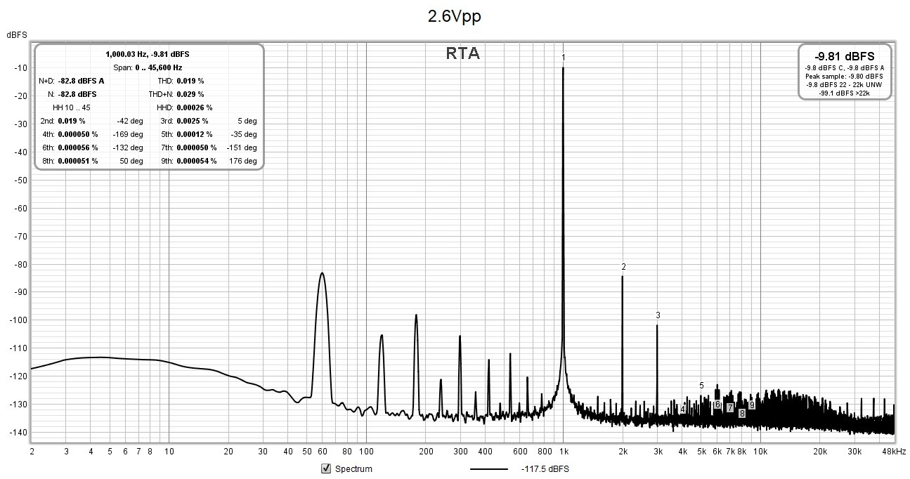

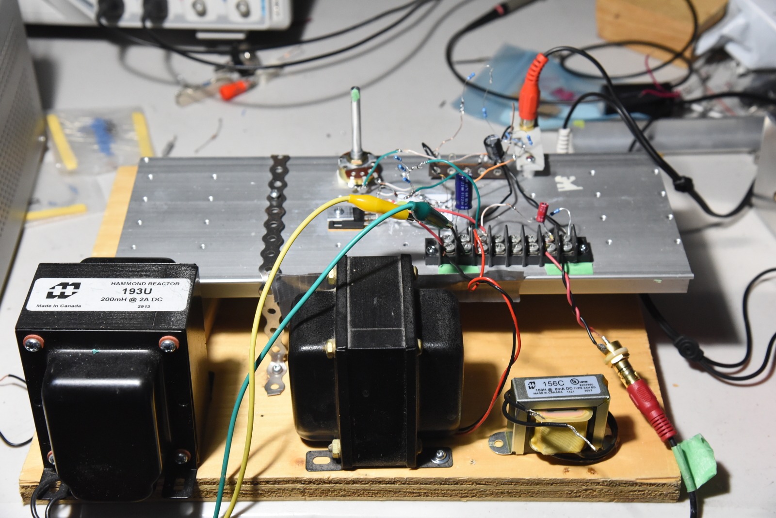

Another set of inductors emerged out of my memory banks. These are a pair of chokes wound by the late Mike LeFevre of Magnequest fame. I had used them in a pair of parafeed 45 SET tube amps. These amps were just breadboarded on pieces of wood so I dismantled them when I discovered VFETs. I've already re-used the interstage transformers in my 2SJ28/2SK182ES transformer coupled amps.
I couldn't remember the inductance of the chokes but they are rated for 60 mA and have DC resistance of 290 ohms. I connected one of the chokes in series with a 100k ohm resistor and with a variable frequency oscillator, determined that at 345 Hz, the choke's reactance equaled 100k ohms. That works out to an inductance of 47H. This is with no DC, so the value may vary with current, although in this preamp test, the current is only about 9 mA.

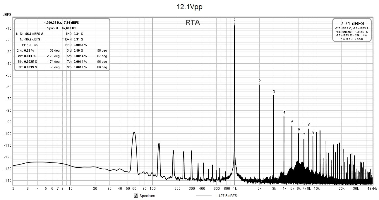

Any any rate, I threw it into the preamp circuit, tweaked the cascode a bit and made some measurements. The DC voltages actually matched the LTspice simulation quite well.

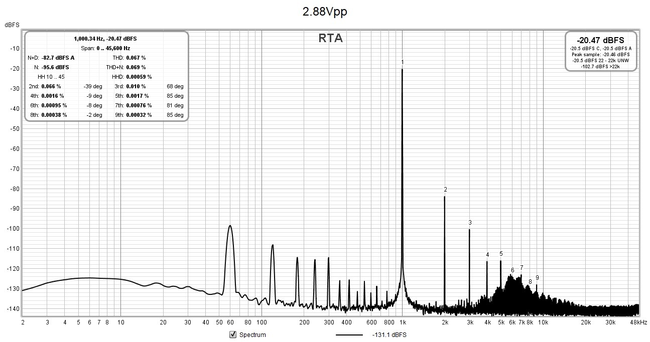

In terms of performance, distortion at low output is about the same as the small Hammond, but definitely an improvement at 12Vpp. I also upped the output to 34Vpp and that produced a THD of about 0.5%.
Frequency response was down about 1 dB at 20 Hz and about 0.5 dB at 20 kHz.
I modeled the output impedance in LTspice and the calculations show about 6.5k ohms. I will perform a measurement on the actual preamp to see what it is for real. However, I don't expect a huge difference since the low current LD1014D operating point is in the area of the characteristic curves where they are just starting to bend upwards.
I've included a photo showing a Hammond 193U and a 156C along side the Magnequest choke for comparison. The Magnequests are not small.

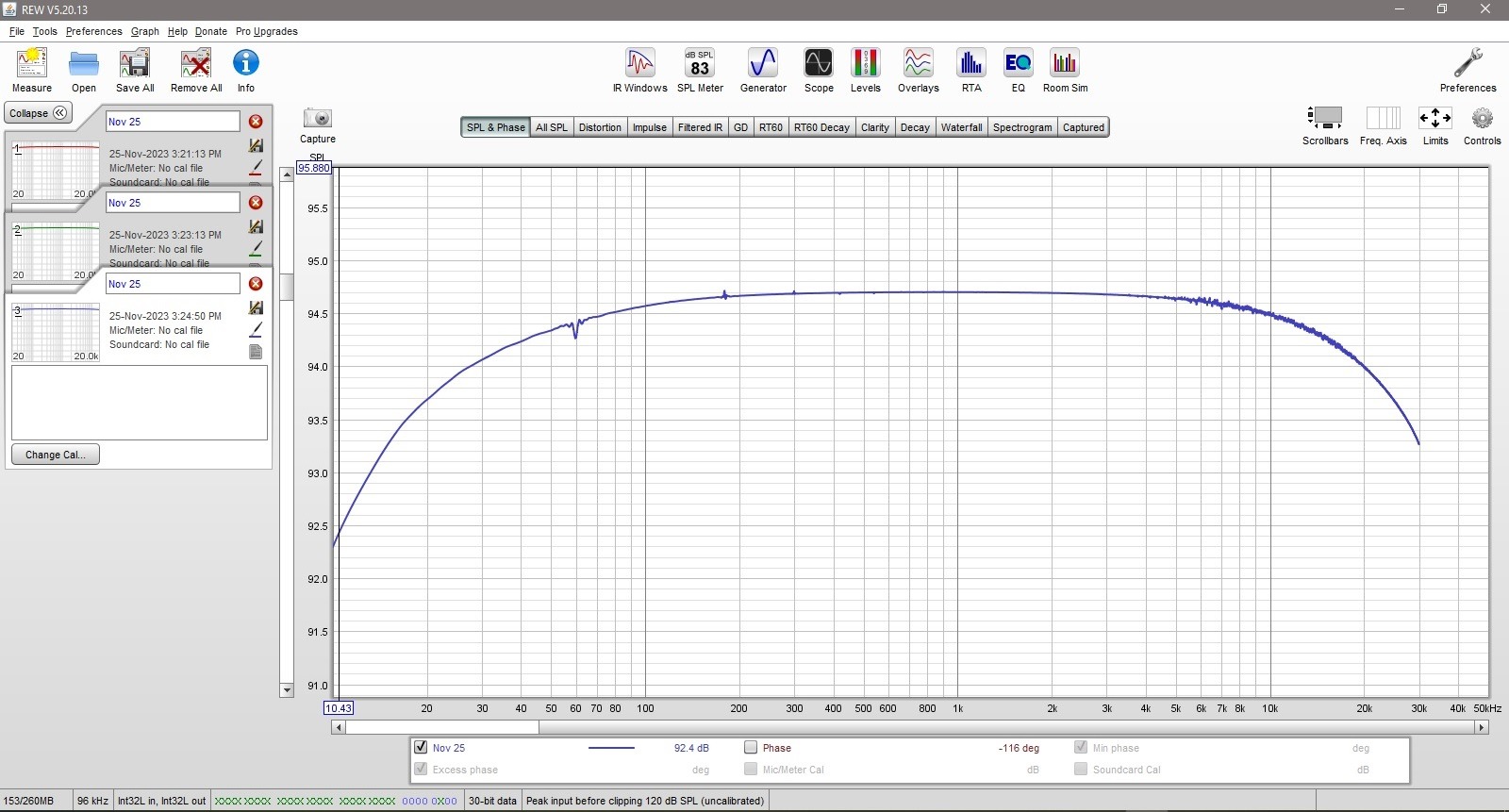

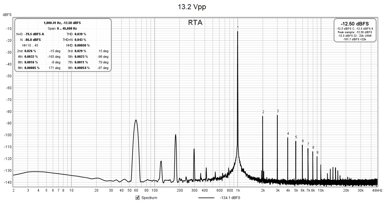

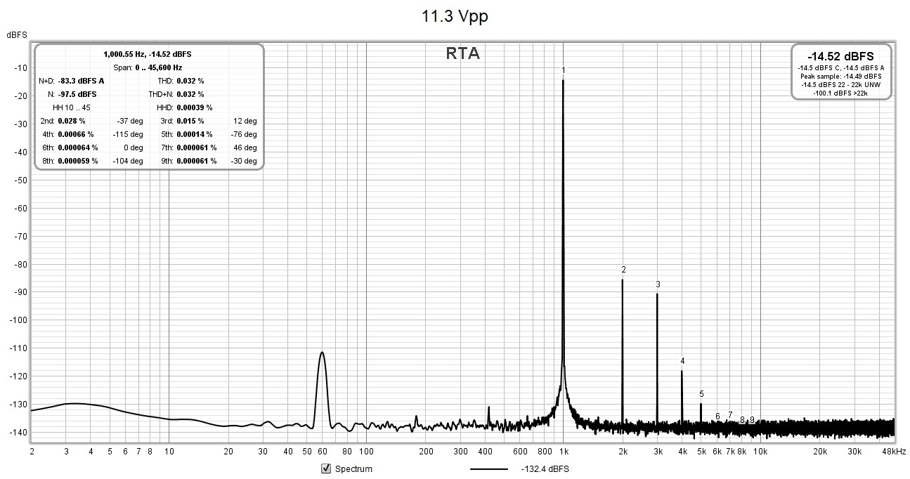

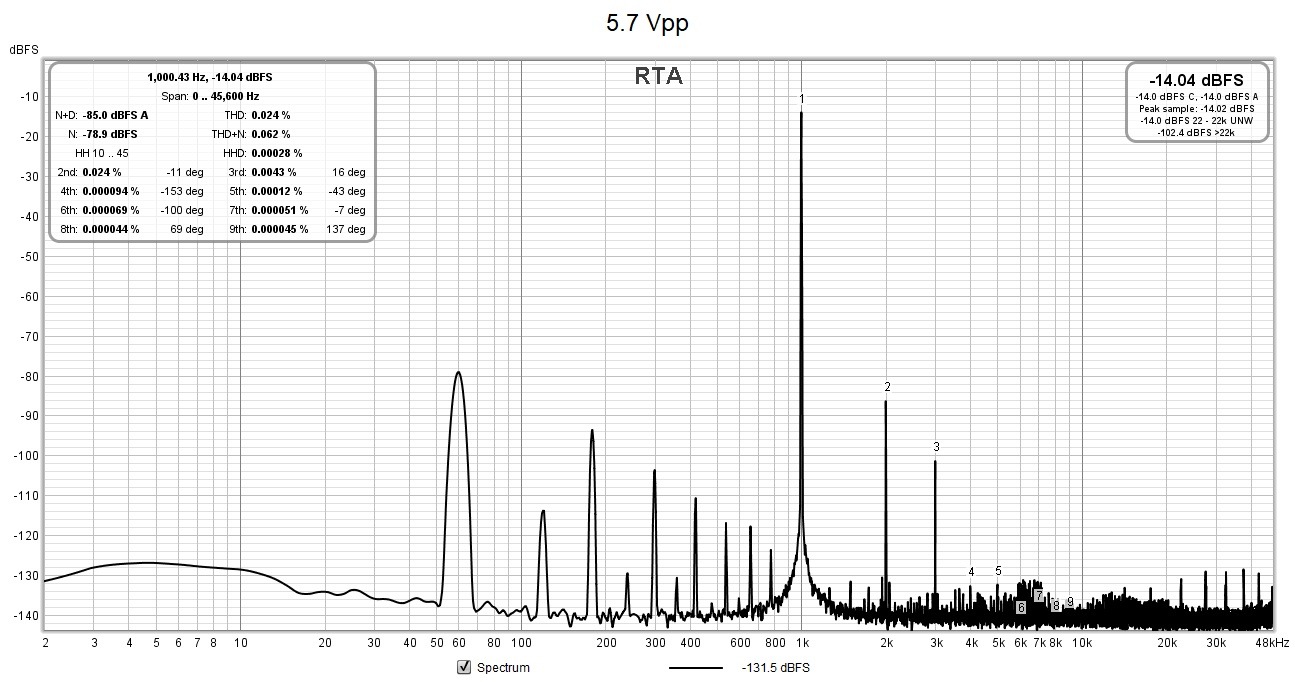

I got around to measuring the output impedance of the Magnequest choke loaded version of the preamp and it came out at 4.7k ohm. This is a little bit lower than the 6.5k ohm predicted by LTspice.

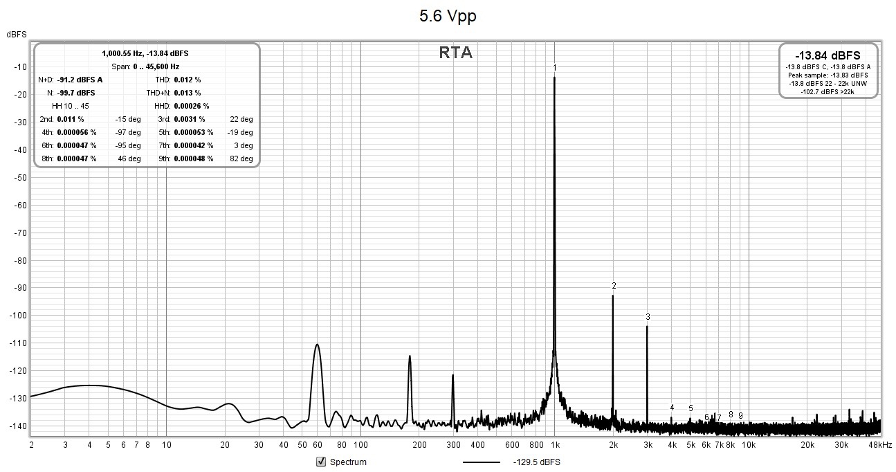

In the quest to lower the output impedance, I incorporated a bit of negative feedback. I added a 2.4k ohm resistor to the JFET input and moved the ground end of the 47.5k ohm gate resistor to the preamp output. This lowered the overall gain to 9x (19.1 dB) and the output impedance dropped to 1.2k ohms.
I had rechecked the gain prior to adding feedback and measured it at 19x (25.6 dB) . This translates into (25.6 dB - 19.1 dB) = 6.5 dB of negative feedback in the new configuration.

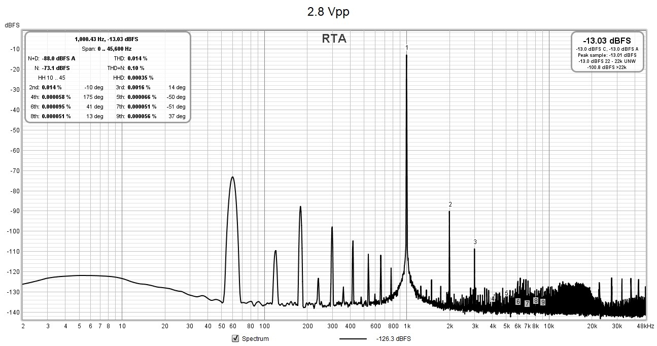

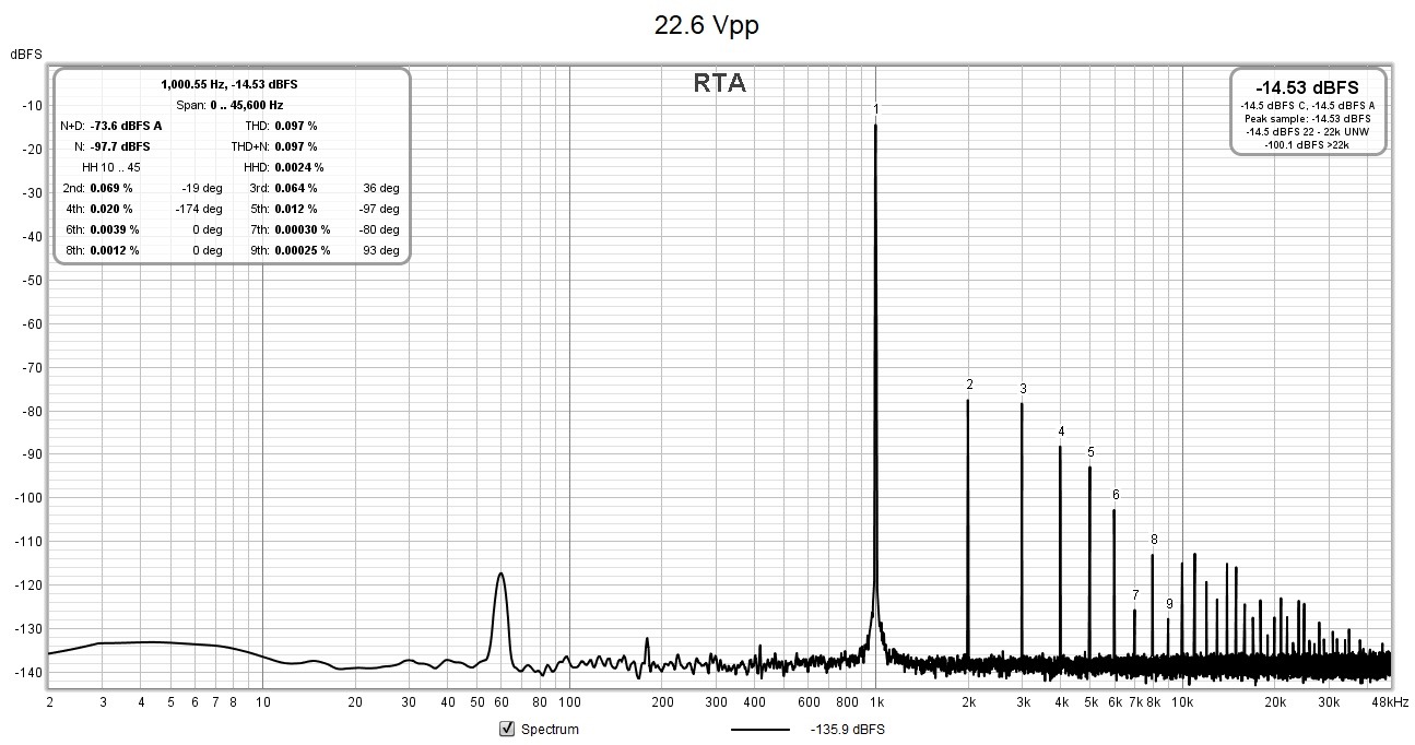

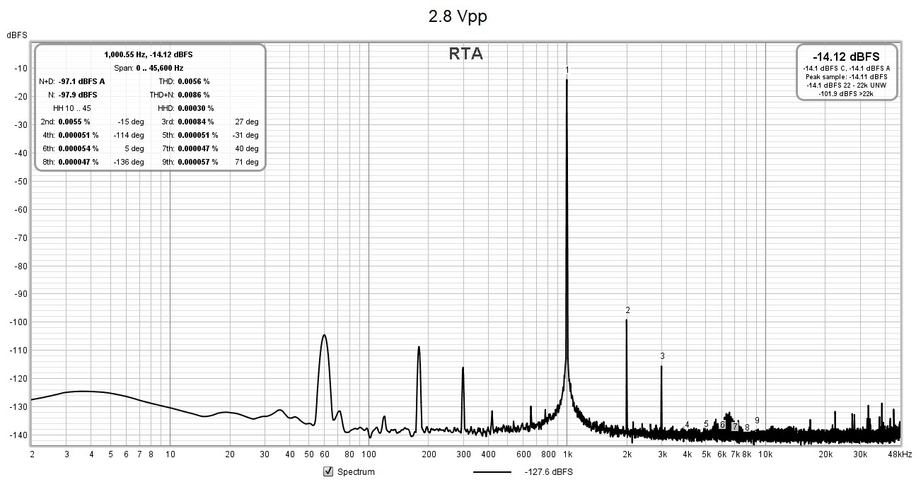

With negative feedback added, I made some distortion and frequency response measurements. THD at 2.8 Vpp and 5.6 Vpp dropped significantly and there doesn't appear to be much increase in high order harmonics. Distortion at 34 Vpp output also dropped by about one-half. Frequency response at 20 Hz improved to about 0.5 dB down.

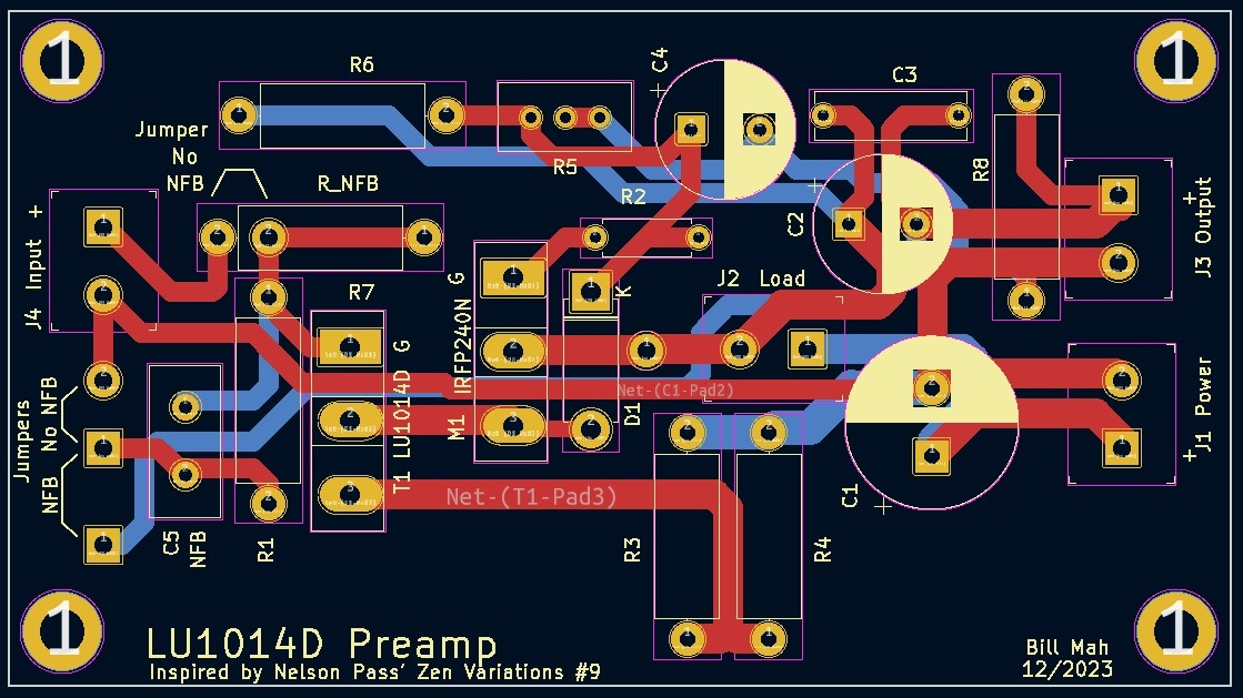

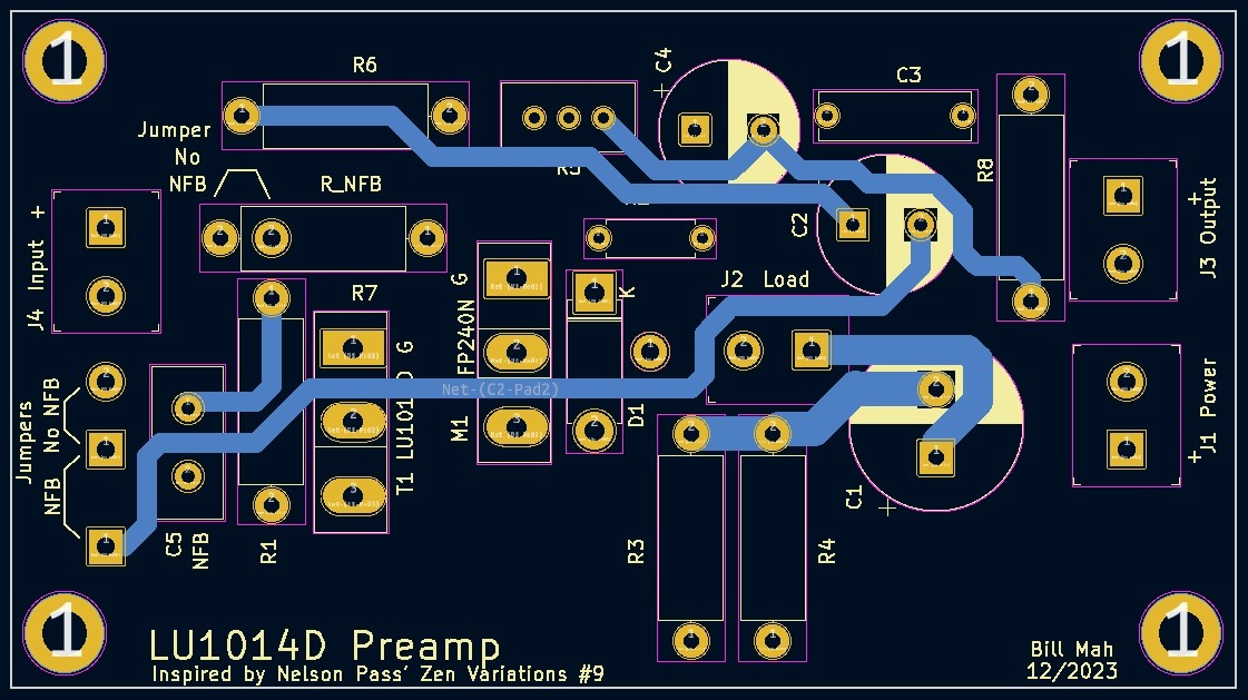

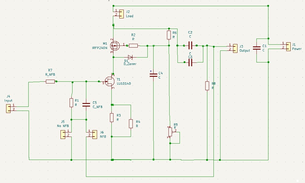

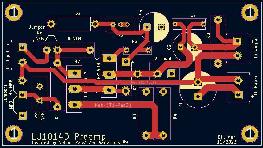

I've been working on the PCB on KiCad for the last few days, and after quite a few "I think I'm done" moments, I think I'm done.
I have tried to build options into the PCB: negative feedback or not; resistor or inductor load; power supply decoupling capacitor footprint to accomodate some 63V electrolytics; parallel resistors on LU1014D source to allow bias adjustment.
The MOSFET dissipates about 2 watts so a small heatsink is required. There is enough room around the MOSFET for this. I am going to try using a small aluminum plate (3cm x 5cm) to see if that is sufficient for cooling. The LU1014D mounted on the aluminum breakout PCB is fine without additional heatsinking.
I will be generating Gerber files and ordering some boards from JLCPCB probably tomorrow. The boards are 50mm x 90mm so with slow shipping, they should be quite cheap.
I intend to provide the Gerber files to interested persons. Until I actually receive the boards, populate, and test them, I don't know how they will perform. However, if anyone doesn't want to wait, I can provide them with the Gerbers now.

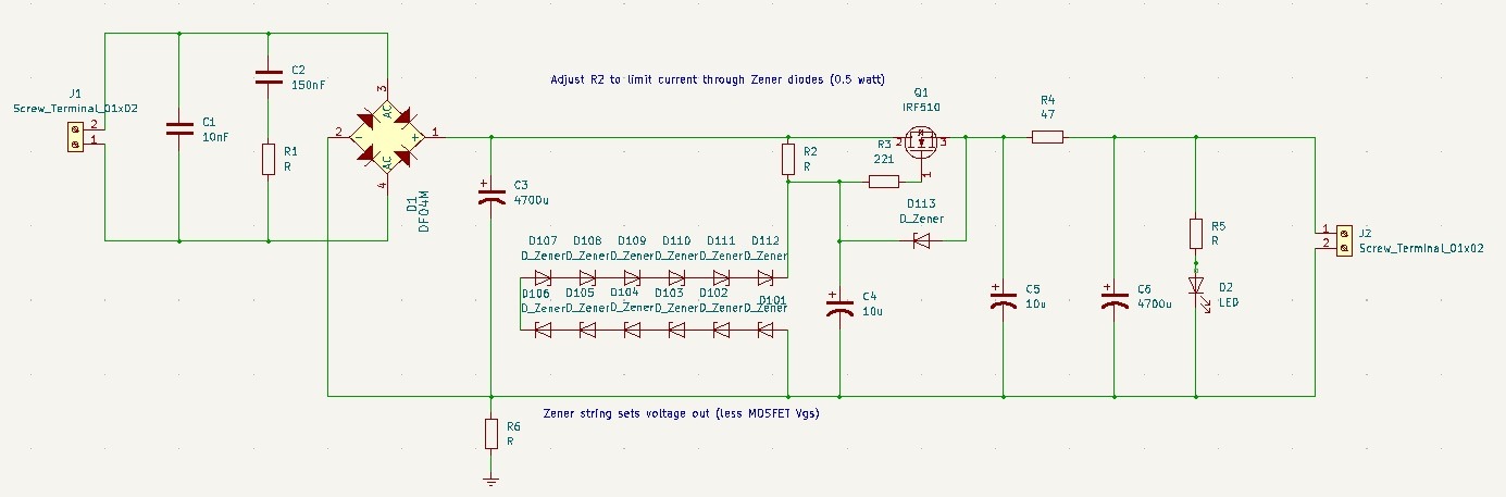

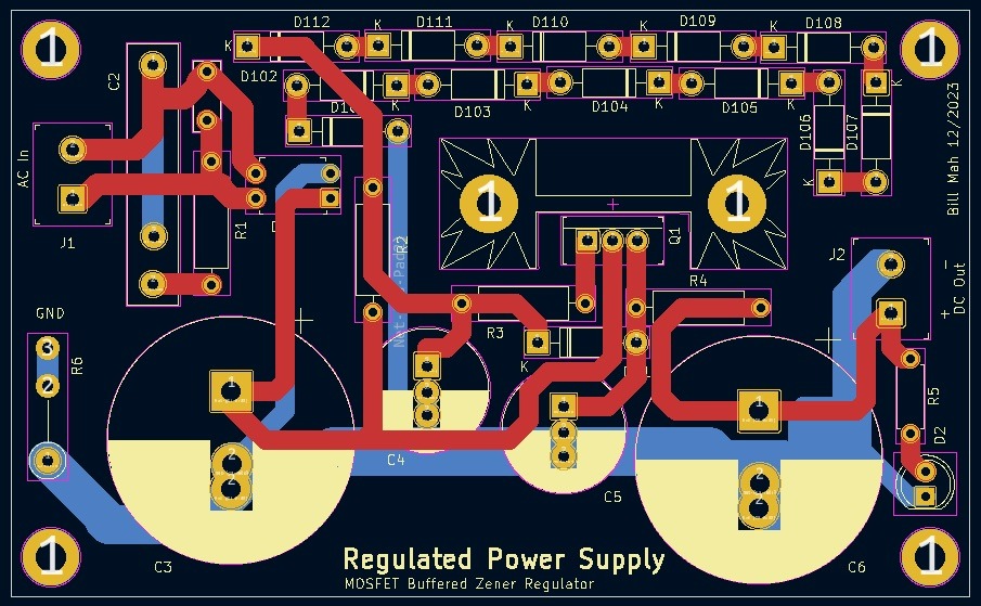

Meanwhile, I created a PCB for a regulated power supply which I just submitted to JLCPCB. Again $4.00 for five boards.
The power supply is a simple zener regulator with a MOSFET source follower buffer. I've made the circuit board to accommodate electrolytic capacitors up to 25mm diameter so input voltages up to 180V or so can be used. There is also room around the MOSFET for a heatsink. This regulator circuit is the same as the one Michael Rothacher used for his LuminAria, and so this design can be used for a wide range of voltages.
I have included room for 12 zener diodes to set the voltage. This should be enough so lower voltage zeners can be used to minimize noise. R2 drops the input voltage to the value of the zener string and it can be sized so the current through it and the zeners is around 7-8 mA. Power dissipations of the resistor, zeners, and MOSFET should be considered. The output voltage will be about 5V (Vgs of MOSFET) lower than the zener regulated voltage at the MOSFET gate.

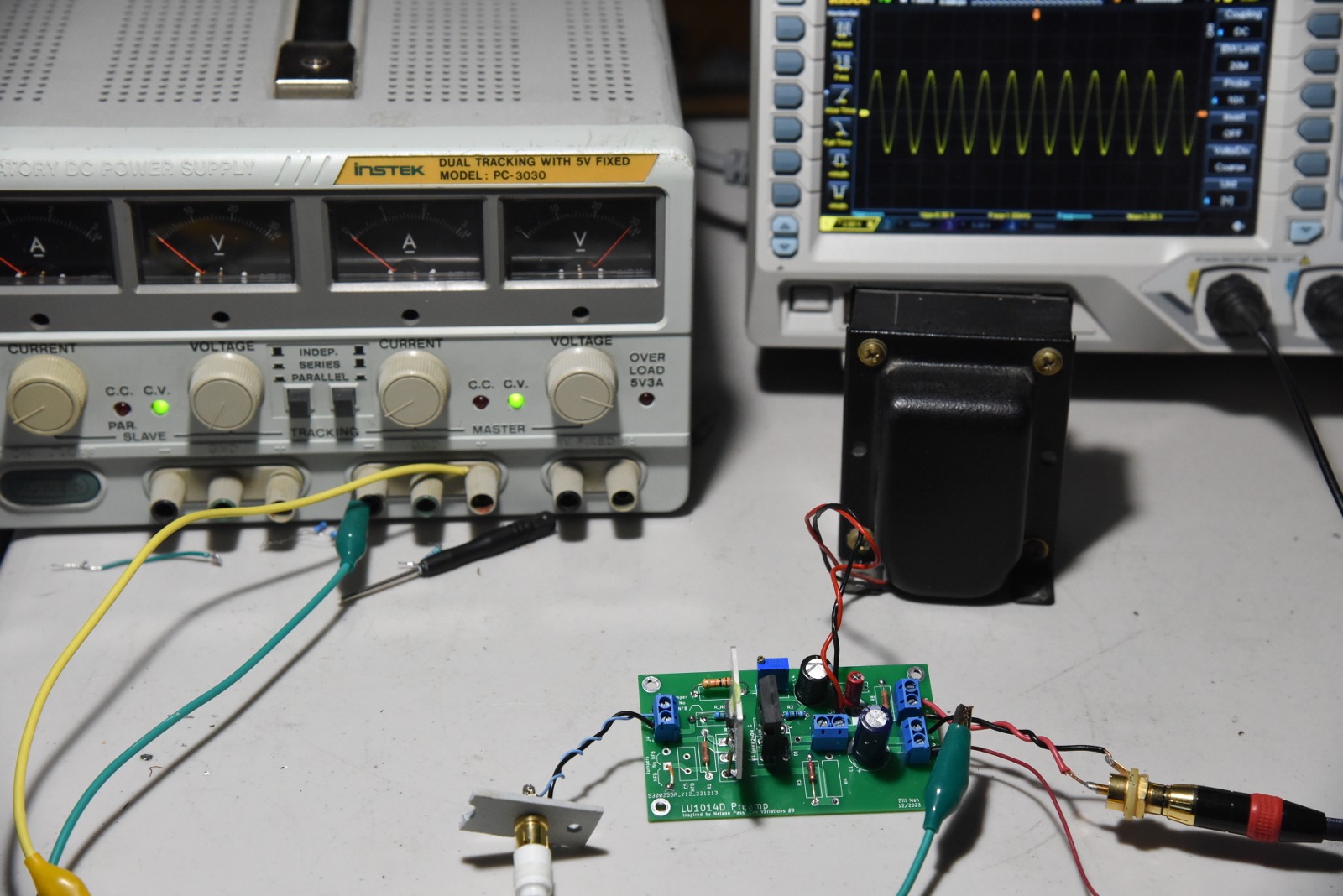

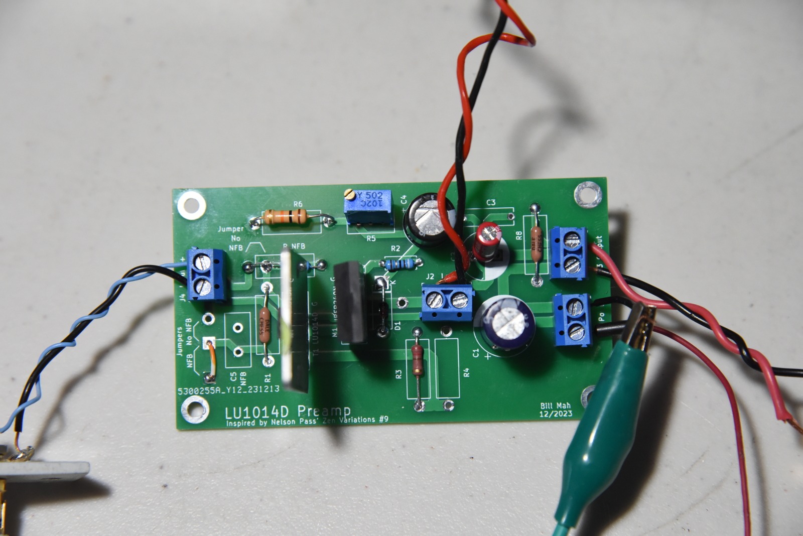

I visited my mail box and discovered a late Christmas present. JLCPCB came through with my preamp PCBs.
So, I disassembled my test prototype and populated a PCB with the parts. I don't have a small capacitor for the feedback loop, so that is not in place, and I used a 220 ohm resistor for the JFET source resistor. The prototype had an 180 ohm resistor, but there is room on the PCB for a parallel resistor to adjust the final value. The spot for the film capacitor to parallel the output electrolytic capacitor is also empty. I'm using this PCB for test purposes only, so I wasn't particular about some of the details.
I hooked up the finished PCB to my lab power supply, applied a 1 kHz input signal, and the oscilloscope showed a good output signal. I adjusted the cascode and measured voltages were correct.
It looks like the schematic to PCB process was successful.
