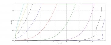

Will do. I have to reconfigure the equipment stack for that.
For the moment, what I am doing to fake out pulse mode is to make NPLC small. I have gone down to 0.05 NPLC which is 834 uS. Reducing points on the curve also reduces total energy. If I end up writing my own software some day, I will have a place to limit total energy per unit of time; duty cycle if you will, to approach isothermal.
Vgs -2.3v to -1.1v in 8 equal steps. The wonky shaped curves are an interaction of the sourcemeter with the device. I tried about 20 different things none of which cured the problem. I will re-visit when I can.
Current limit was set at 1.8A

I disconnected the computer and investigated using the front panel of the instruments.
The drain current is quite unstable when watts are being dissipated. I think that bolting this beast to a heatsink may produce better curves at greater than 10V and above 100 mA.
