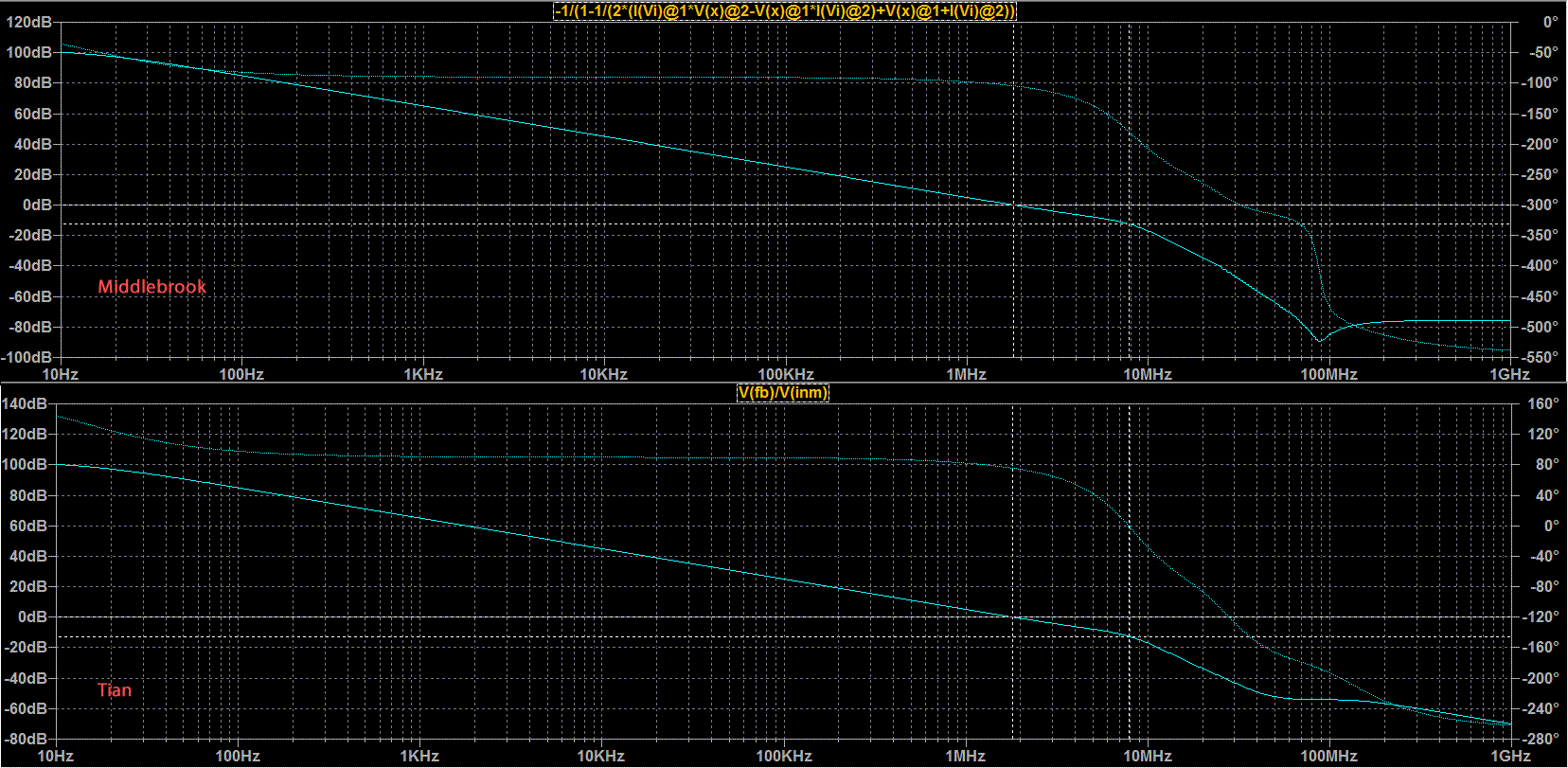

This said, I never had the curiositiy to compare Middlebrook and Tian on a CFA:.

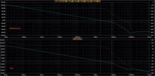

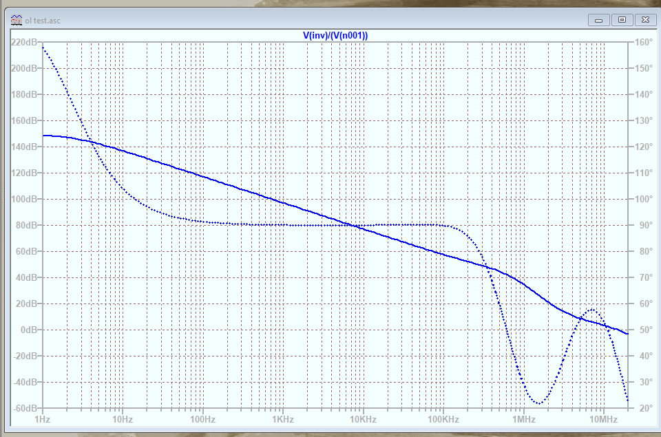

I have found my issue. A servo acts in very low frequencies. Need time to stabilize.
We want to make measurements at high frequencies. If we compute with a start time long enough to allow the servo to reach its point of stabilisation, and number of point to can evaluate the high frequencies, it takes hours.
So, my solution to replace the servo out by a voltage was the trick. But I had to kill the servo itself, because it was at 1000 Hz in a unstable point.
I don't know the way to tell SPSpice to evaluate the servo + the amp in a fast way to find the DC operating point before to begin the detailed amp analysis.
Last, I don't believe one second in the distortions measurements I got: 0.000056% at 1KHz, 0.000030% at 100Hz, 0.000638% at 10KHz. I know i'm talented*, but not at this point ;-)
It is a simple CFA, Diamond input with current sources, Cascode VAF, driver and a pair of HEXFETs (2sk134 & co) out devices, +-60V out. Cordel models.

So it's a settling issue after all. The bias point is by default calculated before the start of the transient run, but the start of the signal disturbs it.
When your circuit behaves similar to an integrator, it may help to have a jump from the average value to the peak value at t = 0, rather than a sine wave that starts from the zero crossing. Draw a signal that is zero for t < 0 and sin(omega t) for t >= 0 and its time integral and you will see the problem. Draw a signal that is zero for t < p and cos(omega t) for t >= 0 and its time integral and you will see why it may help.
By the way, a Hann window makes the FFT far less sensitive to incomplete settling issues. Or more accurately, with a Hann window it is mainly the bins adjacent to those with the signal that are affected.
