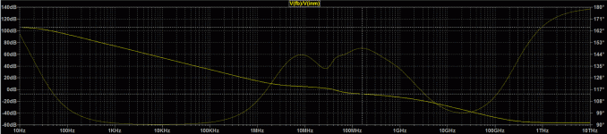

LTSpice Slow: help, please.
Simulating a power amp design in progress, i found the following:
The same circuit that was simulated (.trans) in less than 10 seconds, when the OLG 180° point existed after the 0dB gain in TIAN simulation, takes days if, with an other compensation, this 180° point is never reached any more.
How to get rid of this behavior ?
(Thanks in advance for your help)

Do you mean that a transient analysis of an oscillating amplifier takes longer than a transient analysis of a stable amplifier? That's perfectly normal simulator behaviour; as the voltages are changing faster and more often in an oscillating amplifier, the simulator needs to take smaller time steps to converge.
You can take a smaller final time or reduce simulation accuracy (increase tolerances) or use a faster computer if you really want to transient simulate an oscillating amplifier.

Thanks for your answer, Marcel.
Please, explain-me, looking at this curve why it is an oscillating amplifier ?
And, BTW, how to "increase tolerance" ?
In theory, when the plot in post number 1 is a loop gain plot, the amplifier should not oscillate, or at least not under small-signal conditions. It's unusual, though, that the loop gain levels off to a constant value. Can you show a schematic and indicate what nodes fb and inm are?

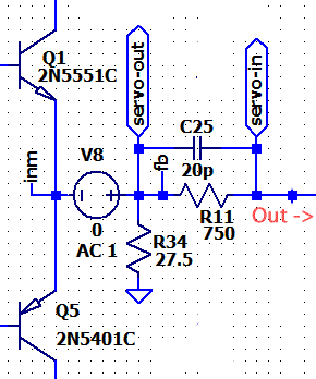

Until I have finished my work, i do not want to share the full schematic. Attached is where my Tian Voltage source is. inm is at the -input as requested, fb at the middle point of the feedback attenuator, as requested. I was surprised too by the "constant value" OLG at very HF, reason why i simulated up to 10 Terahertz ;-) The CLG is normal. I cannot answer about the long run. Not enough patience.
The CLG is normal.
I think your method of determining loop gain is incorrect unless either the impedance to the right of the source (node fb) is zero or the impedance to the left of it (node inm) is infinite. Since neither of these conditions is met, you can do two things:
1. Shift the source to the other side of the feedback impedance, then at least the impedance on the right of the source is lower than the impedance on its left.
2. Look up the papers of professor Middlebrook and apply his full method.
It is easy to see that the method goes wrong by looking at an extreme case: replace the (active part of the) amplifier with a current-controlled voltage source with finite (or even zero) gain. As a current-controlled voltage source has zero input impedance, V(inm) will be zero and the ratio will be infinite, even though the loop gain obviously can't be infinite.
The ratio between V(fb) and V(inm) for frequency approaching infinity is simply the ratio of the high-frequency impedances on both sides of the source. The amplifier doesn't amplify anymore at 10 THz, but you get a voltage division between parasitic impedances.

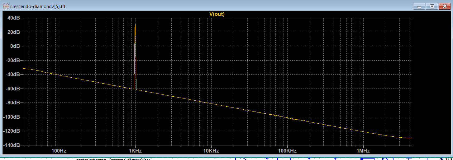

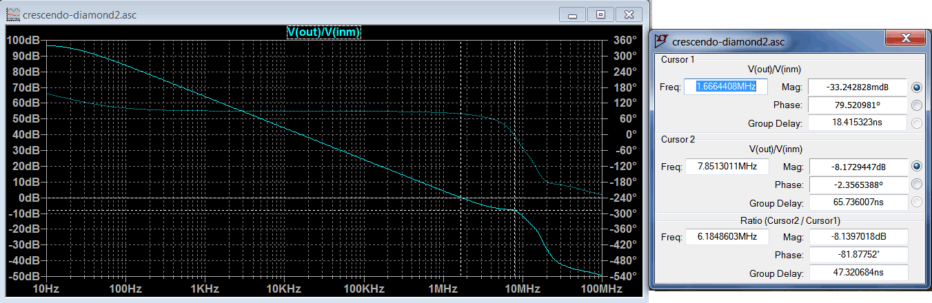

Whats happens is VERY strange. The Trans is fast, now, and, if I can rely on my TIAN, phase margin is 75° and gain margin 8dB.
No overshoot on square waves little signal.
Now, if I try the FFT, it works at 10KHz, it works at 30Hz, but look how it is at 1000Hz.
If i try the FFT on an other point than Out, it works as expected.

I cannot believe such a GUY. There is no fast way to swap between trans and AC, but editing in a box where letters are so little that I cannot see them with my old eyes, I cannot understand why Middlebrook is not implemented as a default simple fonction, why, sometimes the program has so strange behaviors. Not recognizing fb, as an example. LTSPICE is the most complicated and unachieved program I never used. Powerfull, but, the exact opposite of user friendly. I know it is free, but that is not an excuse. Open source and free programs are usually better than commercial ones, because huge community behind. And the models, the bugs, what a nightmare !
It is a tool. A tool that need years of learning ?

Looks like a settling issue, although I haven't a clue why you only get that with 1 kHz. Does it get better with dlycyc = 100?

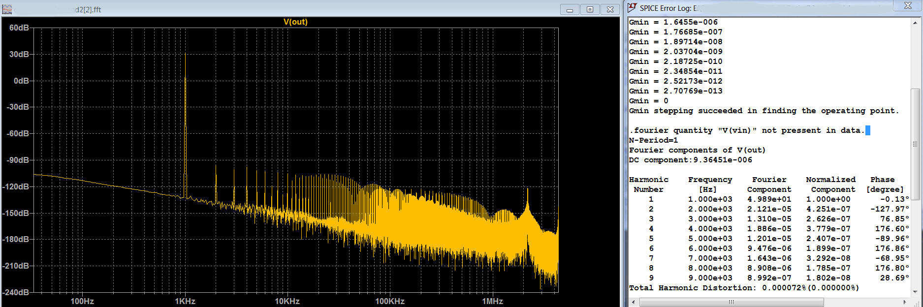

Found the issue: "gmin stepping failed".
It comes from my DC Servo. Replaced its output with an equivalent voltage source. See attached.
Don't know how to fix-it. If I replace their +-12V with a pulse, trying various rise time, it seems to not work at all when I plot the output DC voltage.
Spending more time to get rid of LTSpice behaviors than to design circuits ?

Do you also get error messages about non-convergence or only gmin stepping failed?
I'm more used to Spectre RF than to LTSpice, so I really don't know whether what I'm about to write applies to LTSpice, but when Spectre RF says that gmin stepping failed, it is not a big deal. It just means that the first of a whole bunch of algorithms it has to find a bias point didn't work out and it continues with the next one. In fact we often switch off gmin stepping for large circuits because it almost never converges and just wastes time.
If gmin stepping is the only algorithm that LTSpice supports, then a failing gmin stepping means that the bias point is all wrong. That could give you completely non-physical results.
There are a couple of things you can try to get rid of DC convergence problems. One is to use nodeset statements to provide initial guesses for a couple of node voltages. A second one is using a somewhat higher reltol (but not too high, as otherwise the distortion simulation gets inaccurate). A third one is to start from zero and slowly ramp up the supplies, but I understand you already tried that. A fourth trick is to randomly change a few parameters by a very small amount, for example reducing the supply voltage by a few millivolts. I know that sometimes worked for PSpice 20 years ago.
Or creating an 0.1% asymmetry in an otherwise symmetrical circuit. Both methods still work in PSpice :D.
The nodeset() method is probably the best way to improve convergence in all Spice distros. Reason is buried in the Newton-Raphson-SOR venerable algorithm, the foundation of Spice since the Berkley days.
