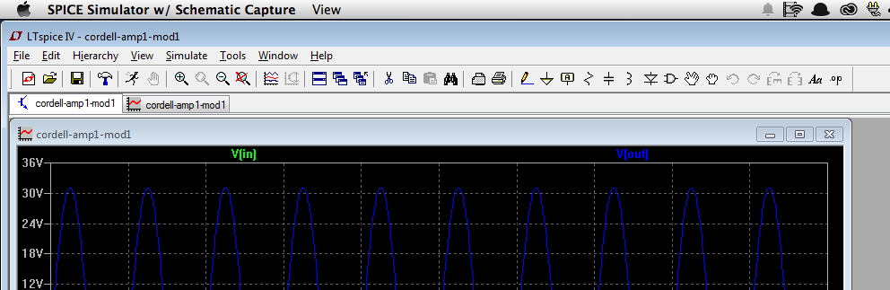

But you don't have to give up Mac, just run it in a Virtual PC and in Coherence mode of Parallels. It's like LTSpice running natively.
attachment.php
A few months ago, I was in the same room with him as he demoed it as part of the LTspice World Tour, a shindig sponsored by Arrow and Linear. He writes it and uses it on the Mac. He stated that he prefers that to the Win version. But, please, do not use that version! It's clearly not for you! ;-)
