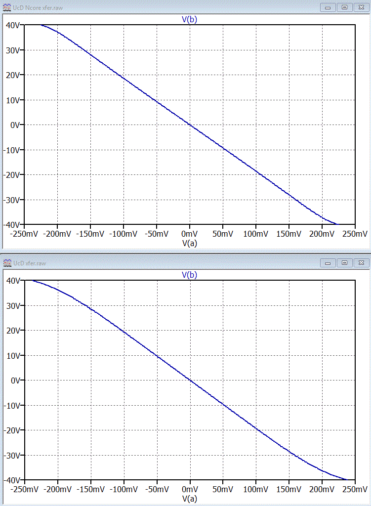

One of the improvements claimed of the Ncore topology over the original Ucd self-oscillating class-d amplifier is that the modulator transfer function is more linear. I created a couple of simulations to check this out and, indeed, the Ncore transfer function is very linear until just under saturation whereas the original UcD design has a more tube-like, rounded transfer function with a bit of an s-curve. To reproduce these curves, the x-axis must be changed from "time" to "V(a)" by hovering the mouse pointer over it until the ruler icon appears, then click and edit the axis parameter.
The Ncore also has about 20dB more loop-gain across the audio band (to see this, switch to an ac analysis for both simulations and click on the "fb" node).

Some astute readers may have noticed that the self-oscillation frequency predicted by the ac simulation is close to, but higher than the actual operating frequency in the transient simulation.
As Bruno Putzeys pointed out, the UcD is not a sine wave oscillator, so the additional phase shift of harmonics influences phase crossover for the composite waveform. Oscillation occurs at the frequency where if the loop were broken (and driven as before the break), the signal on both sides of the break would be the same shape and phase relationship.
At quiescence, at the input to the power comparator the output square wave has been heavily low passed, so it appears as a slightly distorted sine wave, so the influence of the harmonics is very small and the ac analysis is quite close. However, when the output level is near the rails, the output is a narrow pulse rich in harmonics that must be taken into account.
In the ac simulations (which are open loop), I set the ac source to a value so that when traversing the feedback loop, zero crossing of magnitude would occur at the same point as phase crosses zero. I have done this simply to make the results appear more intuitive by mimicking what the closed loop would do naturally through feedback.
As feedback is taken after the LP filtering, more filtering probably wouldn't do much to the HF peak other than reduce the feedback there (and possibly degrade phase margin)
Yes. Of course there could be added filtering after that output feedback point that is not in the loop.
