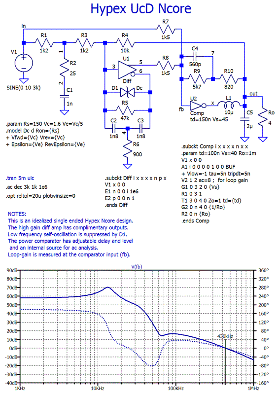

Have been sim'ing and one note on the Ncore design (sim presented here) is that the gain is only around 4 times, which means you need a pre gain stage, which is of course not som much of a problem, but worth to mention.
Having compared to a pre/post filter fb implementation, and the Ncore does for sure get better results, but at a cost of a bit higher complexity. One must also wonder how much extra gain is sinsible to put in the loop to gain the better HD figures, and also how low in HD do you need to go ... with speakers producing at least in the 1/10% HD, id it then possible to hear the difference of say 0.01 and 0.05%?
I for sure don't pretend to know the answer, and for sure the Ncore design raises the bar and makes otheres wonder if they can do better on their own designs ... which is a very healthy thing. Thumbs up for Ncore.
(It is especially towards higher freq Ncore really makes a bug diff ... having much more fb at say 10 kHz)

I am currently revisiting the UcD and Ncore designs as a vehicle to compare LTspice to PSIM (to which I have been given a six month evaluation license). PSIM (like SIMPLIS and some other expensive simulators) allows simulating loop-gain measurements in the transient domain using DFT techniques like a loop-gain analyzer in the lab.
LTspice can do this measurement too, but it is much slower than PSIM (which uses piecewise linear models for the switches and other nonlinear elements). I am still learning the abilities and limitations of PSIM so I can't promise a meaningful outcome, but I will report back if I get something interesting (might take awhile).

Attached is the LTspice simulation schematic and loop-gain plot for the original UcD amplifier. This is taken from a transient simulation that is post processed with measurement statements to provide loop-gain in the time domain like a laboratory frequency response analyzer.
On my computer the simulation takes twenty minutes to process four curves of 101 points each (404 points total at about three seconds per point). Without the stepped dc bias a single run would take about five minutes.
What this shows is that audio band loop-gain decreases as the output approaches the rails. It also shows that the audio input should be rolled off at 30kHz to 40kHz to avoid artifact.

Albert Dunford of PSIM has made me a beta tester for their simulator. Betas often have bugs. In the version I have, the stepped parameters function is broken. I may be able to do stepping via scripts, but I haven't succeeded yet. The attached plots were taken with zero dc bias to the amplifier input.
The UcD amplifier is a self-oscillating design so the switching frequency is not clocked and varies a bit with operating point. This seems to be giving PSIM problems in determining the exact switching time so the loopgain is off compared to LTspice. Maybe this is a PSIM beta bug, but the difference is disturbing.
LTspice took 270 seconds (4 minutes 30 seconds) to run and post process the measurement commands. PSIM took 9 to 10 seconds. Scaling the output plots to be the same and creating an overlaid JPG took a half hour or more (much longer than run time).
I am using a beta release of PSIM so some bugs are expected.
