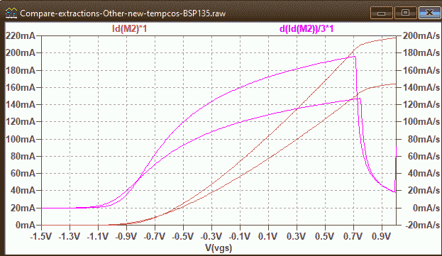

*VDMOS with subthreshold (c) Ian Hegglun
.model BSP135J VDMOS (Rg=5 Vto=-0.90 Kp=0.5 Lambda=0m
+ Rs=3.5 Ksubthres=0.1 Mtriode=0.8 Rd=40
+ Bex=-1.9 Vtotc=-0.8m Tksubthres1=1m Trs1=3m Trd1=3m
+ Cgdmax=200p Cgdmin=3p a=0.7 Cgs=60p Cjo=150p m=0.75 VJ=0.75
+ IS=10p N=1.2 Eg=1.12 Rb=1 Vds=600 Ron=60 mfg=InfIH2008)

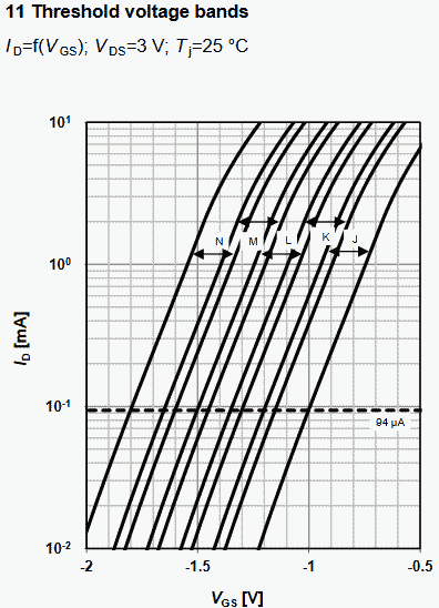

Choose the Vto to suit the rank marking. The model above is for middle of the "J". And "N" would be -1.65V.
Also the gm for the above model is the top end of the datasheet range (160mA/V at 100mA). For middle of the range use Kp=0.38 and bottom Kp=0.25.
Unfortunately no temp-co plots in my datasheet so I guesed likely temp-co's (see my model plot above for 25C and 75C with Vds=10V).

Hi Alexander,
There is a variation in threshold voltages which you change the Vto value to suit the ranking that you receive J to N.
There is also a variation in manufacture for the gm or transconductance, measured at say 100mA and the datasheet gives the range as 80mS to 160mS.
You can change the model Kp value to suit your simulation need. If you want the middle of this range for the "average part" then use Kp=0.38 rather than Kp=0.5 that I supplied.
