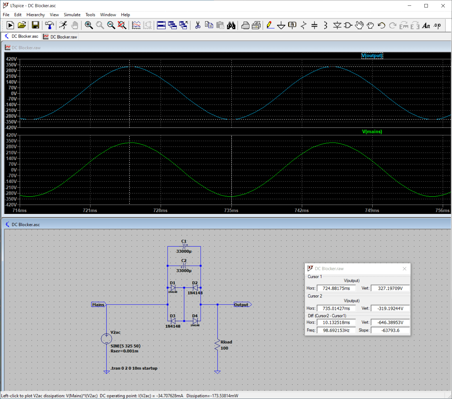

Does someone have a working DC Blocker simulated in LTSpice ?
Mine doesn't work, so i need some help, see attachment.
Thanks.

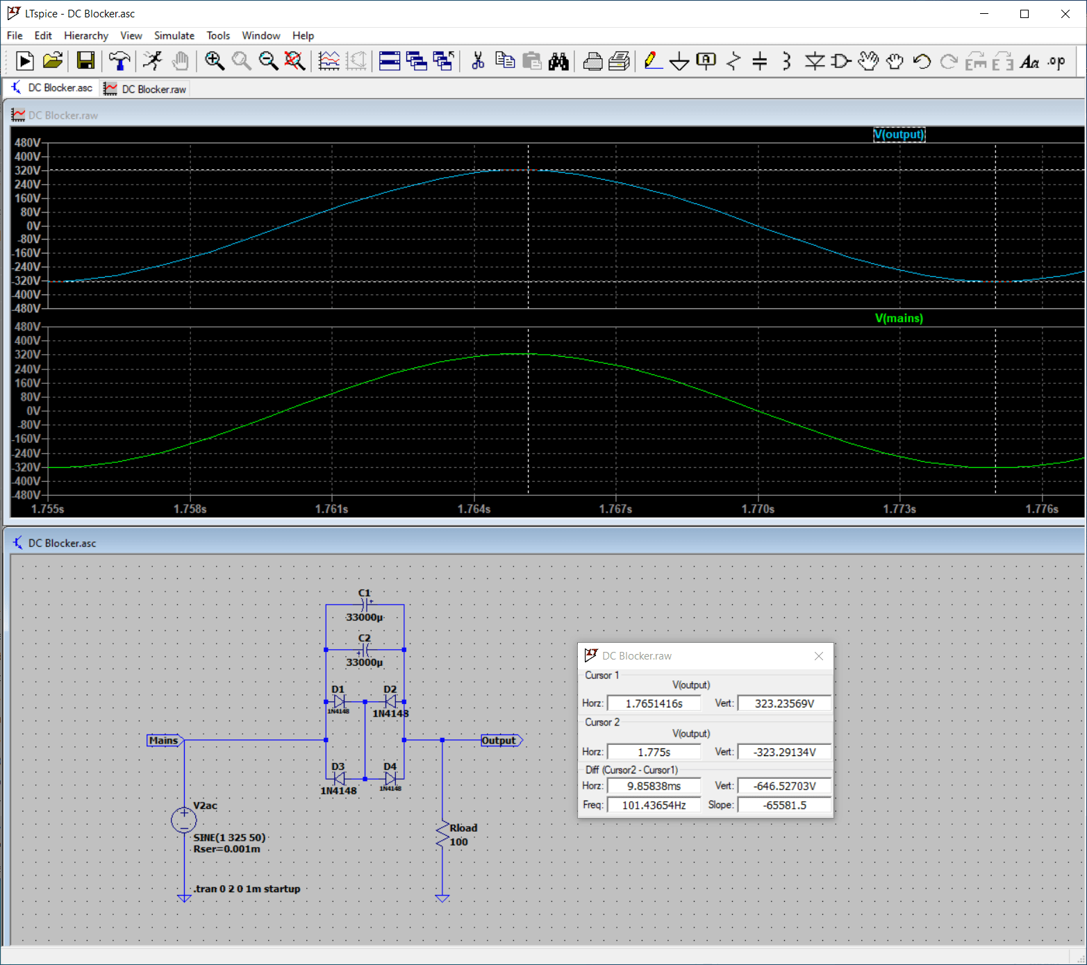

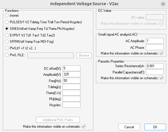

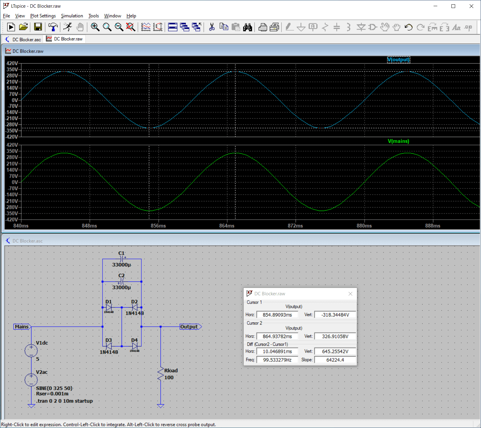

It works. The maximum voltage drop for the capacitors is two diodes in series. So it's not a problem with 5 V. But one can not use 1N4148 diodes in real life. I have also simulated with 1N4001 diodes and a timestep of 1/1000 of the time period (Remember 50 Hz is 20 ms period, so time step of 10 ms is far too large).
