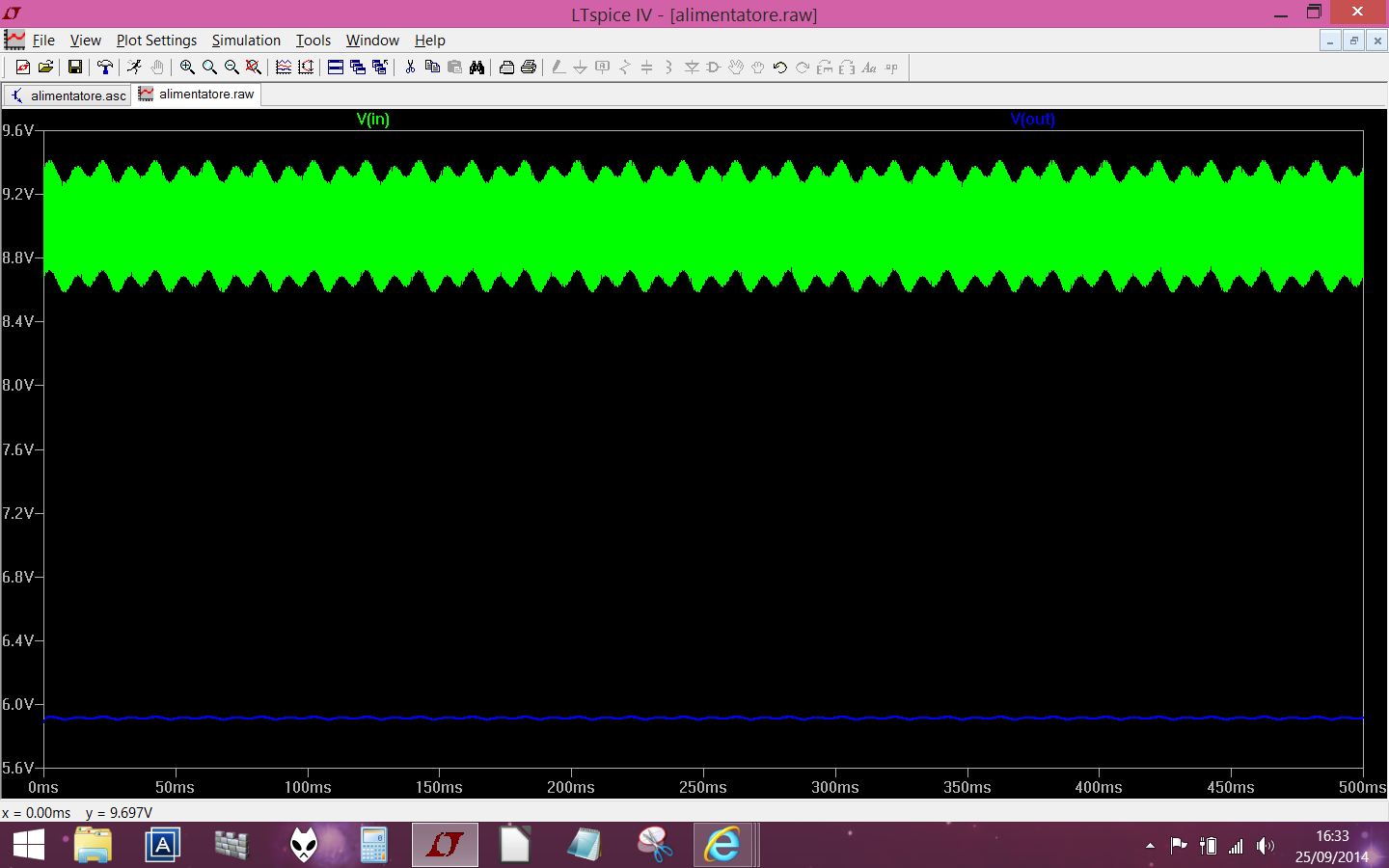

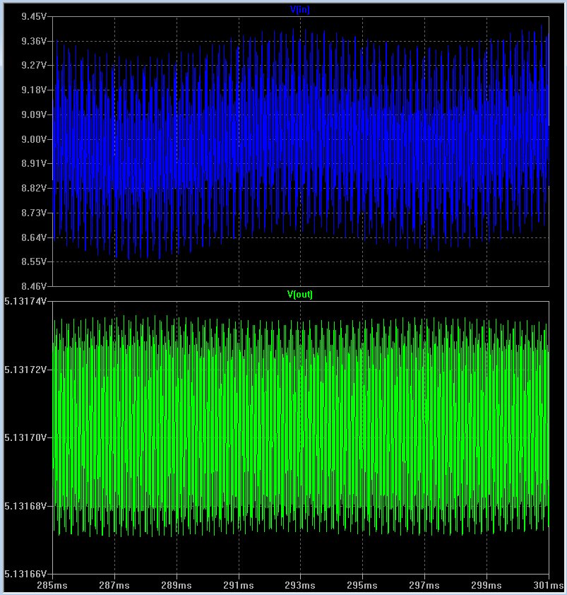

Yes! I read it and oh, thank you very much for that Mooly!!!!! I got the first information on simulating with LTSpice.
But, once I have the ripple on Vin and Vout what should I plot?
I suppose something like 20*log(Vout / Vin) on the y axis and frequency on the x axis. Right?

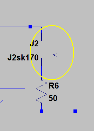

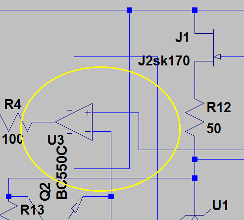

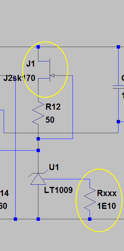

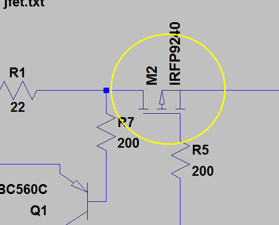

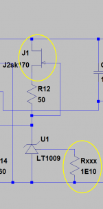

I made a few quick changes to the schematic and it simulated just fine on a Windows7 PC
- Interchange M2's source and drain
- Interchange J2's source and drain
- Interchange J1's source and drain
- Connect infinity ohm resistor to U1's trim pin
- Replace Maxim opamp model with UniversalOpamp2 because the Maxim's Symbol was not included in the .zip file
The poor low frequency behaviour must be thermal, which simulators like LTSpice usually ignoreFrom an LM317 data sheet so it seems from this that they must apply a known fixed (sine ???) type ripple.

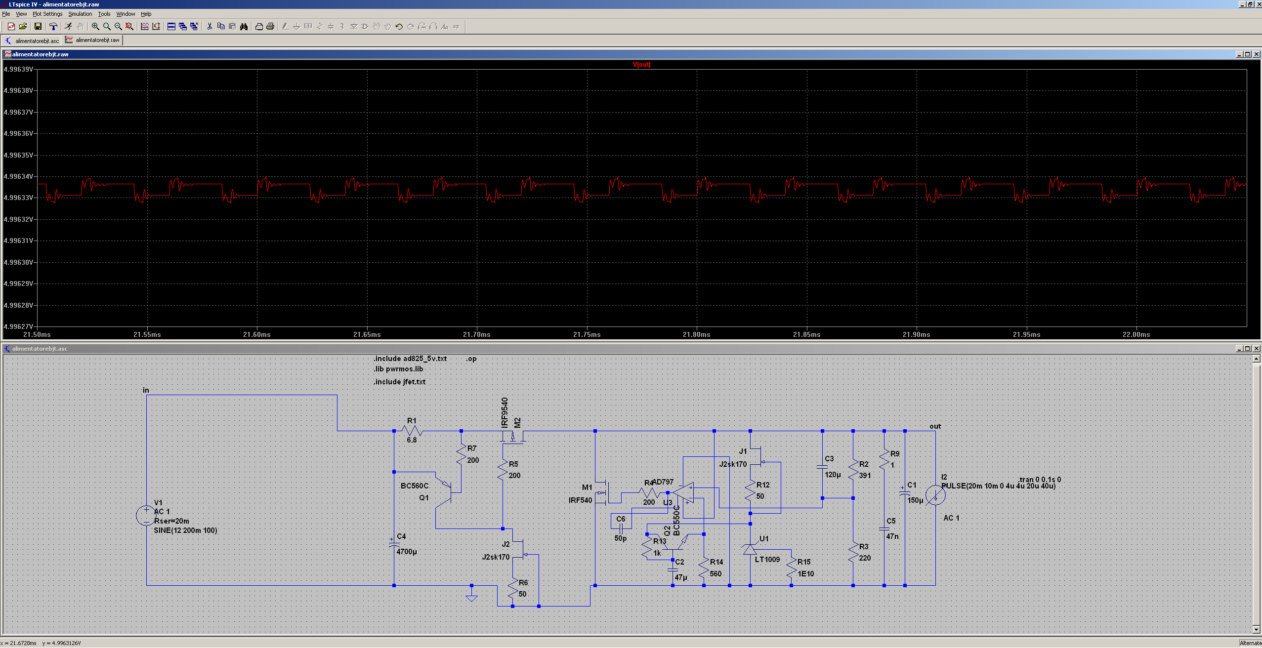

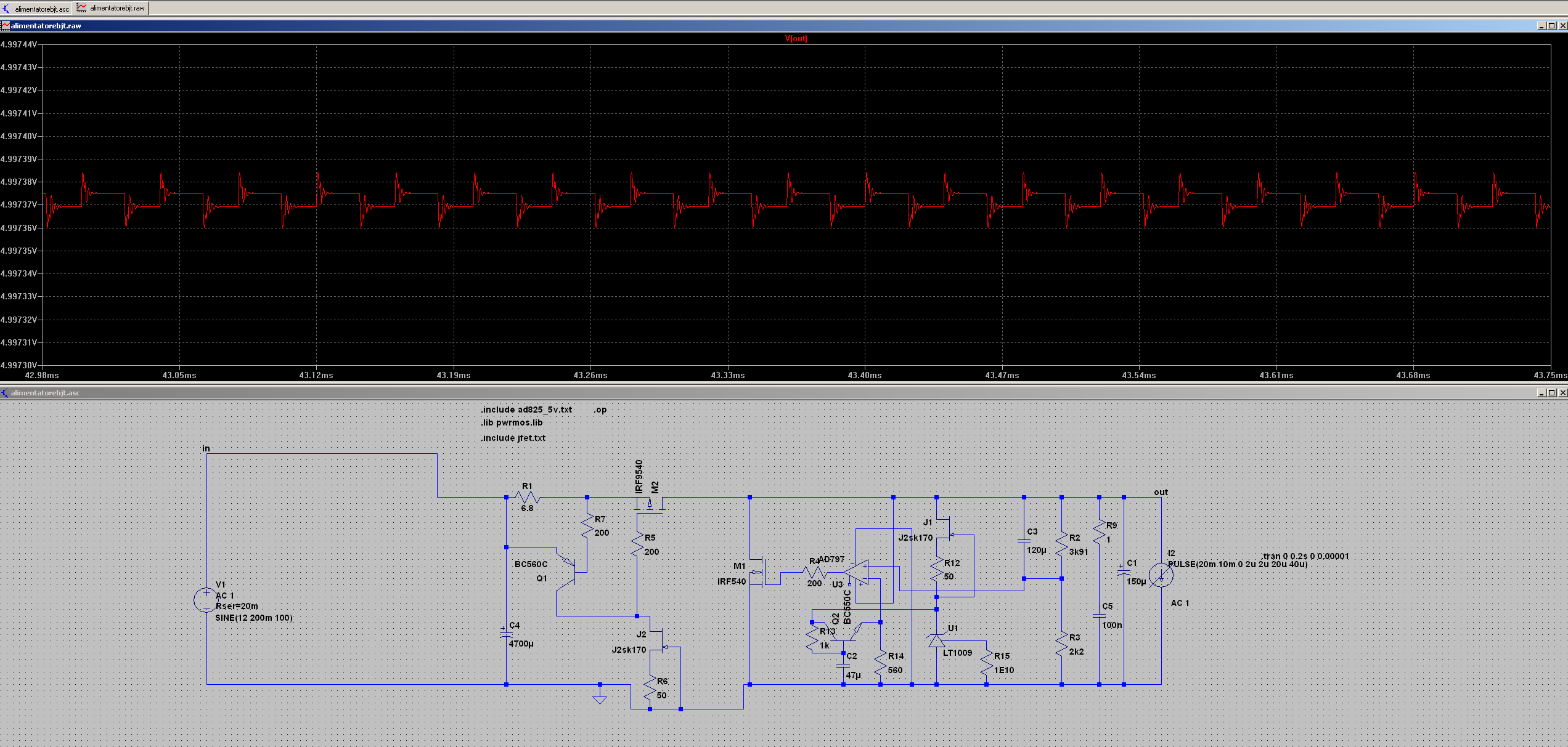

Installing a 50pF capacitor to the compensation/decoupling pin of the AD797, as suggested by the DS, further improves the performances.
About the current from the supply, it is pulling 116mA. 70mA are "wasted" in the shunt element, 4mA biasing the CCS, 8mA in the feedback divider, 4mA in the LT1006 (it will be reduced in the prototype), 3mA for the capacity multiplier the other for opa supply.
