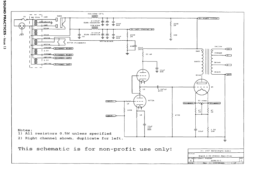

I recently clipped together a version of Gordon Rankin's Bugle and was surprised at the clean sound. Would the GM vs Ip curve sum in a similar way for an SRPP circuit?
SRPP is a class A P-P circuit, so the gm's should effectively sum. 6072/12AY7 doesn't have quite as flat a gm ramp as 12AT7 (versus current), it's a constant Mu tube, but it straightens to a decent ramp at higher current.

Thanks for posting that. I downloaded that image from the net without even looking. Assumptions !

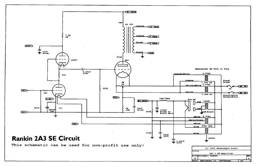

Shown here with 12AT7.
I've been messing around with feedback lately and growing used to the sound, was a bit surprised to hear a similar sort of very clean, clear if slightly lean sound out of the SRPP.
I listened to quite a few SRPP circuits in commercially built amps when they were an often talked about thing and never liked what I heard very much, but the Baby O' had some praise from a friend so put a reasonably close version together. It doesn't have many hours on it so not sure if it would hold up long-term but so far it's quite impressive.

For SRPP there is no constant current regulator in play like for the LTP, so it is possible that constant Mu tubes like the 6072/12AY7 will give lower 3rd harmonic. Should test with a simulator I guess.
In that case, there are similar triode plus frame grid pentode tubes from the old $1 list.
6LY8, 6KV8, 6JT8 and 6HZ8 have constant Mu triodes and high gm pentodes.. All, including the previous 6KR8 and 6LQ8 are 9DX based, so are interchangeable socket wise at least.
