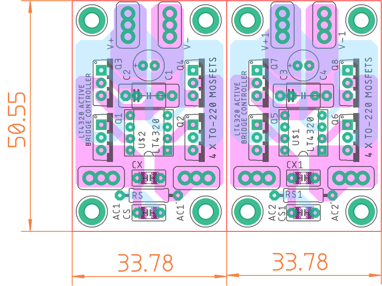

Hi prasi, have been looking in the thread for a parts list - can you update us on a parts list for the through hole boards, thanks - or both. Have the LT4320 and Mosfets, just want to know recommended list of other resistors and caps, thanks.
Also final schematic will be helpful as well.
Here you go.
