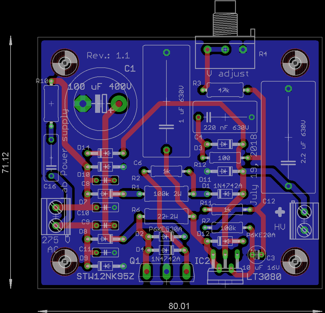

Since I was very satisfied with my power supply in post 22, I have redesigned a high voltage only version to use in a lab power supply for vacuum tubes test :
I have added the pot on board to keep connection short, and it can be mounted on the front panel with the heatsink in the back.

I suppose that your pot is of high voltage one.
The distances in your pcb maybe is not enough for the high voltages. You may need to increase to 3-5 mm

Second all the above.
I would suggest eliminating the output connector -- just two well separated (spaced) solder pads. The connector you illustrate may not be rated for HV.
You can provide a lot of insulation by cutting a slot between ground and HV. You can also put the "+" side traces on one side of the PCB, and those closer to ground potential on the other side.

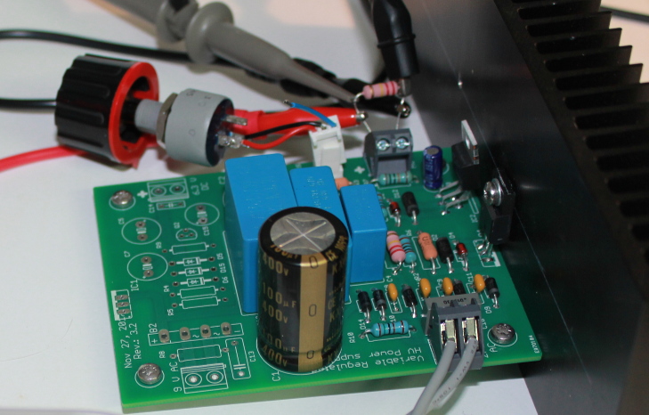

Thanks for yours feedback.
I have not had high voltage problem with the first version of this power supply (see pictures) and I am using similar PCB design rules in Tube amplifiers like the EL34 Baby Huey PCB ( EL34 Baby Huey Amplifier ) which has been sold in qty of nearly 400 pieces without any complaint about voltage problems 🙂

I strongly suggest getting rid of that potentiometer. Replace it with a trimpot. You really don't want the user to be tempted to touch the pot as it'll be floating at voltages near the output voltage.
I also second the calls for greater isolation between high voltage traces and ground.
I'd also look up the voltage rating of the input and output terminal blocks. You'll probably find that they're rated for use at 250 V maximum. A 3-terminal version where you skip the middle terminal would allow you to work up to 500 V.

Hello Tom,

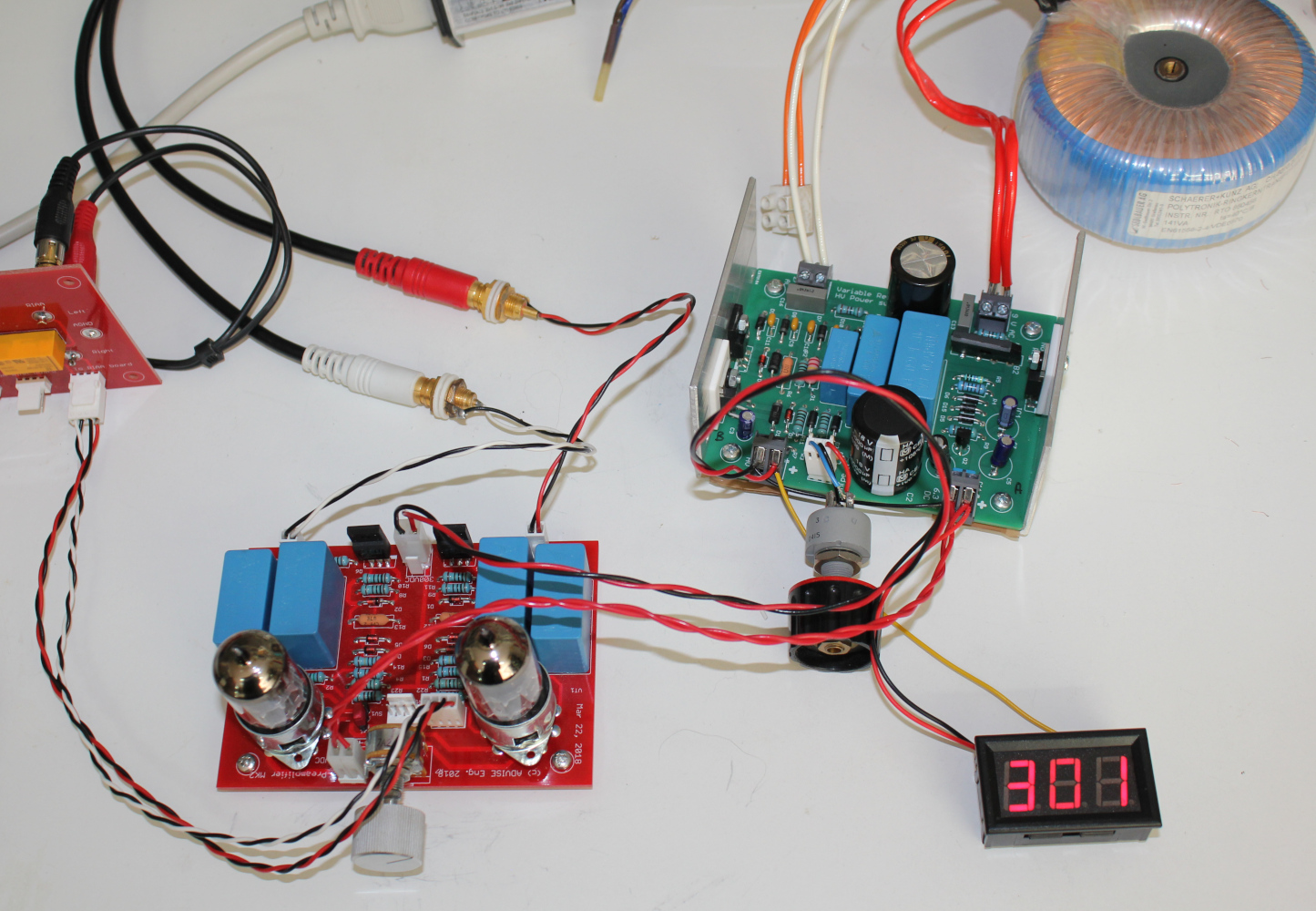

The purpose of this second design is to build one or more high voltage variable lab power supplies for vacuum tube board test like on the picture, this is the reason for the potentiometer, if I used a trimmer it will just be another version of your very nice 21st Century Maida Regulator 😀
The pot is isolated, the case will be fixed to a grounded front panel and I will use a plastic knob to avoid any risk of touching the high voltage... I also decided to use a leaded version of the LT3080 to fix it on the heatsink to take advantage of its thermal protection for the MOSFET like Pete Millett suggest it in his version of the Maida regulator : High Voltage Regulator
The terminal block I am using (not the ones on the picture which came from my junk box) are Phoenix contact rated at 400 V : https://www.mouser.fr/ProductDetail...=sGAEpiMZZMvPvGwLNS6718PaoTt7FM7ciW3NqkEQwDE= and this is enough in my project since I don't intend to use higher voltage (see the input electrolytic capacitors voltage...)
For the PCB layout, I would like to have greater isolation but this will be difficult with today components without making a much bigger board ! You know it also with your very compact SMD regulator board. I have made two layout for the EL34 Baby Huey and EL84 Baby Huey and more than 500 PCB have been ordered ( https://www.diyaudio.com/forums/group-buys/312869-gb-baby-huey-pcb-68.html#post5613136 ), and up to now there was never report of high voltage problem 😎

You don't need to grow the board to get greater clearance. You just need to get rid of the ground plane or replace it with a carefully designed pour.
